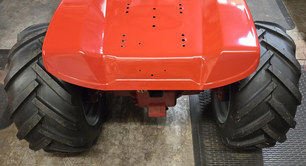

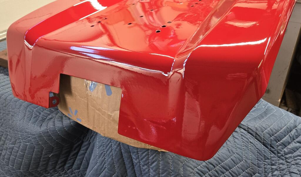

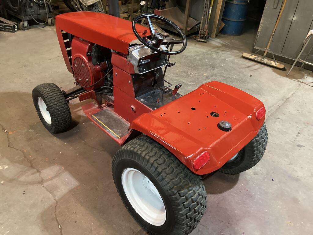

kpinnc 19,105 #76 Posted September 14, 2025 I decided the sheetmetal was gonna need to be stripped and repainted. But I haven't been able to make time for several weeks. Just for giggles, I decided to try Rustoleum mixed with hardener and a HLVP gun. I was surprised by how well it looked. The hood is gonna take some more work, but the fender turned out better. Time will tell, but so far so good. 2 6 Share this post Link to post Share on other sites
Lee1977 7,813 #77 Posted September 14, 2025 Using a gun with Rustoleum with Acetone and hardener is the way to go. I need to get the rest of the 308 sanded and ready to paint. Got the hood ready it had a few rusted spot under the original paint that needed to be fixed. 2 Share this post Link to post Share on other sites

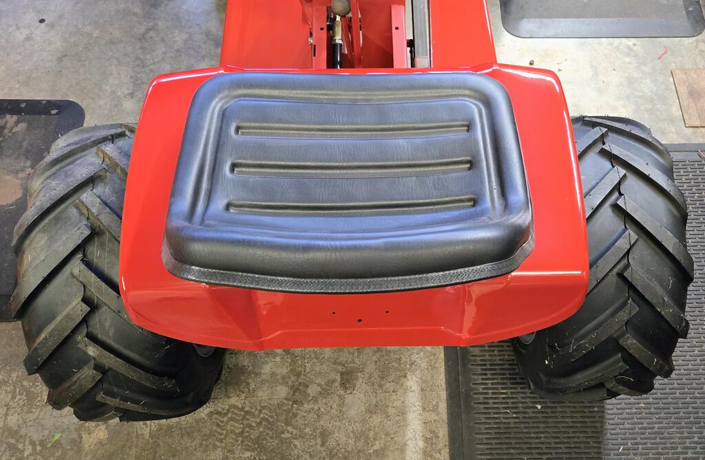

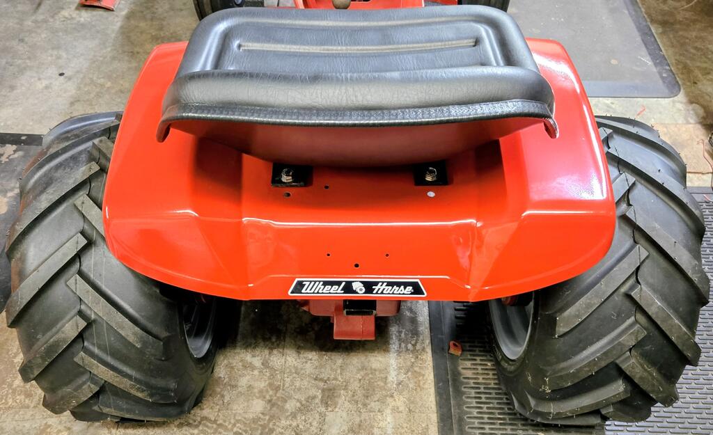

kpinnc 19,105 #78 Posted September 15, 2025 Mocked up the seat on the rear fender. Looks good so far. 4 2 Share this post Link to post Share on other sites

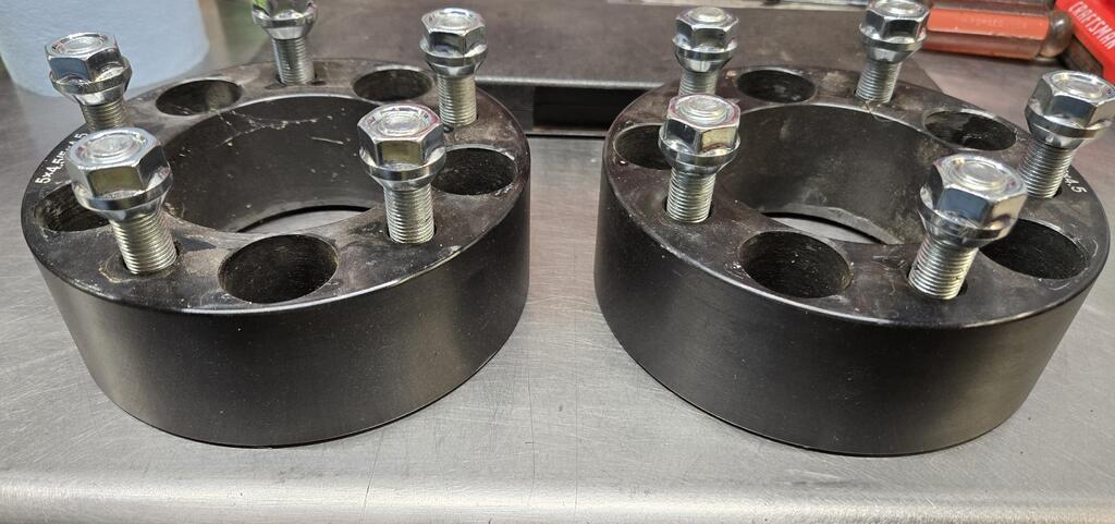

kpinnc 19,105 #81 Posted September 18, 2025 (edited) I do like wide tracks on these tractors, but this one will hopefully carry my 48SD deck on occasion. With that in mind, I decided to swap out the wide 2 inch spacers for 1 inch. I think on this tractor it looks better. The front and rear track is almost identical now, so that's a good thing. Before and after: 42 inches vs 40. Edited September 18, 2025 by kpinnc 4 Share this post Link to post Share on other sites

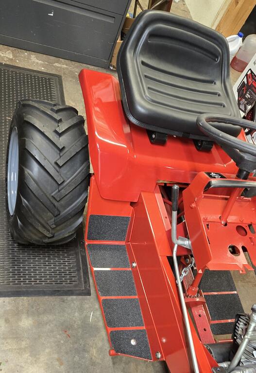

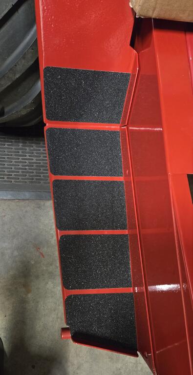

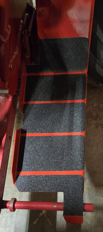

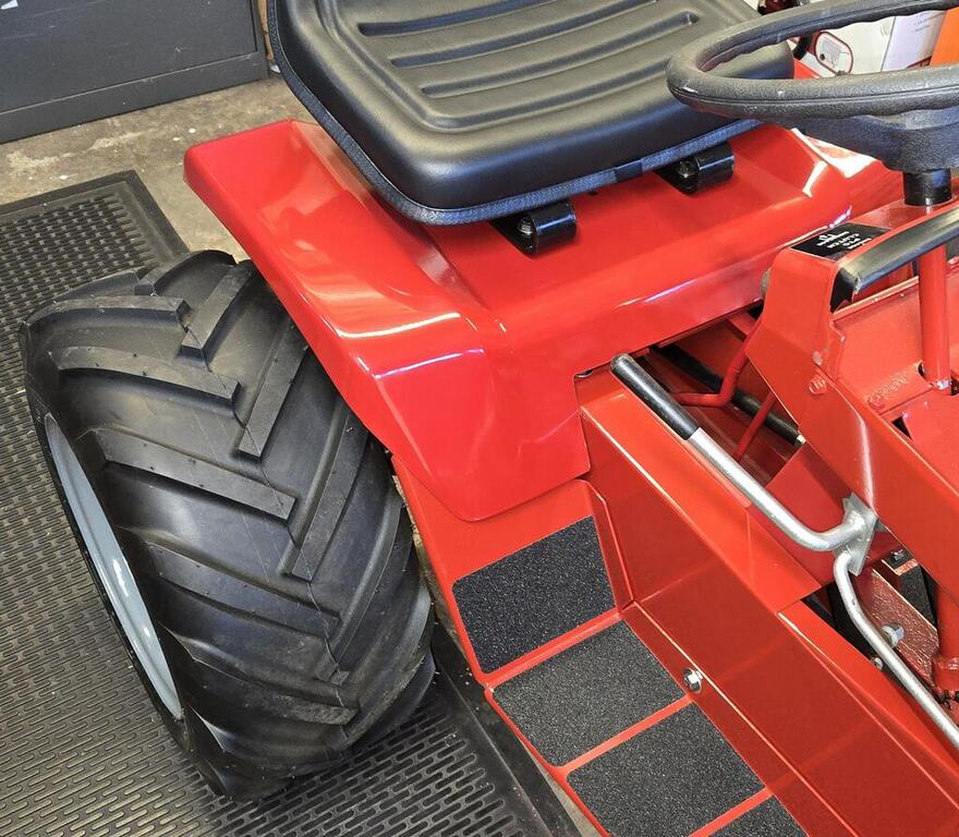

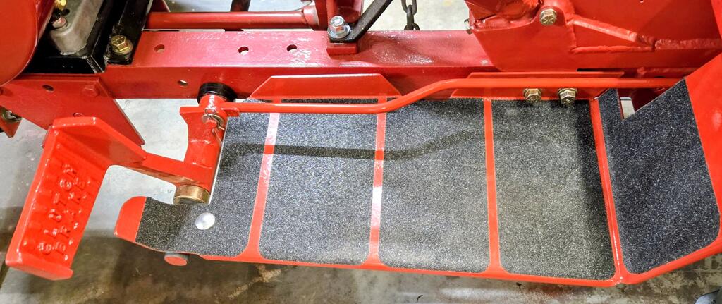

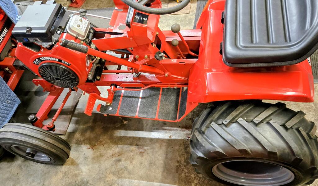

kpinnc 19,105 #82 Posted September 20, 2025 Got bored and couldn't sleep, so I stickered some grip tape on the footrests. Hopefully It'll hold up. 5 1 Share this post Link to post Share on other sites
ebinmaine 81,278 #83 Posted September 20, 2025 3 hours ago, kpinnc said: stickered some grip tape on the footrests. Hopefully It'll hold up. That'll do just fine. We've used similar on several. 1 Share this post Link to post Share on other sites
Handy Don 17,735 #84 Posted September 20, 2025 9 hours ago, kpinnc said: Got bored and couldn't sleep, so I stickered some grip tape on the footrests. Hopefully It'll hold up. As long as the paint was well cured, that’ll hold on nicely. 1 1 Share this post Link to post Share on other sites
kpinnc 19,105 #85 Posted September 21, 2025 8 hours ago, Handy Don said: As long as the paint was well cured, that’ll hold on nicely. Been a couple weeks since I sprayed them. We'll see... it's been hard to find time to tinker lately so the paint had plenty of time to cure. I'm a bit dissapointed in the Rust-Oleum paint that I mixed and added hardener. Honestly I think it takes longer to cure than rattle cans. I hope it cures to something harder than rattle can, but we'll see. I had to drill new holes in the seat springs. The bolt pattern was off by 1/2 inch on the width. Would've been easier if the difference was bigger. I'd rather fab an adapter plate than drill spring steel. But it worked.out and she's starting to look like a tractor. I'm gonna flip the pan pivot bar and set it down another inch. I'll have to trim the fender over the belt guard again, but it was easy on the previous cut. Stuck the first sticker on. Couldn't help myself. 2 4 Share this post Link to post Share on other sites

oliver2-44 11,847 #88 Posted September 21, 2025 1 hour ago, kpinnc said: I'm a bit dissapointed in the Rust-Oleum paint that I mixed and added hardener. Honestly I think it takes longer to cure than rattle cans. I hope it cures to something harder than rattle can, but we'll see. I’m curious what happened I’ve been very pleased with Rustoleum and Majic Hardener from TSC. I use lacquer thinner. I’ve spray with a conventional gun and now HVLP gun. When I spray in the morning I can handle it by evening and fingernail hard the next morning. I spray my self etching primer, aliow it to dry several day, sand with 320-400 then paint the rustoleum. 1 Share this post Link to post Share on other sites
kpinnc 19,105 #89 Posted September 21, 2025 (edited) 1 hour ago, oliver2-44 said: I’m curious what happened You and me both. HVLP gun, Krylon hardener, acetone reducer. 4-1-1 ratio. Rear fender turned out pretty good, but it's still not as hard as it should be after two weeks. The hood was my fault, because I sprayed too many coats and the undercoats never hardened. I scraped it all off with a putty knife a couple days ago. Hopefully the third try will produce a good result. I knew it wouldn't be as hard as automotive paint, but I really didn't want it to be. Three of my tractors are painted with Dupont Centauri and that stuff is so hard it chips with a big scratch. It's beautiful paint, but a big chip is difficult to repair. Sometime this week I hope to re-shoot the hood. Fingers crossed... Edited September 21, 2025 by kpinnc 3 Share this post Link to post Share on other sites

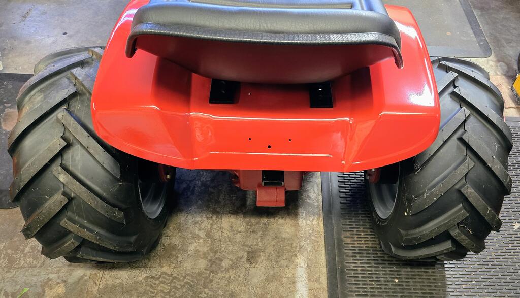

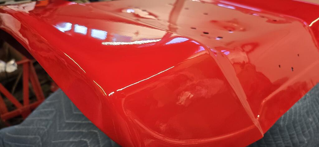

kpinnc 19,105 #91 Posted September 22, 2025 Flipped the fender pivot and cutout the fender and dropped it down more than an inch. Looks much better. Still strange how the same paint looks different. I guess the level of curing? Oh well, close enough. Before and after: 5 2 Share this post Link to post Share on other sites

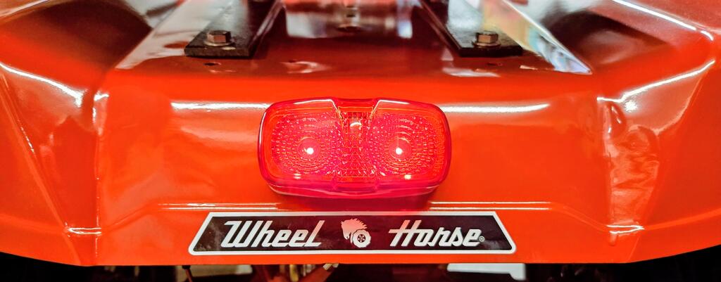

kpinnc 19,105 #92 Posted September 23, 2025 Only had a few minutes, so I stuck the tail light on and tested it. 5 Share this post Link to post Share on other sites

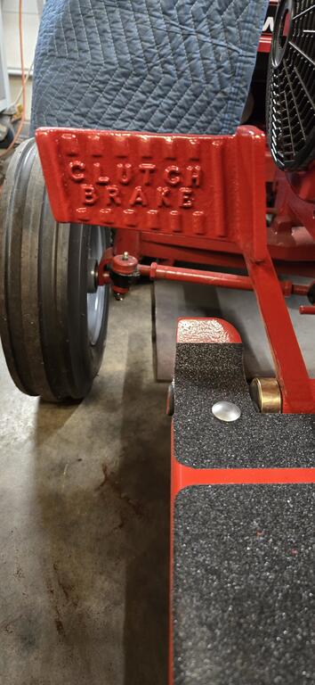

kpinnc 19,105 #93 Posted September 24, 2025 (edited) Clutch/ brake pedal and link installed. Of course my enforcement fabbing makes it where my clutch rod has to be mounted on the outside of the clutch arm instead of behind it. At least the left footrest is larger so it won't affect much. Edited September 24, 2025 by kpinnc 4 Share this post Link to post Share on other sites

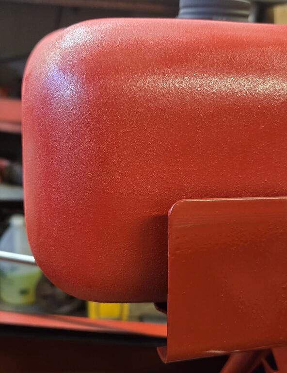

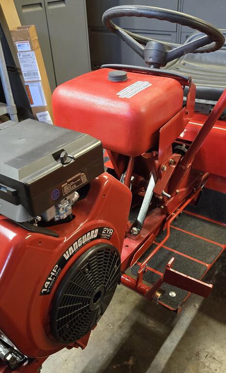

kpinnc 19,105 #94 Posted September 25, 2025 (edited) Under hood fuel tanks... I have yet to find one that wasn't really faded and/ or really nasty looking. So I did something silly: I took my little orbital sander and knocked all the grunge off this one, and put a light coat of red paint on it. At least it'll be the same color where it shows on the sides. I really wish I'd taken a before pic. It was multicolored and nasty. Looks much better now. Edited September 25, 2025 by kpinnc 7 3 Share this post Link to post Share on other sites
