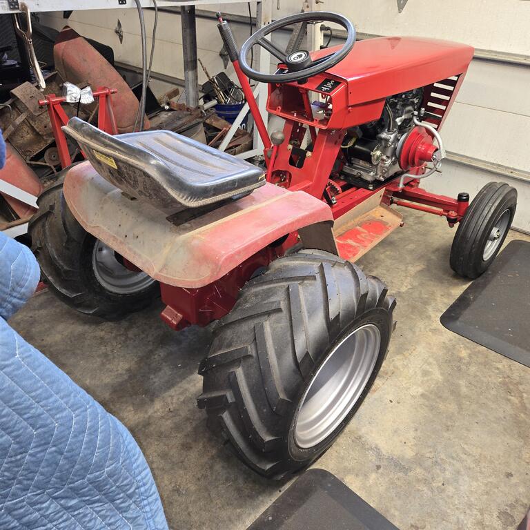

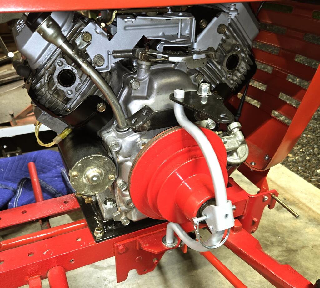

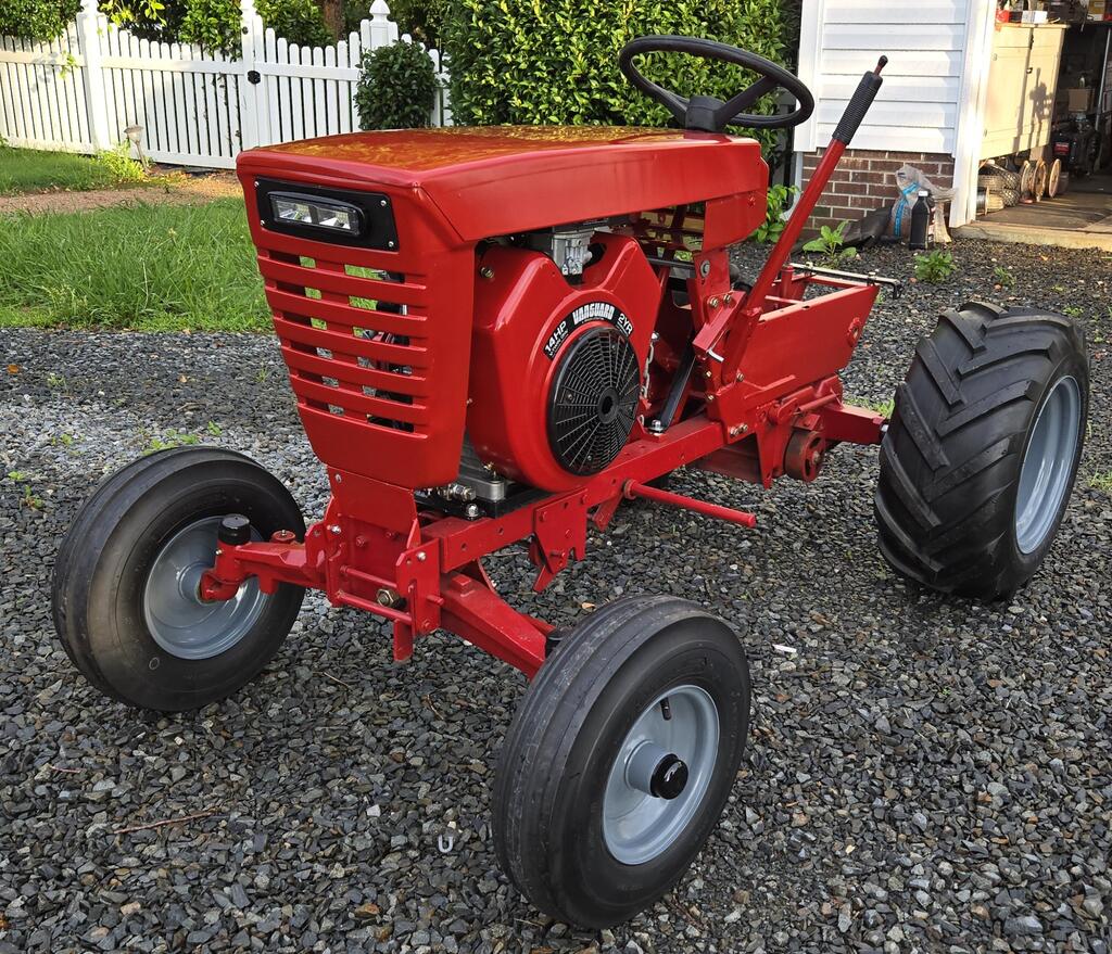

kpinnc 18,771 #54 Posted June 10, 2025 (edited) Not much done tonight. Got the PTO on. Still gotta install the linkages. Using the 4 inch drive pulley for an 8 speed, and the same size on the rear at the transmission. You have to modify the mounting of the engine but the side bosses align perfectly for a Wheel Horse PTO bracket. Edited June 10, 2025 by kpinnc 1 4 Share this post Link to post Share on other sites
ebinmaine 79,786 #55 Posted June 10, 2025 4 hours ago, kpinnc said: Using the 4 inch drive pulley for an 8 speed, and the same size on the rear at the transmission. 1:1 drive ehh?? Should be good for 10.5 to 11 MPH. 2 Share this post Link to post Share on other sites
ebinmaine 79,786 #56 Posted June 10, 2025 4 hours ago, kpinnc said: have to modify the mounting of the engine Meaning? Offset? Share this post Link to post Share on other sites
kpinnc 18,771 #57 Posted June 10, 2025 (edited) 4 hours ago, ebinmaine said: Meaning? Offset? Just meant that the bottom mounting bolt pattern and PTO height is different, but the side bolt pattern is like a Kohler. PTO bracket bolts right up. Edited June 10, 2025 by kpinnc 1 1 Share this post Link to post Share on other sites

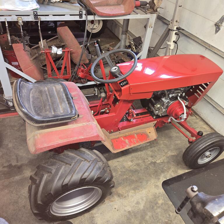

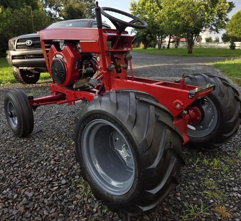

kpinnc 18,771 #58 Posted June 13, 2025 Been doing a little mock up. I have a couple rear fenders. I think I like the narrow rear fender better. Got too much going on for much of anything else until the end of next week. Maybe I can get these parts cleaned up by then. The first pic is the wide rear fender. Just for reference. 2 Share this post Link to post Share on other sites

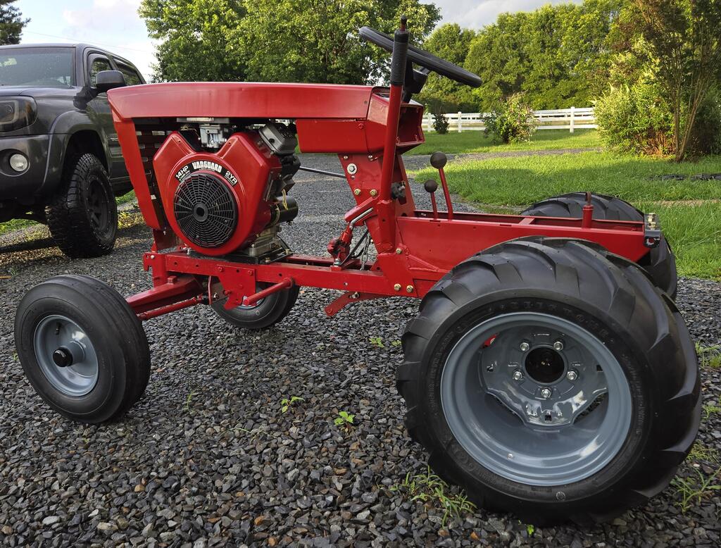

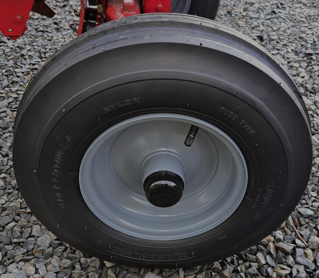

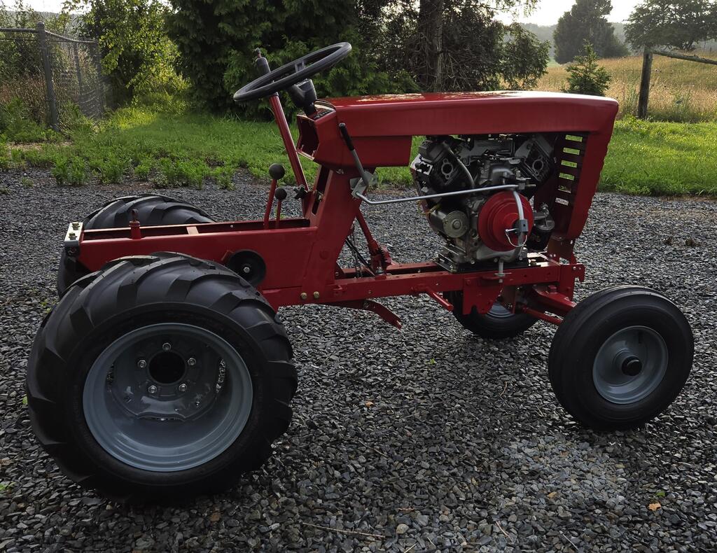

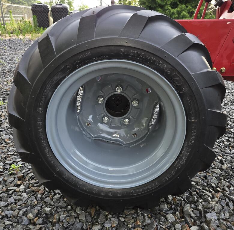

kpinnc 18,771 #59 Posted June 16, 2025 (edited) I don't think it will ever stop raining. My yard looks like an uncut interstate highway median... I am not complaining about the rain. Maybe just the intensity, duration, and number of times it's come in the past 10 days... Oh well, it gave me time to paint my wheels. I stole @Sparky Mike's wheel paint color and I like it! None of my wheel weights will fit the fronts, so I ran the valve stems on the outside. And for any who are curious, Rustoleum crystal clear works fine over Krylon. Sprayed it on immediately just as you would over Rustoleum. Edited June 16, 2025 by kpinnc 3 11 Share this post Link to post Share on other sites
Sparky-(Admin) 25,996 #60 Posted June 16, 2025 Wheels look fantastic! 3 1 Share this post Link to post Share on other sites
