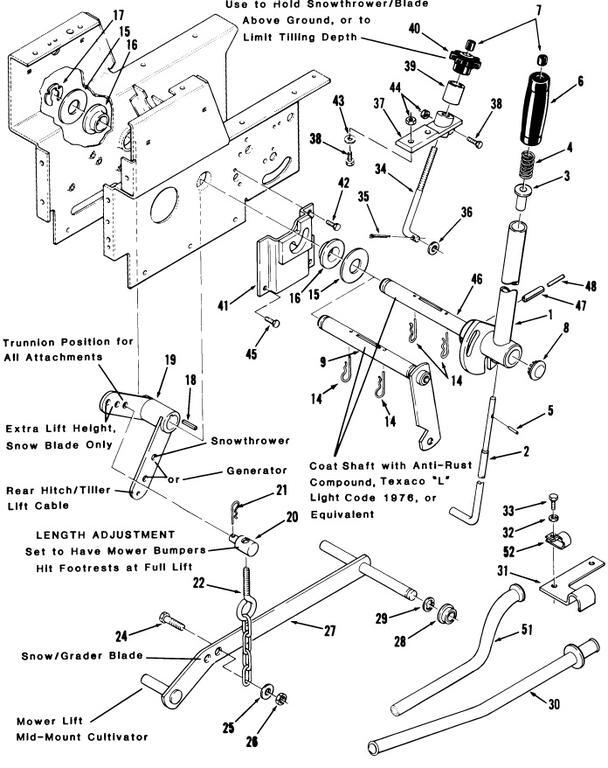

Jonboy 0 #1 Posted April 28, 2025 The lift arm broke at the base on my 310-8 and I welded it a couple years ago but it broke again. I tried rewelding it but I’m not good at welding and so I want to know the steps involved to get it off for replacement. Not sure where to start. Share this post Link to post Share on other sites

gwest_ca-(File Mod) 12,092 #3 Posted April 28, 2025 Never had one apart but the illustrated parts list may help. It looks like that handle and the shaft are 2 pieces retained by one roll (47) pin drove inside the other (48). I will guess the biggest struggle will be getting the shaft (46) out of the bellcrank (19). Better start applying a good penetrating oil to everything. https://www.partstree.com/models/21-10k805-310-8-toro-garden-tractor-1988/manual-lift-linkage-20/ 2 Share this post Link to post Share on other sites

953 nut 64,856 #5 Posted April 29, 2025 2 hours ago, gwest_ca said: the biggest struggle will be getting the shaft (46) out of the bellcrank (19). Unless your 310 has lived a pampered life inside a climate controlled building @gwest_ca has made the understatement of the year. The bell-crank will be brown-welded (rusted) to the shaft and will require repeated heating and applications of penetrating oil. If you can find all of the replacement parts needed to replace the entire assembly you may want to consider cutting the old parts out. With any luck A-Z Tractor may have the parts needed. Give Lincoln a call https://www.a-ztractor.com/ 1 Share this post Link to post Share on other sites
Lee1977 7,630 #6 Posted April 29, 2025 Getting part 19 off is like getting a rusted hitch pin out or worse. I hope it isn't rusted on. Share this post Link to post Share on other sites

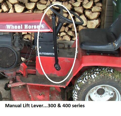

daveoman1966 3,882 #7 Posted April 29, 2025 Is this the lift arm you need? I parted out this 314-A tractor and MAY still have the lift arm apparatus. Share this post Link to post Share on other sites
