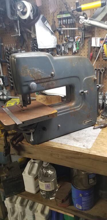

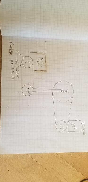

gt14rider 1,054 #1 Posted April 28, 2025 (edited) Good morning, bought a bandsaw at a flea market . Need to reduce speed, so it will cut metal, I was thinking of running a jack shaft. Need to figure out what pulleys to run. Is there a formula to figure out the speed of the pulley combinations I need to be around 100/120 rpm at the bandsaw, one problem is i can only run a 4 3/4" pulley at the bandsaw shaft, 5" would be real close to hitting. Motor turns 1725 rpm Any thoughts? Thanks Edited April 28, 2025 by gt14rider Share this post Link to post Share on other sites
gwest_ca-(File Mod) 12,015 #2 Posted April 28, 2025 Motor rpm x drive pulley diameter divided by the diameter of the driven pulley = rpm of the driven pulley. 2 1 Share this post Link to post Share on other sites

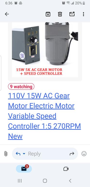

Ed Kennell 45,029 #3 Posted April 28, 2025 https://www.ebay.com/itm/356443921022?_skw=110v+electric+motor&itmmeta=01JSYM21Z7H1CX2E6MA33K85HM&hash=item52fdb69a7e:g:4qQAAOSw88xgEczl&itmprp=enc%3AAQAKAAAA8FkggFvd1GGDu0w3yXCmi1fepdUCdOCT7Q7l2OSrvZxOE53jT8V9DWTlZar%2BpX4XnOHTI7p1h39kD28uTUwuwL0nBDsE%2F31QoFac%2B%2FPP0KqOZIg1ikuk4NUTTkVfU92u7iy%2FOppAwO6I%2FXLSGbVmvVgccJlgiGGjtuwaErSzdfKxdkV2QKvGcrm0URfs%2Bo4RH9wxqEp78%2F6MCfT%2FmYuYP9G3o1Du1J2ARl%2BN%2FGZLlsYhntdCvO1lWXV45P1DbsQzcs5VWYGXsws0yLprTwftm8%2Fhxoe1zm%2FXM%2BZOjVOMTGhnw3aKGaIZnBN51y%2FMyr7DYQ%3D%3D|tkp%3ABk9SR_afiNTPZQ 3 1 Share this post Link to post Share on other sites

Ed Kennell 45,029 #10 Posted April 29, 2025 11 minutes ago, gt14rider said: Will it run the saw? Not if the saw needs 1/3 HP. I did not size the motor, just wanted to show variable rpm motors are available. A jack shaft with several different diameter pulleys drill press style may also be a good option. Share this post Link to post Share on other sites
lynnmor 8,644 #11 Posted April 29, 2025 For reference this motor is 1/3 HP and draws 690 watts. There are other motors similar to Ed's link that are more powerful but much higher cost. Like Ed says, you may not need the entire 1/3 HP, the current draw will be in relation to the load. Share this post Link to post Share on other sites
wallfish 19,379 #12 Posted April 29, 2025 The motors in that link have a gear reduction built in. That adds to the output torque vs using just a straight shaft motor without one. Share this post Link to post Share on other sites
gt14rider 1,054 #13 Posted April 30, 2025 Thank you all, I did like the gear reduction motor, but I think I'll stick with pulleys and jack shaft. Used the formula Gwest posted and I figured out what pulleys to use, now just need some bearings and 5/8 shaft and have an old 1/3 hp motor have to dust it off it's been sitting for a while. I'll post some pic when I do. 1 1 Share this post Link to post Share on other sites
