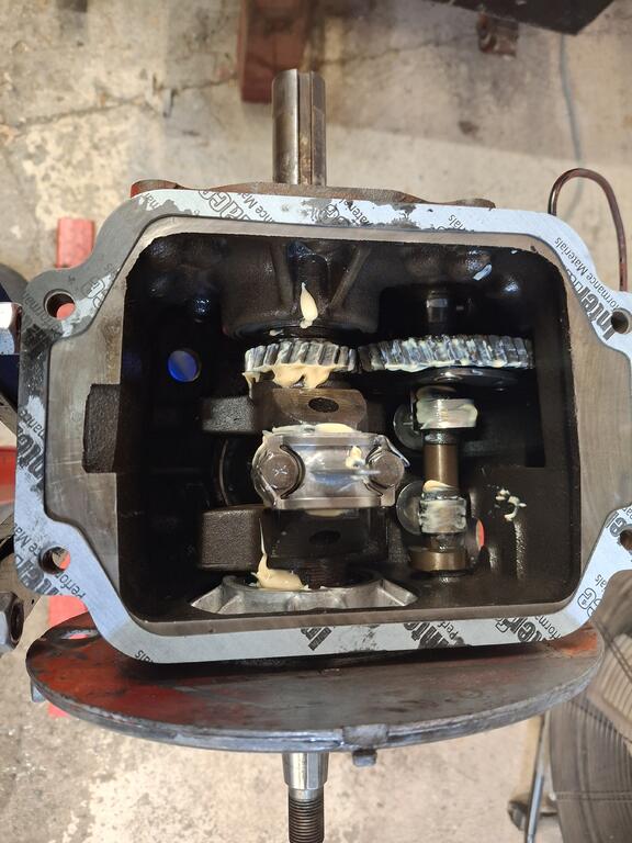

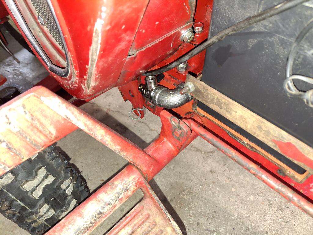

squonk 47,419 #1 Posted April 26, 2025 (edited) As some of you know. I've been messing with a couple of k181's. The 48 yr. old engine in HHHOOOWWWAARRRDDD!!! ran like a watch but it STUNK!!! Every time I used it I had to change clothes and shower right after. I've torn it down for new rings and valves and will have a thread on that later BUT: I had rebuilt an engine from my 875 to put into Howie. I really hate how the oil drain tube is blocked by the brake clutch pedal. I thought why not run it out the front. there's plenty of room. Just turn the pan around. So I did and installed an EZ oil drain valve. Ran the engine on my stand. Everything was fine. It sat for a few days and when I removed the engine there was like a half teaspoon of fresh oil on the frame along the flywheel side. Where did that come from? Took of the flywheel again and the seal is fine. Cleaned everything and the next day, there's the oil again. and again and again. Really couldn't see exactly the spot that was leaking but decided it had to be the pan gasket so the pan came back off I should have taken pictures then but I didn't so on this original engine I did: Notice how the oil pan gasket fits in this picture along the flywheel side. The gasket barely is on the block surface. The gasket only goes on one way. It looks the same either way but it's not. Now here is the gasket flipped. You also have to put the pan on the same way or the gasket won't lie correctly on the pan rail. I ended up putting a new drain nipple, a 90° elbow and the EZ drain pointing towards the front . Edited April 26, 2025 by squonk 7 3 Share this post Link to post Share on other sites
