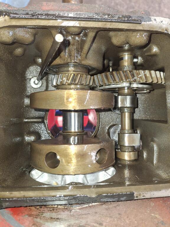

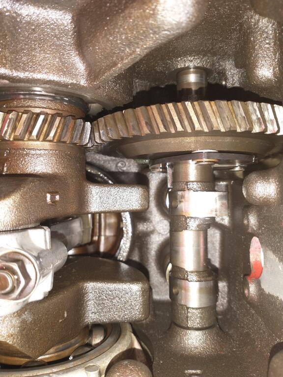

squonk 48,207 #4 Posted April 25, 2025 Use Rotella and forget about it. This is the inside of a 48 yr. old K181. I've owned it about 5 years or so. Use Rotella 30W all year round. This is the inside of a K341 with over 1000 hrs. I bought it at 700 hrs. and the oil inside was black as coal and it smoked. Same thing I used Rotella 30W year round. Finally had a broken piston skirt. it was still running when I replaced it and tore it down. 2 Share this post Link to post Share on other sites
