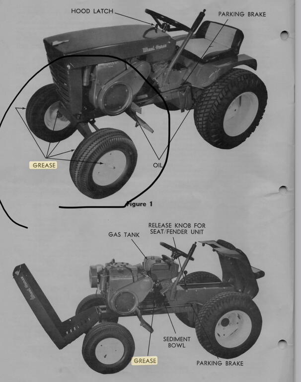

FLtractor 253 #1 Posted April 24, 2025 Afternoon, Looking at the manual online.. it states where the grease zerk fittings are located … I read somewhere online before I knew the manuals were so easily available.. about raising the front of tractor to properly fill the front axle zirk fittings.. does this apply to my 1966 Wheelhorse 856? Is there a grease fitting directly Beneath this axel on front that needs to be greased to? 1 Share this post Link to post Share on other sites

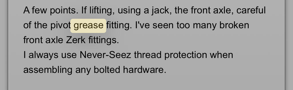

ri702bill 13,394 #2 Posted April 24, 2025 (edited) Yes, the front axle has 3 grease fittings - the center pivot and the two spindles. Lifting the wheels off the ground allows you to fill the internal voids with grease that can migrate up and down. Careful not tosnap the pivot fitting off !! Do not forget the one fitting in the lower steering block too.... Make SURE the seatpan latch works properly and stays latched. There are RS stories about the unsuspecting getting pitched off the back letting out the clutch.....There is a reason they don't make 'em like that anymore...... Edited April 24, 2025 by ri702bill 1 Share this post Link to post Share on other sites
lynnmor 9,081 #3 Posted April 24, 2025 You should raise the tractor front by jacking the frame, jacking under the axle would still cause loading the weight on the center pivot. You can’t grease the front axle too much, it is the only way to flush the dirt and water out of these unsealed joints. 3 Share this post Link to post Share on other sites
