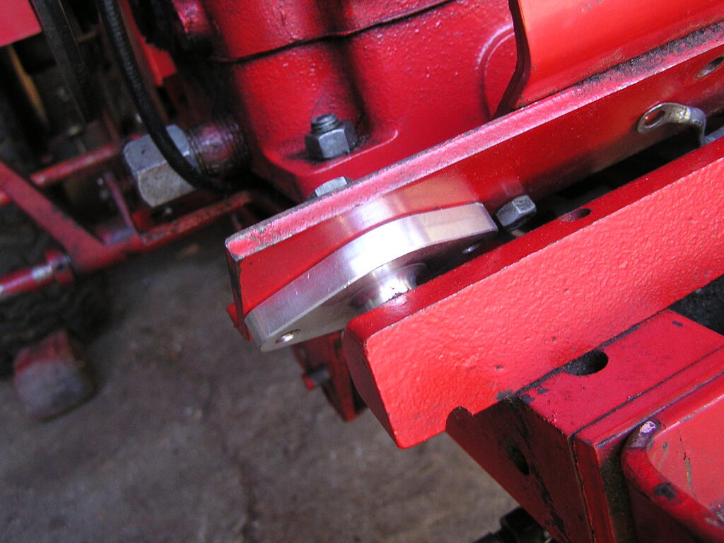

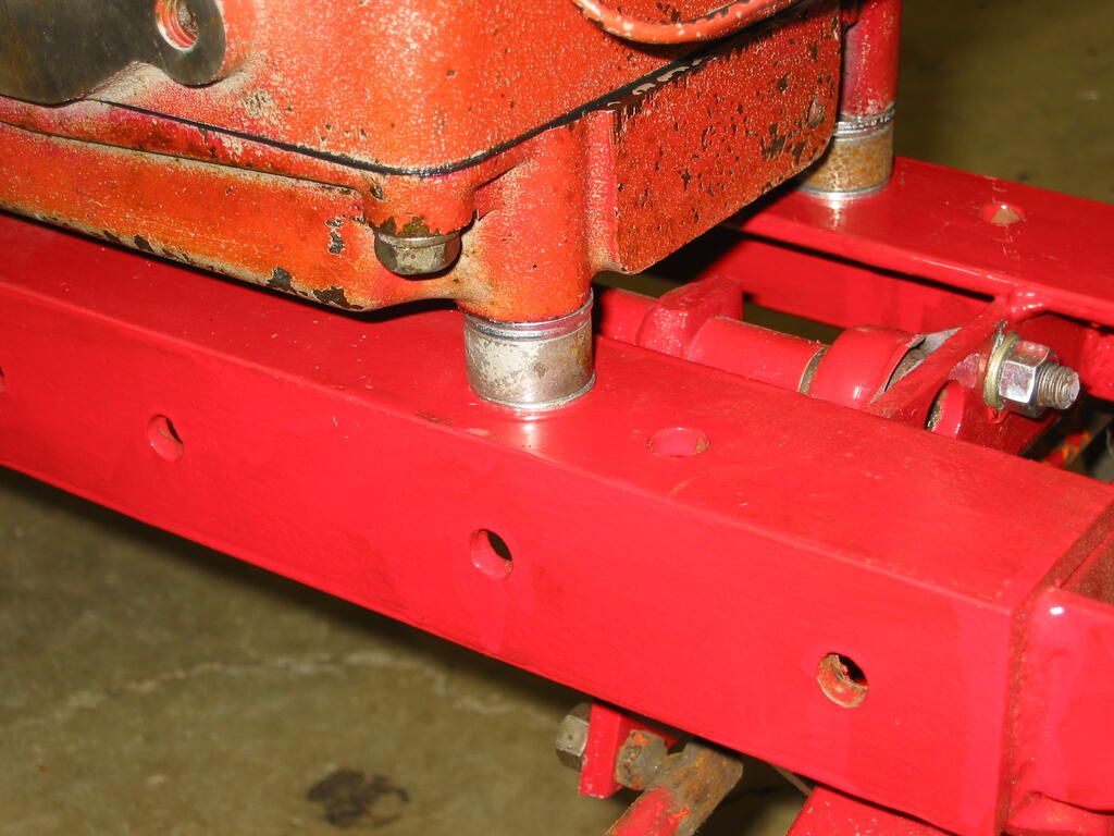

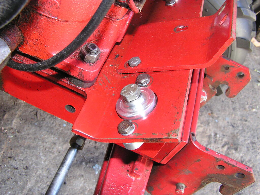

pfrederi 21,215 #6 Posted April 24, 2025 Or get a couple spacers and mount the engine direct to the frame... You may have to drill a new hole.. I didn't on this one. 3 Share this post Link to post Share on other sites
