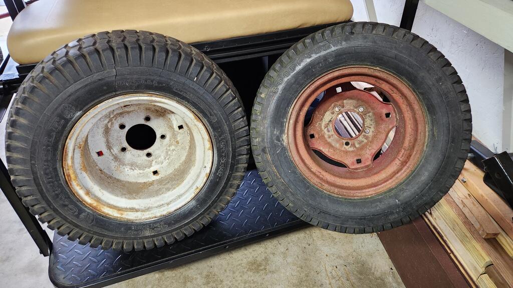

Racinbob 13,193 #15 Posted April 23, 2025 Are you willing to clean and repaint? I have two sets of 7.5" with the 1 1/4" offset and 7/16" lug holes. The left have 23-8.50's that would need tubes. The right have 23-10.50's that are shot. All are solid rims that would clean up nicely. 1 Share this post Link to post Share on other sites
