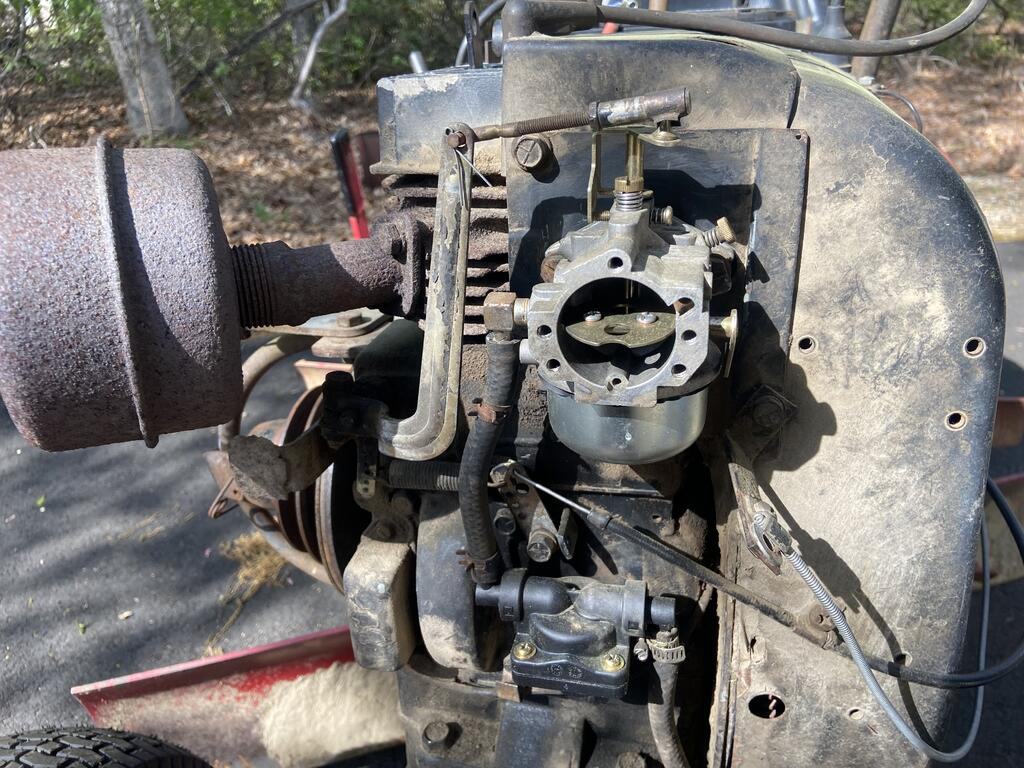

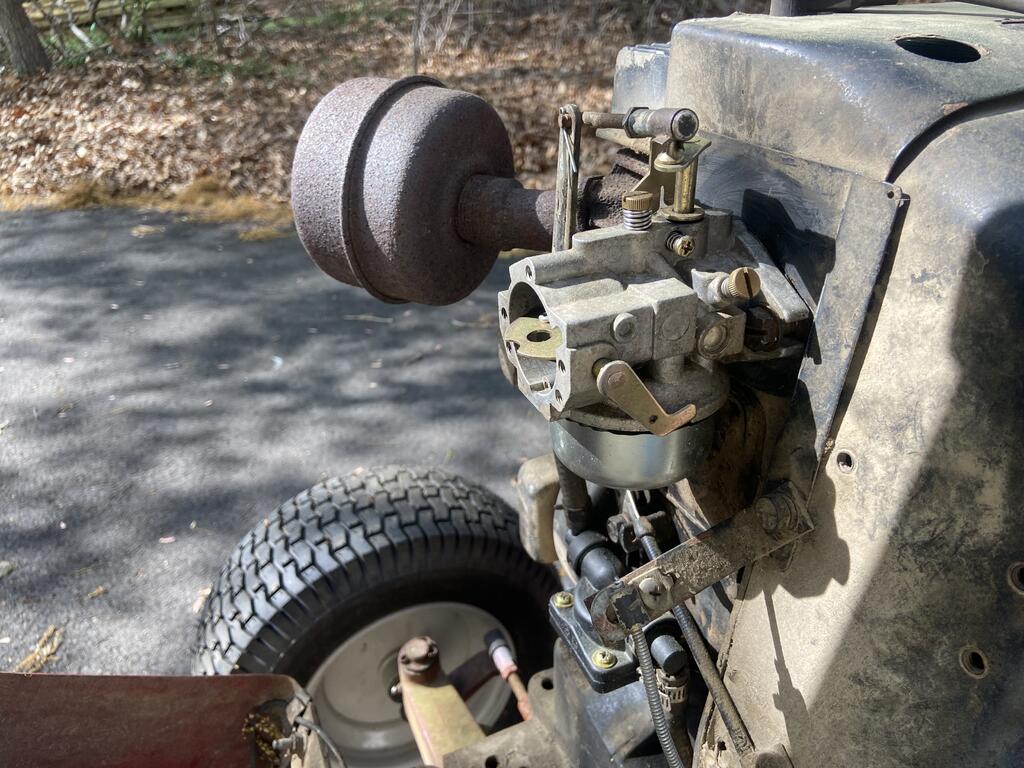

stvski80085 279 #16 Posted April 25, 2025 Post a close up pic of the Carb. Steve Share this post Link to post Share on other sites
clueless 3,348 #17 Posted April 25, 2025 When you cleaned the carb what all did you do? There is cleaning and then there is real cleaning. 1 Share this post Link to post Share on other sites
peter lena 9,763 #18 Posted April 25, 2025 @JGuen after dropping carb bowl , on any recently acquired engine / tractor , like to run it in on a separate gallon of heavily treated fresh gas , have a regular step by step , to wake it up , oil change , etc , typically do things that are not in the book , but quickly cleans up a varnished smoking engine , just me , pete Share this post Link to post Share on other sites
WHX?? 54,958 #19 Posted April 25, 2025 Carefully drop the bowl and see if you can catch the float hanging up. Rebuild kits can be had anywhere. Google the part number. Use only Kohler kits for proper needle/seat. Looks to be a standard Carter. Those can be had anywhere from $$ OEM to cheap offshore ones. Not much can go wrong with a carb that can't be fixed unless it's severely corroded. Check the throttle bushing for excess slop. 1 Share this post Link to post Share on other sites

JGuen 2 #22 Posted April 29, 2025 Just a few close ups of the carb. Throttle bushing does not have much slack/play. During my cleaning I removed both needles bowl, cleaned and checked float as well as little gas stopper needle. Took the needles and cleaned the small holes out they were pretty see through to start. Above the bowl was a screw the main needle contacts I could not removed this as it was previously stripped. My next course is to give it another good clean, soak the whole carb and look for a rebuild kit. Share this post Link to post Share on other sites
