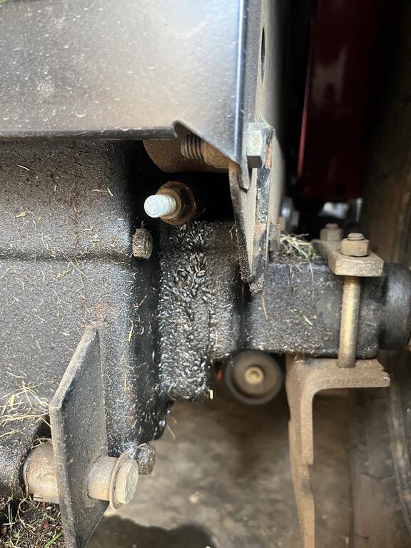

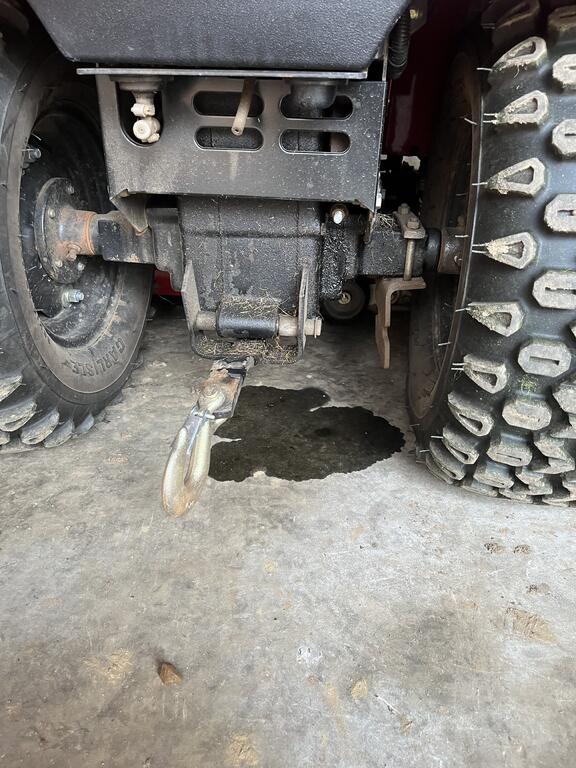

stevebo-(Moderator) 8,741 #1 Posted April 18, 2025 All- Brake shaft seal in my 5DXI sprung a leak. Has anyone done this replacement? If so, can I get to the seal by just removing the right side wheel/tire or do I need to drop the trans? Share this post Link to post Share on other sites

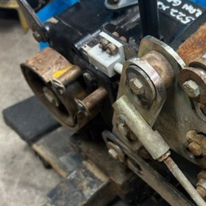

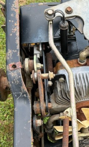

JoeM 10,099 #3 Posted April 19, 2025 Out of all the xi machines I have, that is a new one. I believe the trans will have to come out. Axle seals are common, just wonder what caused the failure? If it is just the seal for that crew you have just one afternoon. When removing trans, bite the bullet and unhook everything, should slide out of the frame. Top View Share this post Link to post Share on other sites
