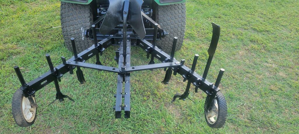

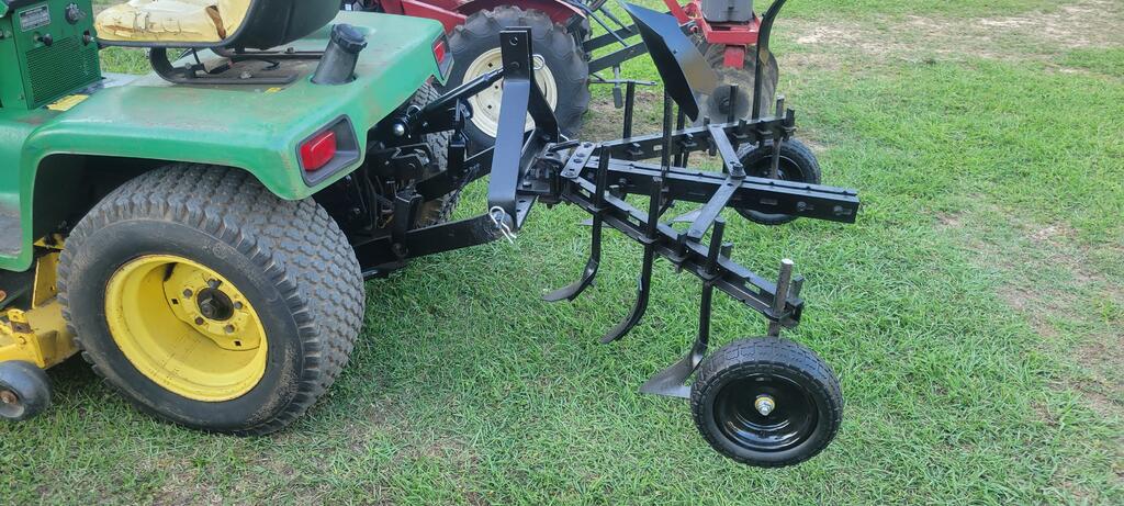

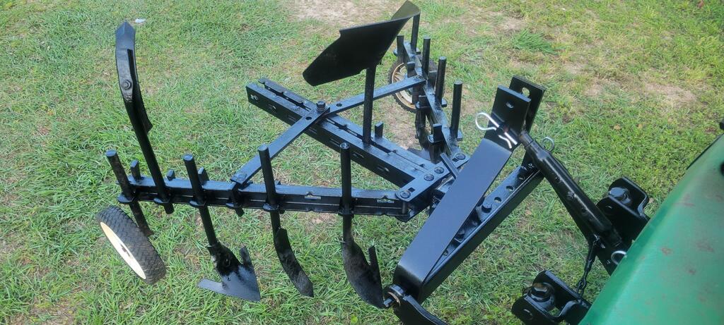

RED-Z06 2,720 #1 Posted April 14, 2025 Its old, it came with a deere 318 that was going to scrap; it got washed and painted...the wheels obviously arent right, does anyone know what wheel should be on it? 2 Share this post Link to post Share on other sites
Handy Don 17,735 #2 Posted April 14, 2025 5 minutes ago, RED-Z06 said: Very nice. The adaptability will come in handy if you are doing various kinds of plantings, with the extra tines, the wheels that can be repositioned, the adjustable width, and the hiller blade. 1 Share this post Link to post Share on other sites

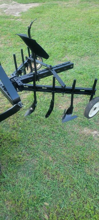

RED-Z06 2,720 #3 Posted April 14, 2025 2 minutes ago, Handy Don said: Very nice. The adaptability will come in handy if you are doing various kinds of plantings, with the extra tines, the wheels that can be repositioned, the adjustable width, and the hiller blade. Whats neat is theres no bolts for any of the drops/tines...its all done with wedges 3 Share this post Link to post Share on other sites
kpinnc 19,107 #4 Posted April 14, 2025 I don't think it matter what wheels you use so long as they are the same. The Brinly cultivator is one of the best implements. Very useful! 2 Share this post Link to post Share on other sites
JimSraj 593 #5 Posted April 14, 2025 Just saw one of these locally on MP for $145 1 Share this post Link to post Share on other sites
Achto 32,963 #6 Posted April 14, 2025 I have 2 of these older Brinly cultivators. I use the crap out of them. Keep a hammer with you when you use it, the wedges tend to loosen from time to time. 4 Share this post Link to post Share on other sites

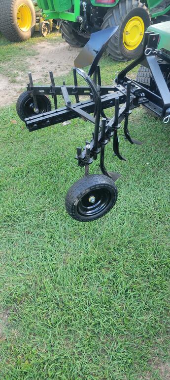

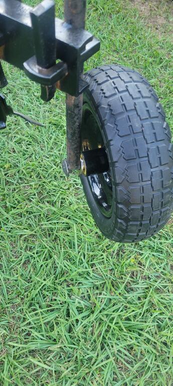

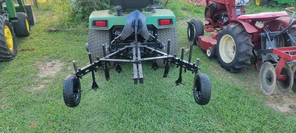

RED-Z06 2,720 #7 Posted April 16, 2025 Went with solid 10" utility tires, 5/8 bearings, i had planned to use some 5/8 to 1/2 sleeves to make them fit but it became apparent that the factory axles had been modified and were way shorter than they should have been. So, i took some 5" 1/2 carriage bolts, cut off thr old pins, welded on the carriage bolts, measured my sleeves out so they were just a hair longer than the bearing spread, tacked them to the carriage bolts, slid the wheels on and cranked down some serrated flange nuts. 3 Share this post Link to post Share on other sites
