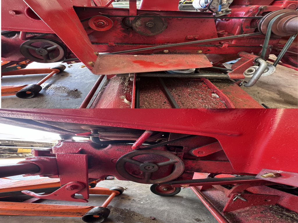

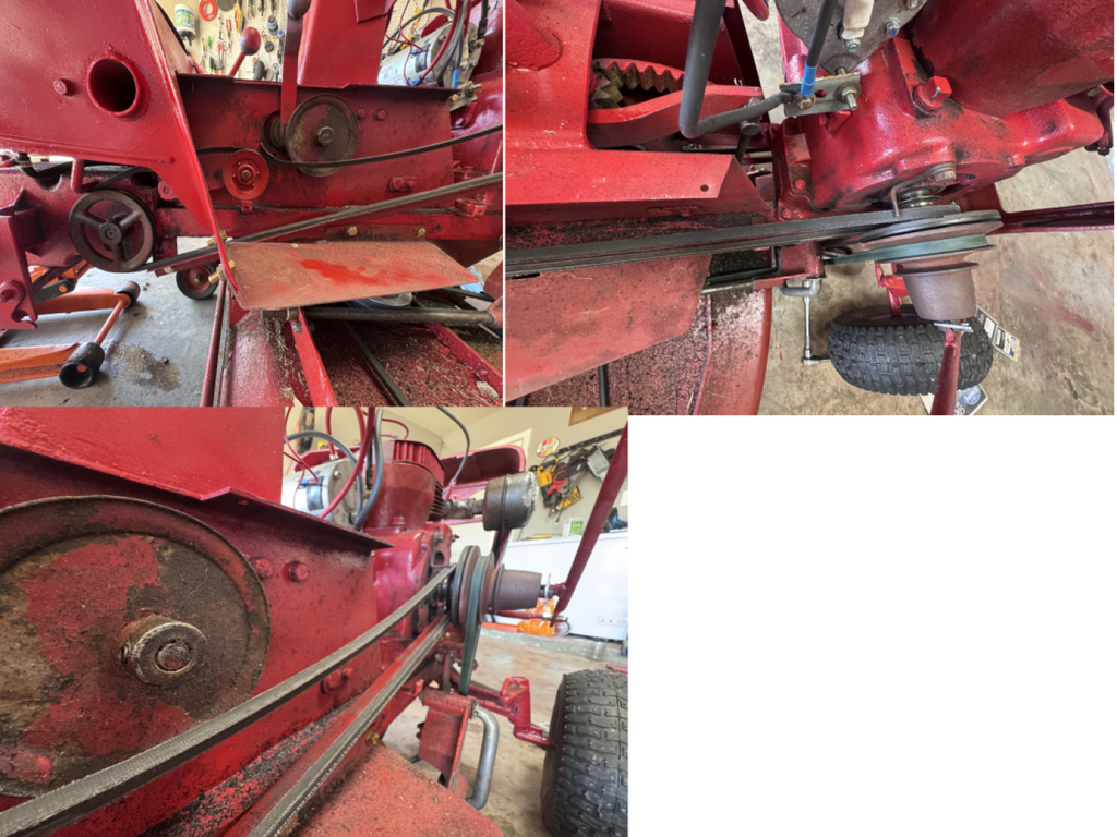

aaronthomas57 27 #1 Posted April 12, 2025 Hello everyone, I've dug through the posts, and followed the guides. I've got enough purple links on google to make Grimace jealous, but can not seem to get my tractor to actually stop the rear pulley so I can shift properly. I'm not sure if I'm missing some adjustment somewhere or not. The drive belt is factory spec. I've adjusted all of the guard points by the book. (Typically 1/16-1/32). I've attached two sets of images, one with the belt slack (clutch all the way pedal down) and one with it taught (clutch all the way up) I'm at a loss, and hoping the wheel horse wizards can point me in the right direction or call me out for missing something obvious. Thank you in advance Share this post Link to post Share on other sites
ri702bill 13,394 #2 Posted April 12, 2025 Are you running it without the belt guard?? It is part of the system that helps stop the belt.... Share this post Link to post Share on other sites

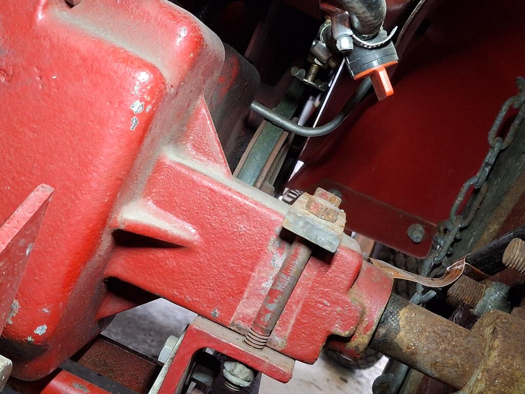

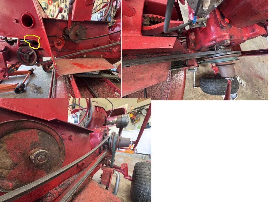

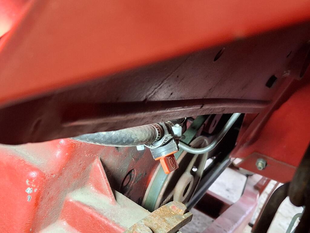

squonk 48,427 #3 Posted April 12, 2025 I had the same issue on my 953. I fashioned a rear belt guide out of a piece of brake line and fastened it to the fender. It's in the yellow circled area in your picture. Here is the guide. You can see the bolt in the fender that holds it in place. 2 Share this post Link to post Share on other sites

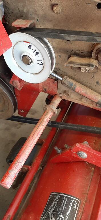

Ed Kennell 47,946 #4 Posted April 12, 2025 You could also add a belt brake tab. It works without belt guides and belt guard. 1 5 Share this post Link to post Share on other sites
aaronthomas57 27 #5 Posted April 12, 2025 Thank you all for the suggestions! Great Idea Ed!! I'll fab something up and make it happen! 1 Share this post Link to post Share on other sites
GlenW 60 #6 Posted April 17, 2025 On 4/12/2025 at 6:02 PM, Ed Kennell said: You could also add a belt brake tab. It works without belt guides and belt guard. I like this, I’m going to have to see what I can come up with identical to this on a project horse that the drive belt doesn’t want to brake when clutch is pressed in. 1 Share this post Link to post Share on other sites

John c 224 #8 Posted April 26, 2025 (edited) My 1995 314-8 came stock with the belt brake pieces shown in Ed's video Edited April 26, 2025 by John c add photo 1 Share this post Link to post Share on other sites
GlenW 60 #9 Posted April 26, 2025 I ended up bending down the belt guide on my Raider 12 enough that it catches the belt when I press on the brake/clutch. 1 Share this post Link to post Share on other sites
