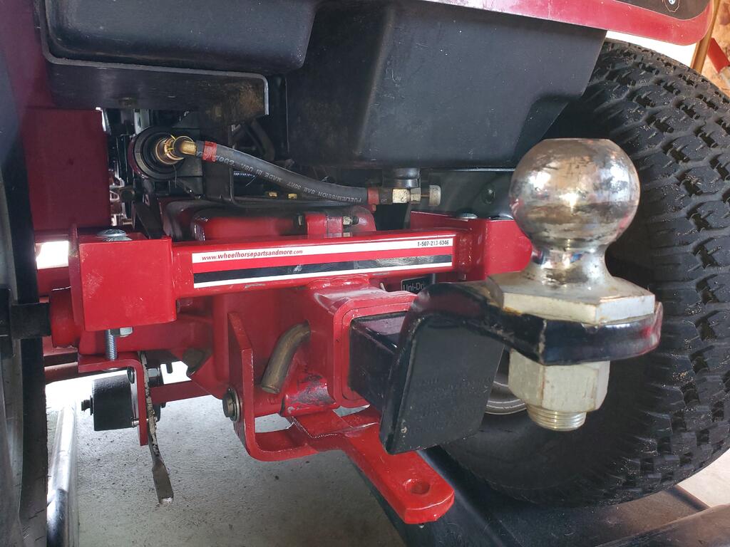

Wayne0 1,666 #1 Posted April 11, 2025 I'm thinking on pulling the trigger on the Wheel horse parts and more receiver hitch. I have the plow bracket. Do I need to remove the old clevis hitch (pin is frozen) or does it just bolt to the top of the plow bracket? Share this post Link to post Share on other sites
953 nut 70,654 #2 Posted April 11, 2025 Give Lowell a call and ask. https://wheelhorsepartsandmore.com/shop-now/ Share this post Link to post Share on other sites
Wayne0 1,666 #3 Posted April 11, 2025 I know a few of you guys have them, so first hand knowledge is the best IMO. It looks like it uses the bottom of the plow bracket and replaces the top plow bracket angle iron. Share this post Link to post Share on other sites

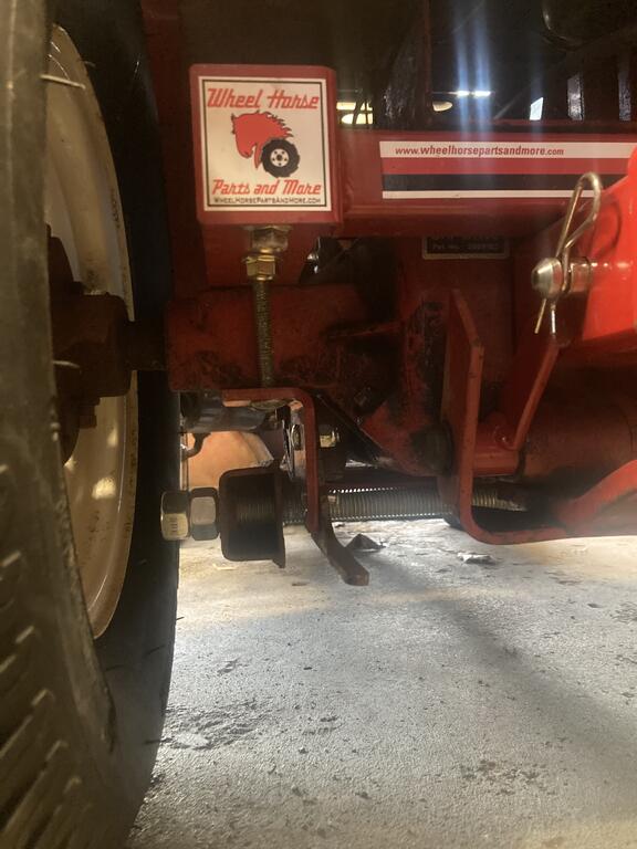

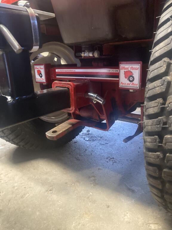

SylvanLakeWH 32,921 #4 Posted April 11, 2025 (edited) It does need the pin, but it also works with the plow bracket...Clevis I don't know... Edited April 11, 2025 by SylvanLakeWH Pics 3 Share this post Link to post Share on other sites
Wayne0 1,666 #5 Posted April 11, 2025 So I gotta get the pin out. 1 2 Share this post Link to post Share on other sites
SylvanLakeWH 32,921 #6 Posted April 12, 2025 Yup... 1 Share this post Link to post Share on other sites

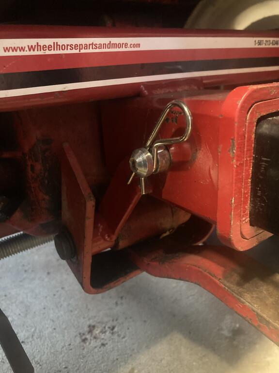

ebinmaine 81,282 #7 Posted April 12, 2025 9 minutes ago, Wayne0 said: So I gotta get the pin out. It's not as tough as it seems. Punch a hole in the end as close to center as possible. Multiple drills starting with 1/8" Go as near to the 3/4" diameter as you can (or dare). Stick a long round punch in that hole and drive it through. Share this post Link to post Share on other sites
Wayne0 1,666 #8 Posted April 12, 2025 Guess I'll pull it in the shop, pull a wheel and see if I can "persuade" it out. My 520's pin just slid out slicker than goose poop. This is going on the Work Horse. 1 Share this post Link to post Share on other sites
SylvanLakeWH 32,921 #9 Posted April 12, 2025 And when it goes back in, grease the crap out if it... 2 1 Share this post Link to post Share on other sites
mrc 1,122 #10 Posted April 12, 2025 i use my ball joint press tool to remove stubborn pins. works well! 1 1 Share this post Link to post Share on other sites

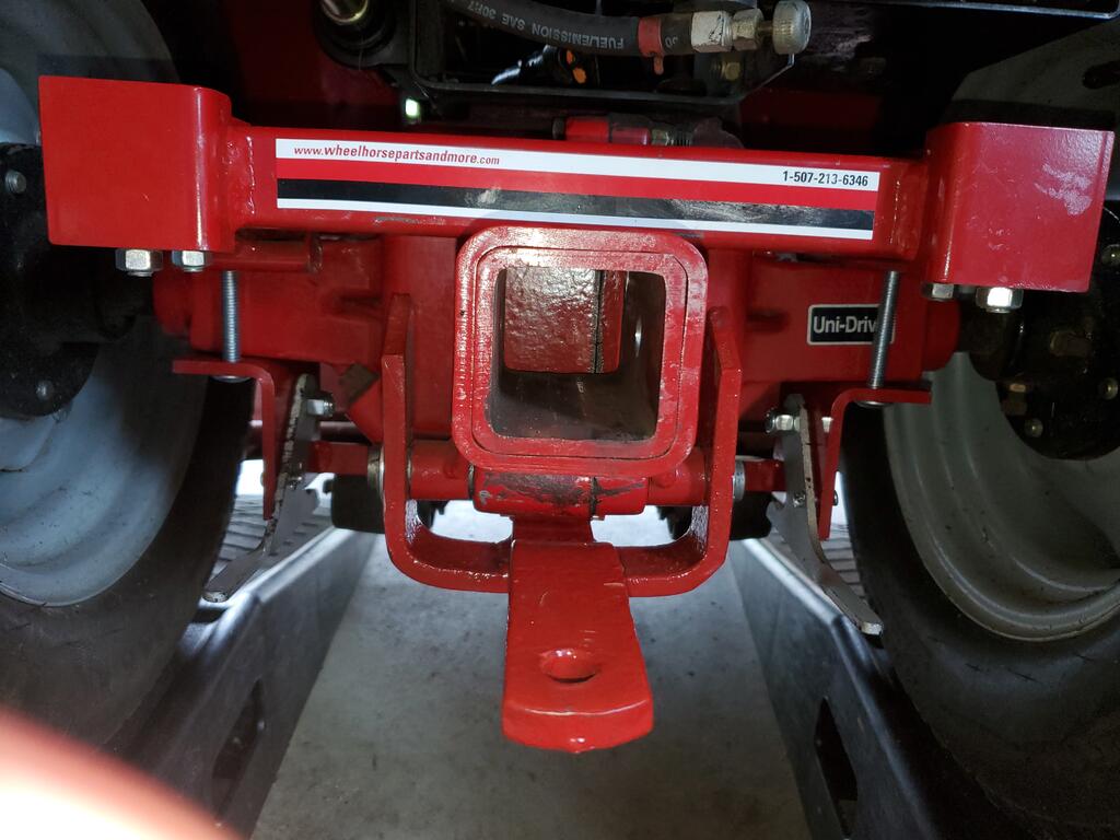

Racinbob 13,290 #11 Posted April 12, 2025 Notice that he sells them with and without the mounting hardware. Folks that have a plow bracket don't need the extra carriage bolts and plates. I have two of them. Both using the plow bracket. You can use the drawbar hitch but not the slot or clevis hitches. 4 1 Share this post Link to post Share on other sites
Wayne0 1,666 #12 Posted April 12, 2025 5 hours ago, mrc said: i use my ball joint press tool to remove stubborn pins. works well! I'll look in my "collection" of presses and pullers and see if one will work. Share this post Link to post Share on other sites
Ed Kennell 47,946 #13 Posted April 12, 2025 (edited) 20 hours ago, ebinmaine said: It's not as tough as it seems. Punch a hole in the end as close to center as possible. Multiple drills starting with 1/8" Go as near to the 3/4" diameter as you can (or dare). Stick a long round punch in that hole and drive it through. I have removed several this way. Please pull the right wheel and drive toward the strong side of the tranny lug. To make it easier, I have also cut thru the pin on both sides of the tranny lug and removed the drawbar hitch. Also drilled 1/4" holes in the top of each lug and soaked the pin with Kroil. Then after the pin is out, tapped the holes for a zerk. Edited April 12, 2025 by Ed Kennell 3 Share this post Link to post Share on other sites
Handy Don 17,735 #14 Posted April 12, 2025 7 hours ago, Wayne0 said: I'll look in my "collection" of presses and pullers and see if one will work. I was able to use a three-jaw gear puller on one. It required some very careful positioning, a hole drilled into the end of the pin to keep it centered, and would only work from one side but, hey, the pin came out! Share this post Link to post Share on other sites

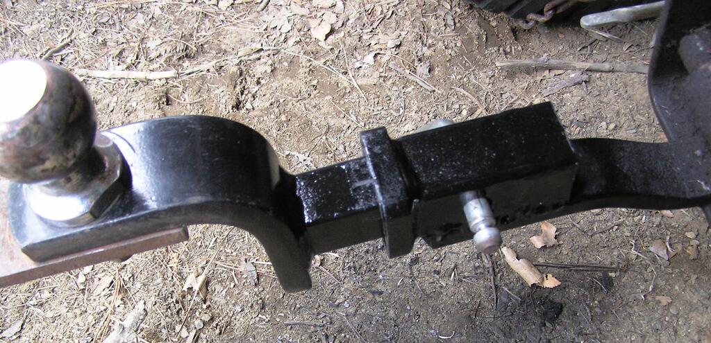

Wayne0 1,666 #15 Posted April 14, 2025 Thank you all for your help and suggestions. This pin ain't comin' out easy. I'm just going to weld the receiver to the old hitch. Easier, cheaper and faster. 1 Share this post Link to post Share on other sites
Wayne0 1,666 #16 Posted April 18, 2025 I wound up doing this. Fits my needs. 2 Share this post Link to post Share on other sites

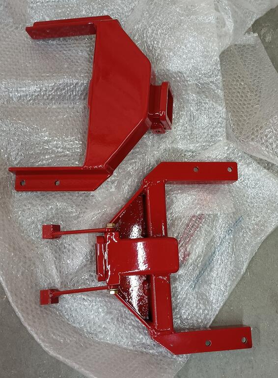

ebinmaine 81,282 #17 Posted April 18, 2025 Just for the sake of future documentation here's a picture of the ones Brian Badman is now selling. @76c12091520h 1 Share this post Link to post Share on other sites
Wayne0 1,666 #18 Posted April 18, 2025 (edited) Thanks for that! I see one can get around removing the pin on that! Good design. If I change my mind, I can delete mine with a grinder. I did mine on the cheap. I mounted a tab under the ball to use the pin hitch on my cart. Edited April 18, 2025 by Wayne0 2 Share this post Link to post Share on other sites
