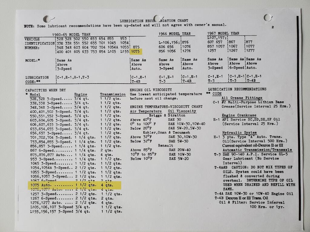

Racinbob 13,193 #2 Posted April 10, 2025 I haven't bothered to even remove that 'fill' plug for decades. The 'fill until it comes out the hole' thing is wrong. Simply put use 1.5 quarts in the 3 and 4 speeds, 2 quarts in the 6 and 8 speeds. I use a nozzle on the jugs of lube and remove one of the seat bolts to fill. Some folks remove the shifter. Here's a chart they put out. Ignore the highlighted part. 3 Share this post Link to post Share on other sites

kpinnc 18,969 #7 Posted April 10, 2025 8 hours ago, Racinbob said: I haven't bothered to even remove that 'fill' plug for decades. The 'fill until it comes out the hole' thing is wrong. Simply put use 1.5 quarts in the 3 and 4 speeds, 2 quarts in the 6 and 8 speeds I've always used 2 full quarts of gear oil whether it's a 4 or 8 speed. 2 Share this post Link to post Share on other sites
ebinmaine 80,743 #8 Posted April 10, 2025 Just now, kpinnc said: I've always used 2 full quarts of gear oil whether it's a 4 or 8 speed. Same 1 Share this post Link to post Share on other sites
Racinbob 13,193 #9 Posted April 10, 2025 2 hours ago, kpinnc said: I've always used 2 full quarts of gear oil whether it's a 4 or 8 speed. 2 hours ago, ebinmaine said: Same I do the same but I didn't want to muddy the tranny fluid by differing from the chart. 1 1 Share this post Link to post Share on other sites
