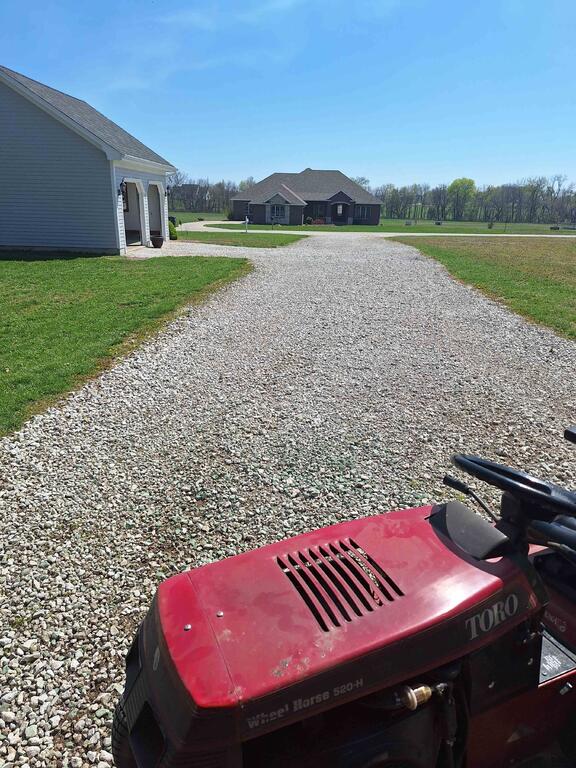

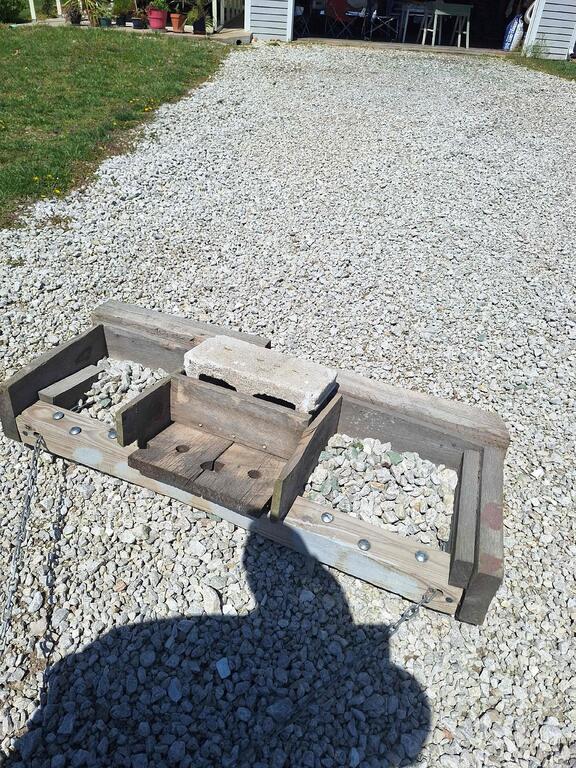

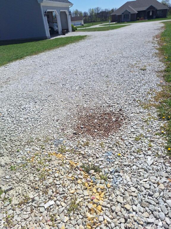

Beap52 2,057 #1 Posted April 9, 2025 I just got home from storm spotter training. It was in association with our monthly amateur radio meeting. We normally have 10 to 15 in attendance but tonight at least 40. Today, in addition to aerating the yard, I worked on the driveway. Over time the gravel gets bunched up where the cars turn to enter the garage and in general gets packed down. I made the drag contraption several years ago. The gravel caught inside covers a 4x4. One thing I would have done differently was use grade 8 bolts in the lead 4x4 because the bolts I used have bent over-but they still work and are sharpened to a point. The last picture is the finished project. After 20 years, it's about time to order another load of gravel. 3 3 Share this post Link to post Share on other sites

ebinmaine 77,530 #3 Posted April 9, 2025 Very interesting contraption. Works well. Trina uses a mid mount grader blade on ours. 1 Share this post Link to post Share on other sites
peter lena 9,779 #4 Posted April 9, 2025 @Beap52 any loose surface needs a regular , touch up , thats the cure for any disturbance to its top setting , like your weight box drag , allows surface to find itself , another thing , to add to tht is your drag / pull speed , the slower you can cover an area , the more it will settle , into where it wants to be, your open top box set up , is what you want , another thing , is plowing snow on that , would not , plow down to the stone , enhancing stone pick up , be glad to get off most , not all of it , looks like your SUN SETTING ,ANGLE , is assurance of assisted melting . often refer to that , always plow with the sun , to assist melting / refreezing , have a hedge side of driveway, sun blocking shade / freeze . angle plow to opposite sun side , melts into drain , been doing that for years , REPEDITIVE PROBLEMS SHOW YOU THE WAY , TO CORRECT THEM , pete 1 Share this post Link to post Share on other sites
lynnmor 8,644 #5 Posted April 9, 2025 If you could find a local contractor to roll it for a sensible price, it would greatly increase the time between reworking. 3 Share this post Link to post Share on other sites
Handy Don 16,006 #6 Posted April 9, 2025 3 hours ago, lynnmor said: If you could find a local contractor to roll it for a sensible price, it would greatly increase the time between reworking. Adding some “fines” to fill the crevices before rolling will also make the surface a bit sturdier. Using the drag device tends to settle the fine material down under the coarser gravel. 1 1 Share this post Link to post Share on other sites
SylvanLakeWH 30,640 #7 Posted April 9, 2025 And when you do add gravel don't use "washed". You want the fines in there to help set it up... 2 Share this post Link to post Share on other sites
