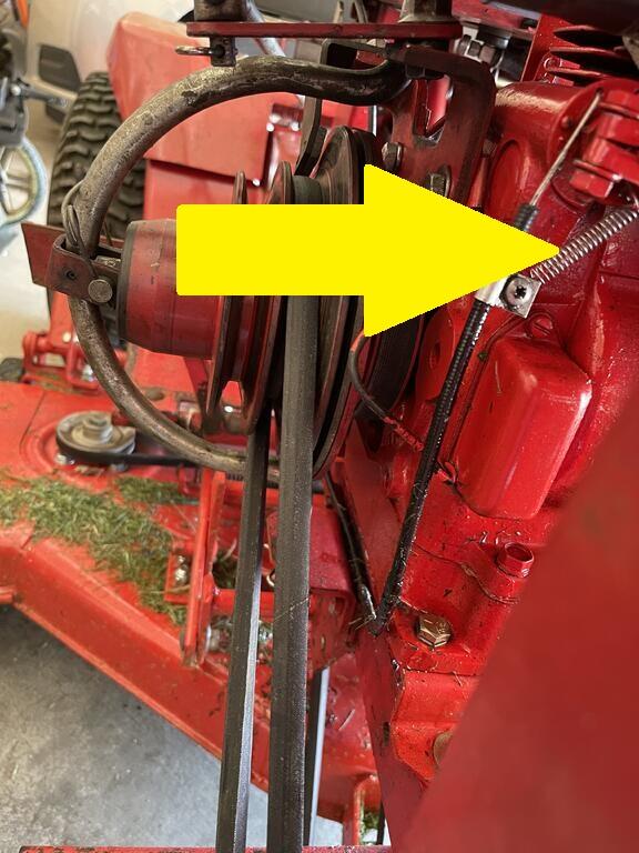

stvski80085 279 #1 Posted April 8, 2025 The engine was just rebuilt. Only has about 30-45 minutes of run time. Starts right up and sounds great. I noticed once I started trying to Mow grass with the rebuilt deck it's pushing oil out of the governor. I am going to check the breather setup Friday when I have time. It's not smoking and runs great. I drove it around seemed to all work well. Then I put the mowing deck on. Just for your info this deck has all new spindle bearings and idler. Moves free by hand. No issues with the deck itself. When I engage the deck it seems to start fine and when I throttle up and try to drive it's bogging down randomly. No pto it's perfect. I adjusted the pressure on the clutch plate a bit thinking it was slipping. It did this like 5 times and I should have grabbed a video. I will Friday if needed. I am thinking I have something with the PTO not right. Not sure what would cause the motor to bog down and die under load like that. Here are pics of the clutch and setup. Just trying to get idea's from the professionals here. Someone has had to have this happen to them. Thanks in advance for any idea's. Steve Share this post Link to post Share on other sites

wallfish 20,510 #4 Posted April 8, 2025 (edited) What's that extra spring doing connected to the governor? There should be an OEM torsion spring that connects the disk to the arm. Remove that spring and set the governor according to the manual. Carb adjustment could be a culprit too Edited April 8, 2025 by wallfish 1 Share this post Link to post Share on other sites
stvski80085 279 #5 Posted April 8, 2025 I was wondering about that spring too but it was working so I didn’t mess with it. I will take a look at that too. Share this post Link to post Share on other sites
ineedanother 2,803 #6 Posted April 8, 2025 13 minutes ago, wallfish said: What's that extra spring doing connected to the governor? There should be an OEM torsion spring that connects the disk to the arm. Remove that spring and set the governor according to the manual. Carb adjustment could be a culprit too Agreed, and also agree with checking the breather assembly. Oil issue could be due to incorrect assembly or something like sealant blocking the drain hole in it if any was used. Share this post Link to post Share on other sites
wallfish 20,510 #7 Posted April 8, 2025 2 minutes ago, stvski80085 said: I was wondering about that spring too but it was working so I didn’t mess with it. I will take a look at that too. With the engine off, the governor arm should be keeping the carb butterfly on full open. Then the gov kicks in to close it when it starts. Maybe find a way to put the engine under load without the deck operating. Like driving up a steep hill. That would indicate if it's the deck or simply something when the engine is under load. Does the engine run fine at high RPM without the PTO engaged or the deck spinning? A bad plug wire will fail under load 1 Share this post Link to post Share on other sites

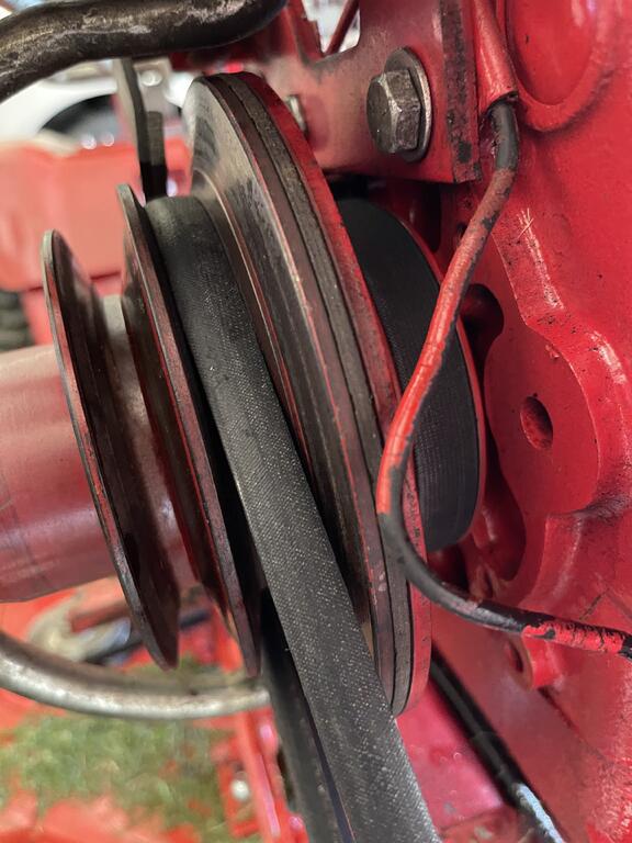

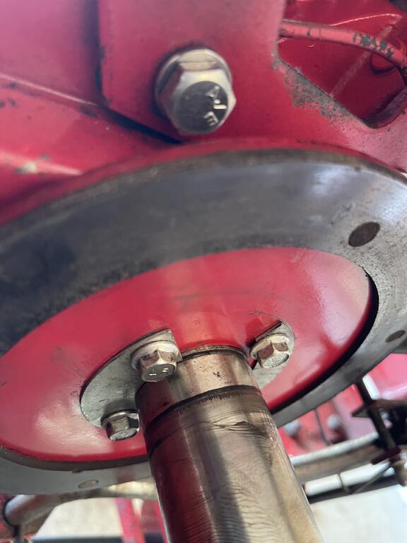

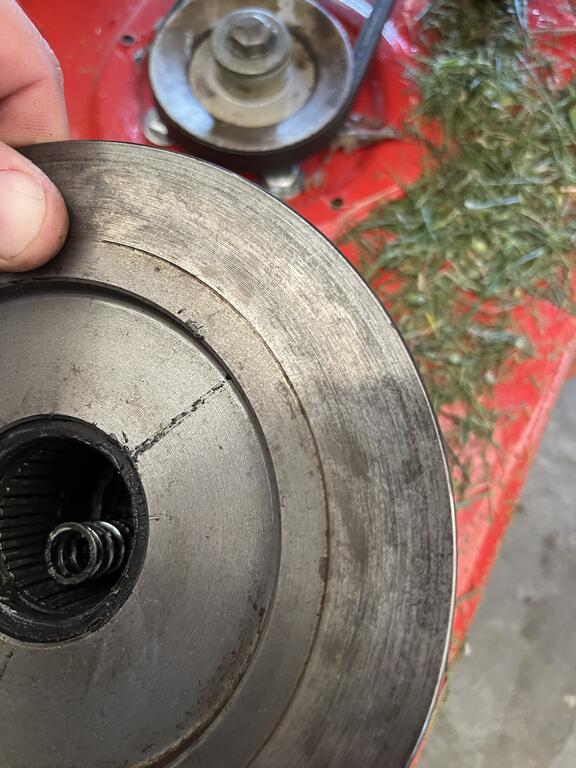

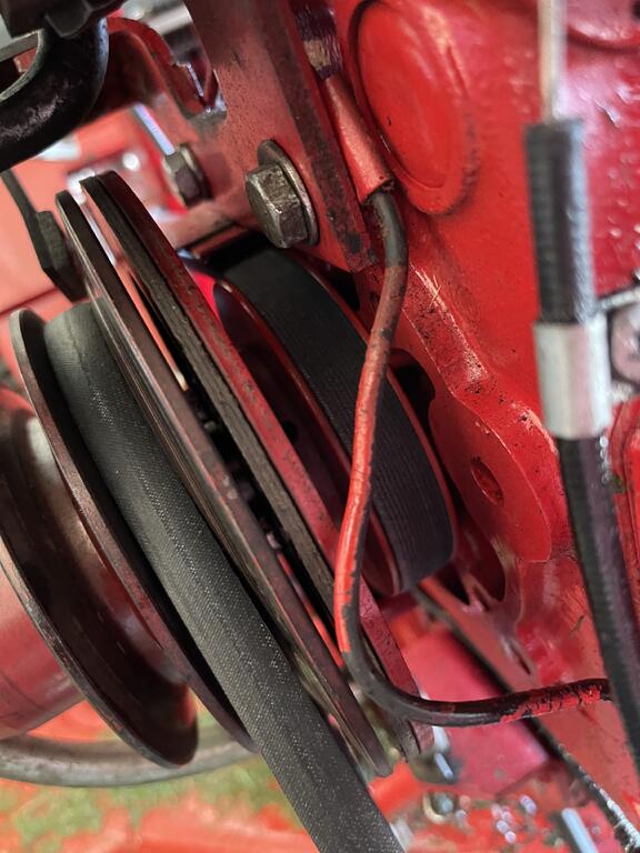

Blasterdad 3,167 #11 Posted April 8, 2025 A couple of things I noticed, It's kind of hard to tell but the needle bearings in the PTO bell look worn flat, but maybe it's the grease making it look that way. I've never seen a compression spring inside the PTO either. The clutch plate retaining clip doesn't look right on the right side in the picture. It doesn't look like it's in the groove. The negative wire from the points looks suspect too. I've never seen one routed behind the upper PTO bracket like that before. 1 Share this post Link to post Share on other sites
squonk 47,887 #12 Posted April 8, 2025 Yes points wire routed wrong. May be pinched. Pto disc retainer not in it's groove. Ditch that spring. Make sure it's not overfilled with oil. Share this post Link to post Share on other sites

stvski80085 279 #16 Posted April 9, 2025 (edited) So the bearing on the pto is good. I think grease maybe making it look flat but it's good. I will work through the list below so far. 1. I did see where I need to route the points wire and will reroute that. It's not pinched at all though. 2. I also ordered a new pto saftey switch and will put the new one on. It looks a little rough so just swapping it. 3. Check breather is put together correctly. I did read that if the rings haven't seated yet that could be why it's building pressure and pushing oil out govenor. One guy said it took a few hours of running and went away. (That is just what I read) 4. Remove the spring and reset govenor. After this I will see how she runs. Could need some carb adjustment still but we will see. I have an aftermarket carb as backup if needed for testing. I know the pto levers need some work but it does function correctly. It's on the list after I get running right. Edited April 9, 2025 by stvski80085 Share this post Link to post Share on other sites
Blasterdad 3,167 #17 Posted April 9, 2025 The spring in the PTO doesn't belong in there either. 1 Share this post Link to post Share on other sites
Gasaholic 390 #18 Posted April 9, 2025 32 minutes ago, Blasterdad said: The spring in the PTO doesn't belong in there either. On some of them it does, if it has the little stub pin screwed into the end of the crankshaft to keep it positioned. 3 Share this post Link to post Share on other sites
Blasterdad 3,167 #19 Posted April 10, 2025 17 minutes ago, Gasaholic said: On some of them it does, if it has the little stub pin screwed into the end of the crankshaft to keep it positioned. Learn something new every day, none of my 's have it... Share this post Link to post Share on other sites
stvski80085 279 #20 Posted April 10, 2025 (edited) My diagram shows the spring. I checked. Also this tractor has no seat switch. Edited April 10, 2025 by stvski80085 1 Share this post Link to post Share on other sites
Gasaholic 390 #21 Posted April 10, 2025 10 hours ago, stvski80085 said: My diagram shows the spring. I checked. Also this tractor has no seat switch. Yes, the spring was only there for a few model years, it was meant to give a more positive separation of the PTO clutch from clutch plate when disengaging PTO. If the spring is there, you also want to make sure the thrust bearing and two thrust washers are present - They will slip over the locating "pin" (Basically a bolt with the head cut off and a screwdriver slot to thread it in to the crankshaft) and then the spring seats on that and up against the stub shaft of the PTO. If the thrust bearing set is missing (2 washers that have a flat roller bearing in between, so 3 parts there, the stub pin and spring are the other 2 parts to that system) I do not recommend the spring be reinstalled until they are present, otherwise the spring can hang up or weld itself to the crankshaft and mess up the PTO bearing. This would date your tractor into the 1970's, AFTER they redesigned the PTO lever (that'd be their first version of the "current" design up until they changed it to add the little return spring from the cam plate to the half hoop instead, and then later a bit of engineering change eliminated the need for that, as well.) and before the CPSC stepped in making the seat safety switches a requirement (Which actually was a common sense addition, IMHO) 2 Share this post Link to post Share on other sites

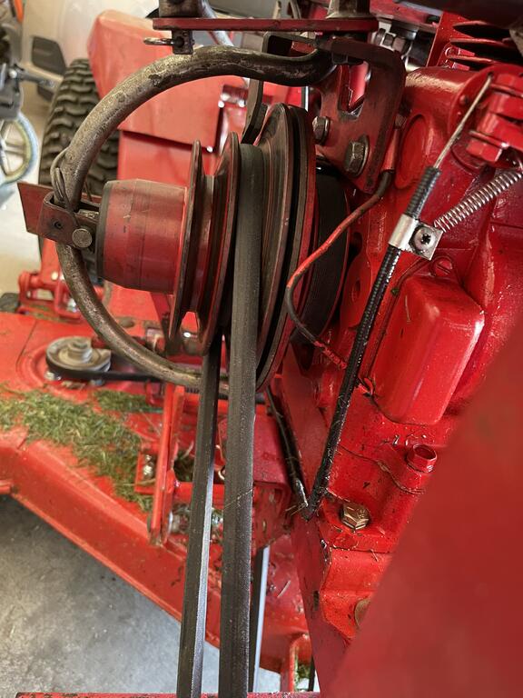

stvski80085 279 #23 Posted April 10, 2025 On 4/7/2025 at 7:48 PM, wallfish said: What's that extra spring doing connected to the governor? There should be an OEM torsion spring that connects the disk to the arm. Remove that spring and set the governor according to the manual. Carb adjustment could be a culprit too So I don’t see a spring on the governor shaft. Should the governor spring be pulling right or left. I ordered a new arm that has the spring attached. Just trying to get it running right. Share this post Link to post Share on other sites
stvski80085 279 #24 Posted April 10, 2025 (edited) ok, spring is on the arm. The spring in the picture is hooked to the little arm #69 in manual. (8 hp kohler). I'm confused because even a guy I'm watching now on youtube has a spring like this too. Turned a little more then mine but I have seen it on others too. If I take that spring off then it seems that the arm I'm talking about above wouldn't be needed. Just trying to clarify. Edited April 10, 2025 by stvski80085 Share this post Link to post Share on other sites
wallfish 20,510 #25 Posted April 10, 2025 (edited) 21 minutes ago, stvski80085 said: ok, I looked at the manual and it looks like he hooked the spring to the arm that maybe the throttle is supposed to be hooked too. I guess nothing hooks to the small arm which is #69 in the manual? 8 horse Kohler. Post a pic that isn't so zoomed in so we can see all the linkage and the carb If you remove the governor arm from the shaft you should see the tortion spring and how it connects the disk to the arm. The governor tries to close the carb whenever the engine is running and it's the throttle cable which pulls on the spring to open the carb via the link from the arm to the carb to make it run faster. Edited April 10, 2025 by wallfish Share this post Link to post Share on other sites
