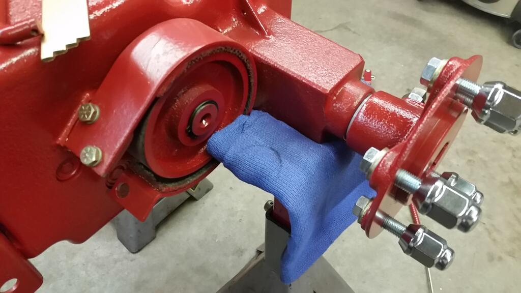

WHX?? 58,388 #4 Posted April 6, 2025 (edited) 54 minutes ago, markseven said: where to Go. Auto parts stores and farm & barn stores. Look in the trailer aisle as they are often used on trailers. Many of use swap out lug bolts for studs. Makes wheel mounting, especially with loaded tires, easier. A 7/16-20 x 1 1/4 fits the bill. Edited April 6, 2025 by WHX?? 4 3 Share this post Link to post Share on other sites
markseven 93 #5 Posted April 6, 2025 That's nice but my old tractor would stress out . 2 1 Share this post Link to post Share on other sites
953 nut 70,656 #6 Posted April 6, 2025 9 minutes ago, markseven said: my old tractor would stress out Hate to think of a Wheel Horse becoming stressed out. If you talk nice to it and explain that new lug bolts will be for its own good it will accept them. 1 3 Share this post Link to post Share on other sites
markseven 93 #7 Posted April 7, 2025 Alright will check it out but chrome i Don't know . Share this post Link to post Share on other sites
