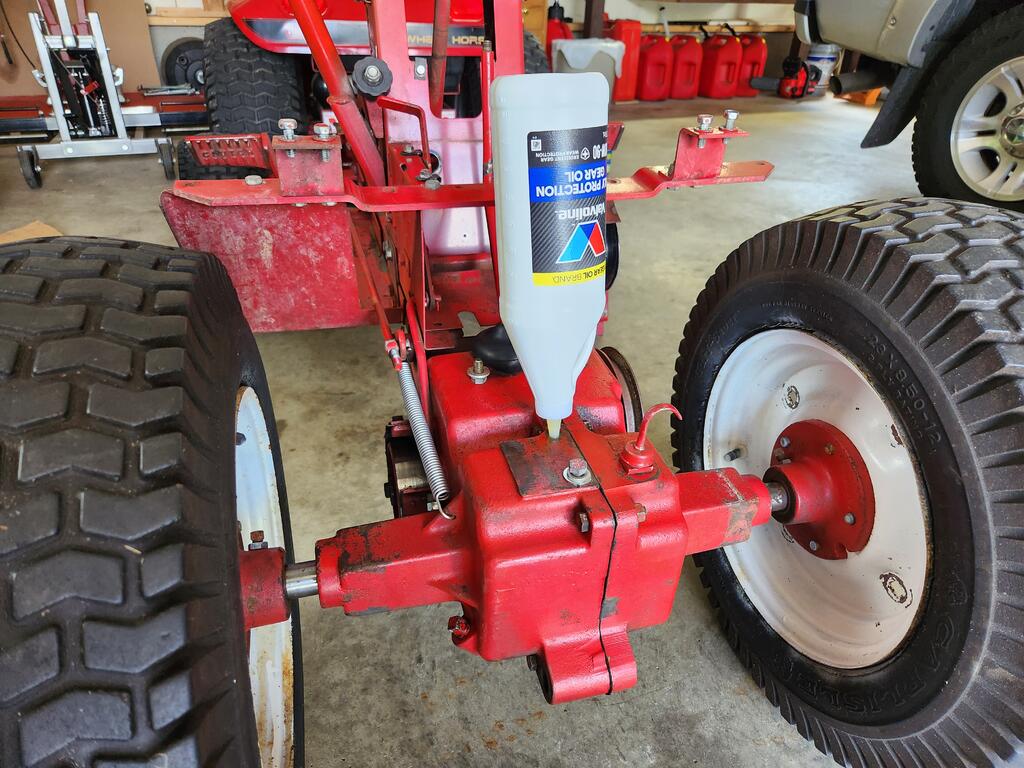

SylvanLakeWH 32,549 #8 Posted April 4, 2025 39 minutes ago, Achto said: You would gain oil capacity that might be of benefit. Not sure it is necessary though. I just filled one with 1/2 quart extra by tipping tractor up on left side, fill, put in plug and lower it... easy peasy... that trick brought to you by @Pullstart... 3 Share this post Link to post Share on other sites
FLtractor 230 #9 Posted April 5, 2025 4 hours ago, SylvanLakeWH said: I just filled one with 1/2 quart extra by tipping tractor up on left side, fill, put in plug and lower it... easy peasy... that trick brought to you by @Pullstart... Ahh that’s where I’ve heard the tipping tractor to side before. Thanks 2 Share this post Link to post Share on other sites

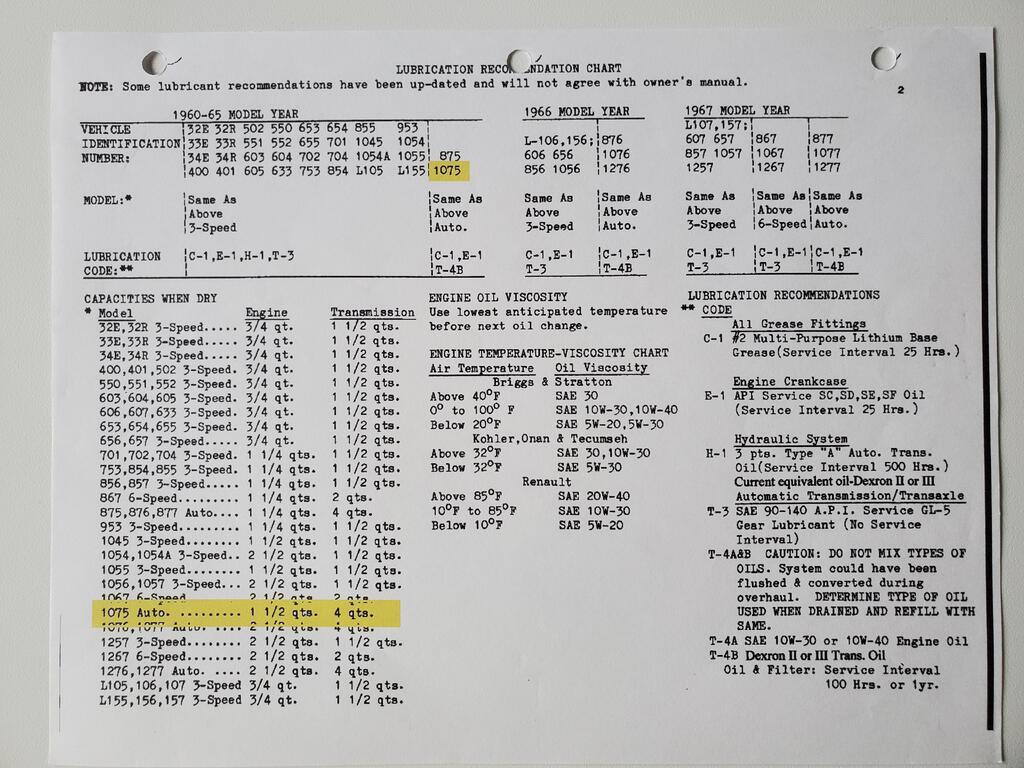

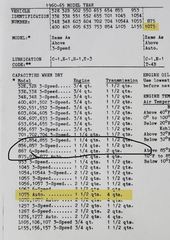

FLtractor 230 #11 Posted April 6, 2025 16 hours ago, Racinbob said: I haven't bothered with that 'fill' hole for decades. Figure 1.5 quarts for the 3 and 4 speeds and 2 quarts for the 6 and 8 speeds and be done with it. The only thing that extension did was eliminate the need to tip the tractor to get the proper amount in if you insist on going that route. I think it was only factory installed on the 6 speeds making folks think they required more. Not so. In reality it would be fine to run 2 quarts in all of the Unidrive manuals. I was looking at this engine and gear oil amount for the 856. Share this post Link to post Share on other sites
Racinbob 13,193 #12 Posted April 6, 2025 That highlighted 1075 was on that sheet when I saved it. Didn't mean to mislead you. Share this post Link to post Share on other sites

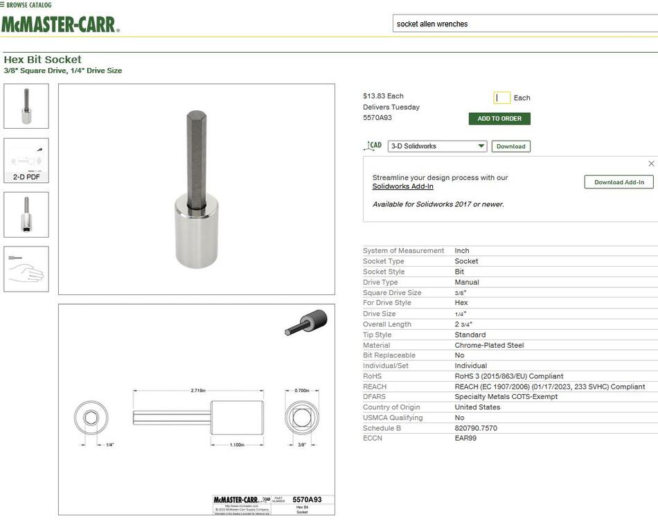

FLtractor 230 #13 Posted April 6, 2025 12 hours ago, Racinbob said: That highlighted 1075 was on that sheet when I saved it. Didn't mean to mislead you. Ahh ok. Thank you. what kind of wrench is needed for the transmission drain hole on the bottom? Appears to be 6 sided. Not familiar with a socket or a Allen that is 6 Share this post Link to post Share on other sites
pfrederi 21,154 #14 Posted April 6, 2025 (edited) 1/4" allen wrench socket Edited April 6, 2025 by pfrederi 1 Share this post Link to post Share on other sites

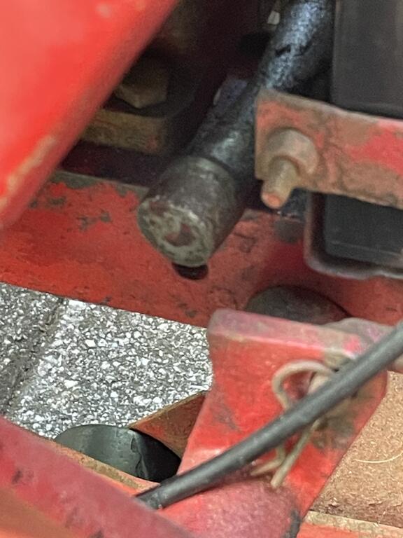

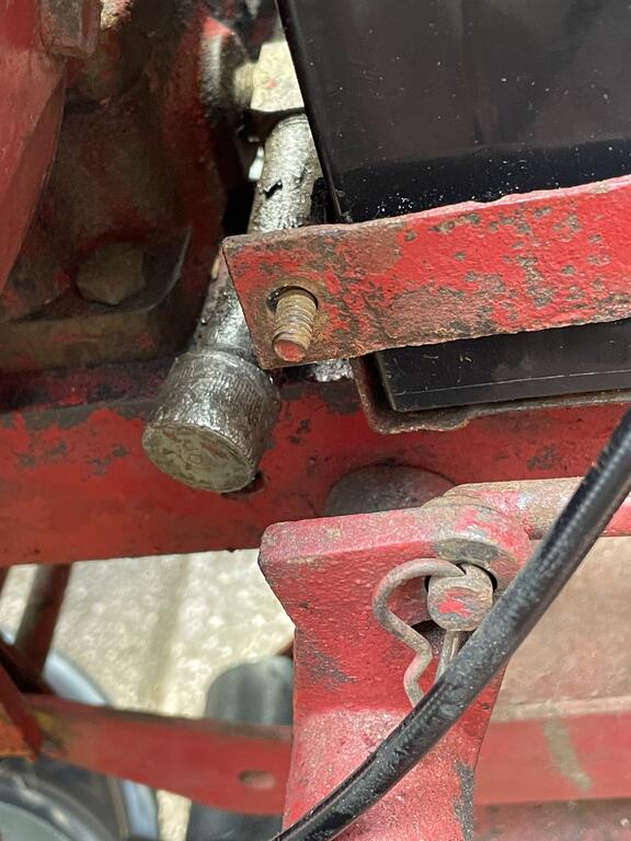

FLtractor 230 #15 Posted April 6, 2025 (edited) 1 hour ago, pfrederi said: 1/4" allen wrench socket Thank you!! Also been attempting to use a pair of vice grips and channel locks to no progress whatsoever ever for over a hour to remove the engine oil drain plug threaded cap here Edited April 6, 2025 by FLtractor Share this post Link to post Share on other sites
pfrederi 21,154 #16 Posted April 6, 2025 Small Pipe Wrench or pliers like these 1 Share this post Link to post Share on other sites

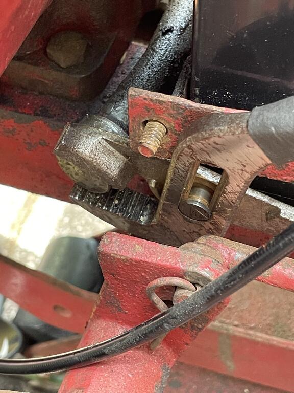

FLtractor 230 #17 Posted April 6, 2025 (edited) 57 minutes ago, pfrederi said: Small Pipe Wrench or pliers like these Been attempting to use those or a pair or vice grips but due to all the metal in the way I can’t seem to get any good grip with leverage.. I did remove a nut for the battery metal holding piece but the bolt doesn’t move and all the pressure that would be applied to the threaded end cap is applied to that bolt.. so that doesn’t help.. would be the prefect location to remove the threaded end cap.. maybe I should get a shorter smaller pair of channel locks. Seller did tell me he haven’t changed the oil in 4 years.. checked it thru dipstick hole.. oil level good and proper color.. just not having been removed in so long the threaded end cap doesn’t wanna come off Edited April 6, 2025 by FLtractor Share this post Link to post Share on other sites
rjg854 13,360 #18 Posted April 6, 2025 (edited) Does unhooking the brake/clutch pedal gain you any extra room to get at the cap? Work from the other side? Edited April 6, 2025 by rjg854 Add Share this post Link to post Share on other sites
Pullstart 71,259 #19 Posted April 6, 2025 Sometimes on pipe fittings, you’ll find that if you can’t loosen it, you can still tighten it. It’s the weirdest thing. Try opening up those slip groove pliers one more notch, and getting the jaws in there good. Give it a hit to the right and I bet five bucks it’ll move. Prizes redeemable in high fives, or worthless chatter at the Big Show! 1 Share this post Link to post Share on other sites
FLtractor 230 #20 Posted April 6, 2025 2 hours ago, rjg854 said: Does unhooking the brake/clutch pedal gain you any extra room to get at the cap? Work from the other side? Attempted that.. no luck. Either unhooking cable or From other side. Share this post Link to post Share on other sites
FLtractor 230 #21 Posted April 6, 2025 37 minutes ago, Pullstart said: Sometimes on pipe fittings, you’ll find that if you can’t loosen it, you can still tighten it. It’s the weirdest thing. Try opening up those slip groove pliers one more notch, and getting the jaws in there good. Give it a hit to the right and I bet five bucks it’ll move. Prizes redeemable in high fives, or worthless chatter at the Big Show! Will give that a go eventually.. took break for now. Under that threaded cap is there anything preventing oil from leaking out once it’s removed such as a nut? is there any simple recommended replacement such as a fitting or value for that dreaded threaded end cap once it’s off so don’t have to go through this everytime ? Share this post Link to post Share on other sites
Pullstart 71,259 #22 Posted April 6, 2025 14 minutes ago, FLtractor said: Will give that a go eventually.. took break for now. Under that threaded cap is there anything preventing oil from leaking out once it’s removed such as a nut? is there any simple recommended replacement such as a fitting or value for that dreaded threaded end cap once it’s off so don’t have to go through this everytime ? You could opt for a 1/2” npt plug right into the block, opposed to a chute to get it outside the frame rail. It might be a challenge to get to, but less potential leak points. Share this post Link to post Share on other sites
