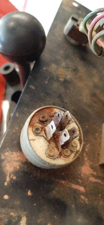

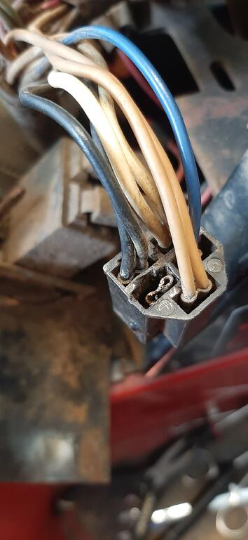

John c 224 #1 Posted April 4, 2025 the ignition switch has been struggling to engage the solenoid for a few months now, figured it was time for a new one, inspection shows signs of excess heat at the battery lead, which was probably due to poor connection due to corrosion/rust over it's lifetime. It kinda fell apart once I started handling it, can one of y'all tell me which way the crimp on connector is supposed to come out of the connector body ? thanks 1 Share this post Link to post Share on other sites
lynnmor 9,081 #2 Posted April 4, 2025 (edited) Take it to a NAPA store. You should be able to slide a thin blade down alongside the terminal to release it. Edited April 4, 2025 by lynnmor 1 Share this post Link to post Share on other sites
Achto 32,963 #3 Posted April 4, 2025 (edited) 2 hours ago, John c said: can one of y'all tell me which way the crimp on connector is supposed to come out of the connector body ? There is a tab on the connector that needs to be pushed in, then the terminal will come out of the back of the plug. A pic of the connector to help you out and one source for new connectors. https://www.amazon.com/Baomain-Female-Terminals-connector-insulated/dp/B01MFEDLM4/ref=sr_1_3?crid=3MJAEWPQ0MGNC&dib=eyJ2IjoiMSJ9.vQA9w-KcNJ6D7be3mW3pJ8Qcl9sYWNmhfgyG8JesP_UDkUN2MSqWksrooucFCMcygEJmr9oHFF4bFpKfRFMBNhJritunLrg_PziXCECZuARtvvqIO1y-enthHMjPZsw2g2fQShCx3XtdtUifenL6-s9K0cW4rg0fndsRFO1PttItxQgxY4MrE8_T1xc6SIuFHRClHGbtlo-9q_osbX338hs5vPDSewOHQjOf6DMiBGc.qhUO-HPNtSp8Ny-_un-aRGU52G7q7-URDf2x49ksR2o&dib_tag=se&keywords=female+spade+connectors+for+plugs&qid=1743790743&sprefix=female+spade+connectors+for+plugs%2Caps%2C109&sr=8-3 Edited April 4, 2025 by Achto 1 Share this post Link to post Share on other sites

953 nut 70,656 #5 Posted April 4, 2025 This video will show you how to remove and replace the Packard 56 terminals. You can buy them at NAPA or any other GOOD auto parts store. Share this post Link to post Share on other sites
John c 224 #6 Posted April 5, 2025 Once I got it cleaned up and blown out, I saw I was fighting with nearly melted plastic too, I was able to finally get it freed up. I've got a stens branded switch coming in Sunday. I'll see if I can source new lock inn crimps locally, if not I'll make do with the basic style I have on hand. Thanks 2 Share this post Link to post Share on other sites
