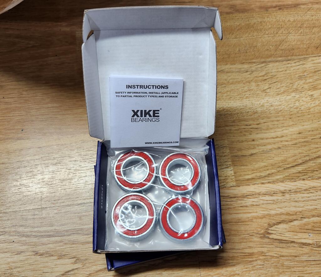

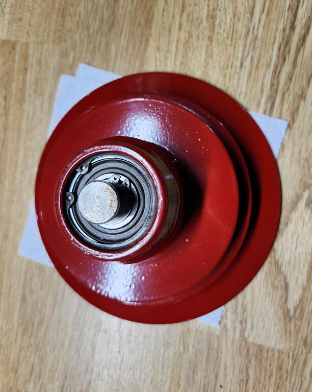

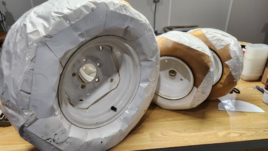

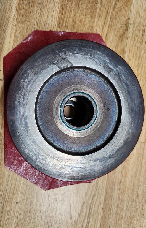

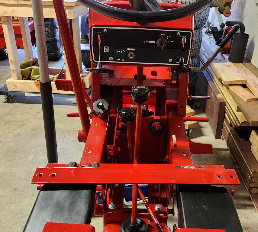

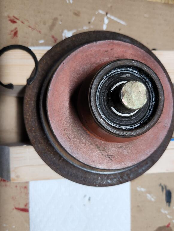

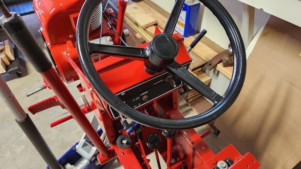

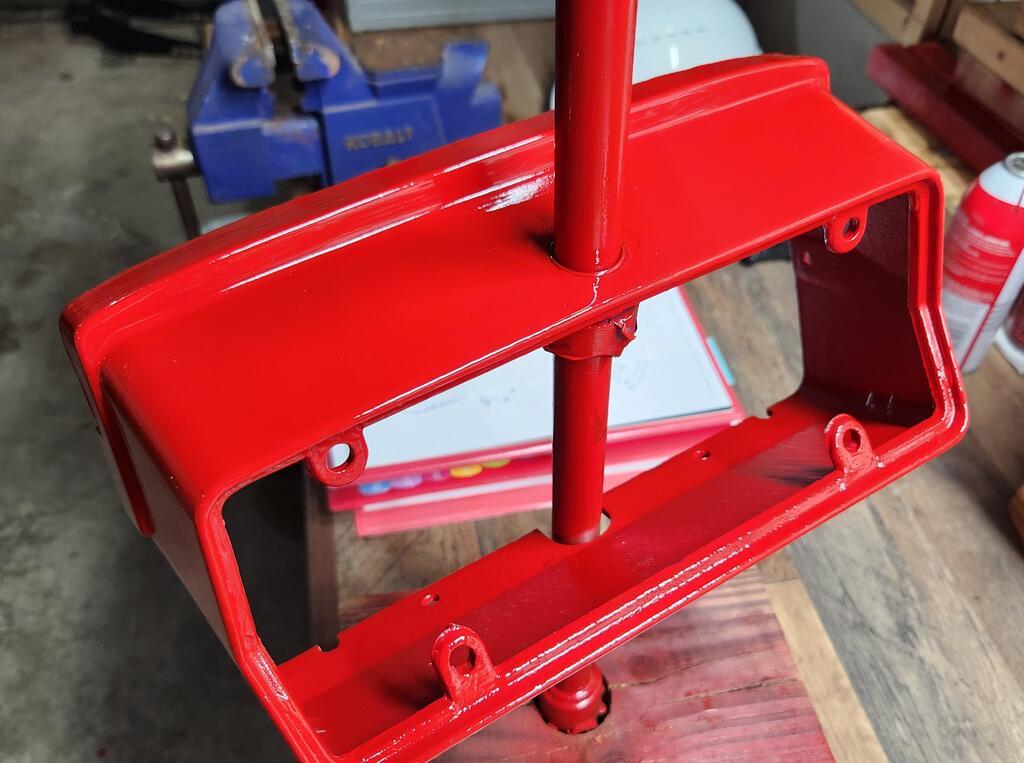

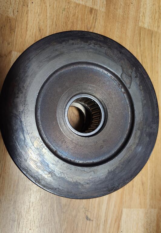

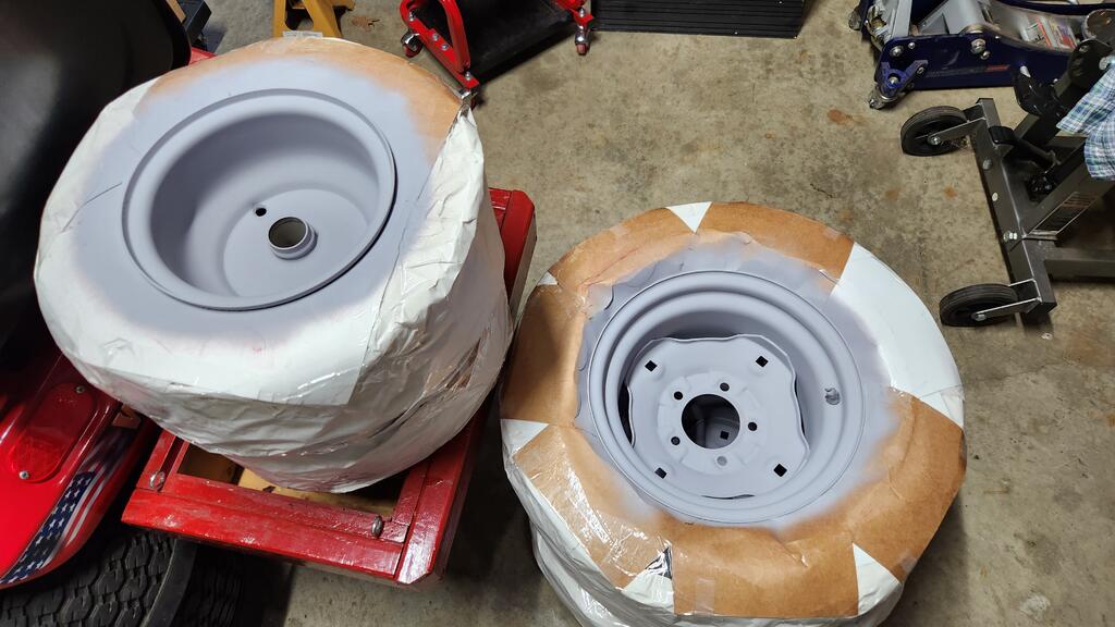

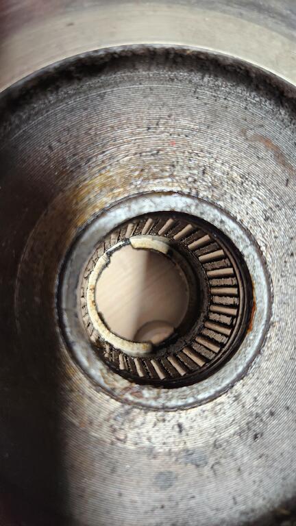

Racinbob 13,086 #1 Posted April 1, 2025 Progress is slow with the weather in the 70's one day, 30's the next then repeating the pattern. I did manage to get the dash housing painted. Rattle canned with the Squonk touch. Final wet coat of red and immediately a wet coat of gloss clear. It came out great and the dry time was much shorter. I already had the dash dolled up. The PTO needed some loving. Both bearing were good. I didn't want to try and remove the needle bearing so I closed up the end and flooded it with mineral spirits. It cleaned up great. Greased it up and installed a new seal, put the outer bearing back in and it's good to go for another 47 years. Covered up the tires, a light sanding and rattle can primed the wheels. The color coat of custom mixed sorta almond linen beige will be done with a sprayer so I gotta wait on the weather. Then it will be new sealed bearings. 5 12 Share this post Link to post Share on other sites
