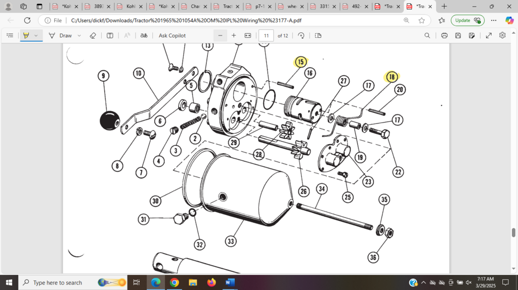

Tonytoro416 1,314 #1 Posted March 29, 2025 Anyone have this problem? I assume I need a new spring but what can be done as far as repairing the end plate where the spring has been working on it ? Share this post Link to post Share on other sites

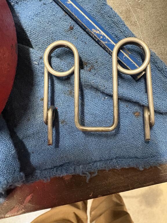

Tonytoro416 1,314 #6 Posted March 29, 2025 The spring needs to remain “free” at the ends correct ? Share this post Link to post Share on other sites

953 nut 64,924 #9 Posted March 29, 2025 8 hours ago, Tonytoro416 said: The spring needs to remain “free” at the ends correct ? The spring should be rather tight going into the holes, it will flex at the points where the eyes are bent in it. I would suggest drilling out both holes for ROLL PINS and using the 1054 type spring. Lowell has the springs. https://wheelhorsepartsandmore.com/product/5261-wheel-horse-1054-spring-qty-1/ 1 Share this post Link to post Share on other sites
Tonytoro416 1,314 #10 Posted March 29, 2025 1 hour ago, 953 nut said: The spring should be rather tight going into the holes, it will flex at the points where the eyes are bent in it. I would suggest drilling out both holes for ROLL PINS and using the 1054 type spring. Lowell has the springs. https://wheelhorsepartsandmore.com/product/5261-wheel-horse-1054-spring-qty-1/ I have a spring the one you speak of but won’t I need a different piston ? 10 hours ago, 8ntruck said: Drill a fresh hole and press in a properly sized bushing? Definitely an idea for sure Share this post Link to post Share on other sites
