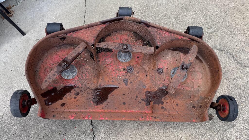

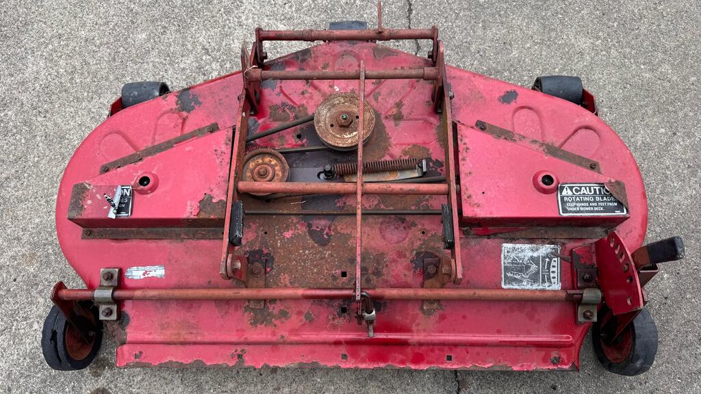

Bar Nuthin 2,932 #1 Posted March 28, 2025 I wasn't looking for a mower deck, but when someone offers up fairly solid rear discharge for $50 - you kinda have to take it - right? Model tag is shot, so I'll have to do some searching. Curios as to what bolts along the back edge. Looks like there's never been anything there, so I'm guessing whatever it is - is optional. Maybe a striper, or just a deflector? Share this post Link to post Share on other sites
953 nut 68,155 #2 Posted March 28, 2025 Some people bolt or pop-rivet a piece of vinyl floor base board on there to keep the clippings from going all over. 1 Share this post Link to post Share on other sites
Ed Kennell 46,795 #3 Posted March 29, 2025 I've seen a short metal deflector bolted on there. I'm not sure if they are a factory/dealer option. 1 Share this post Link to post Share on other sites

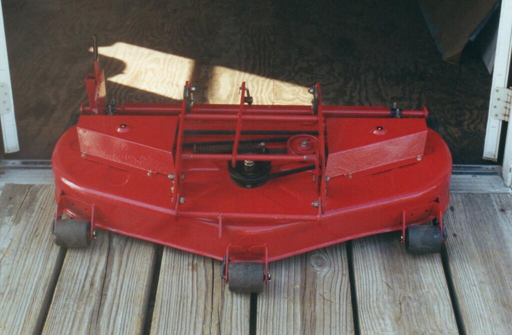

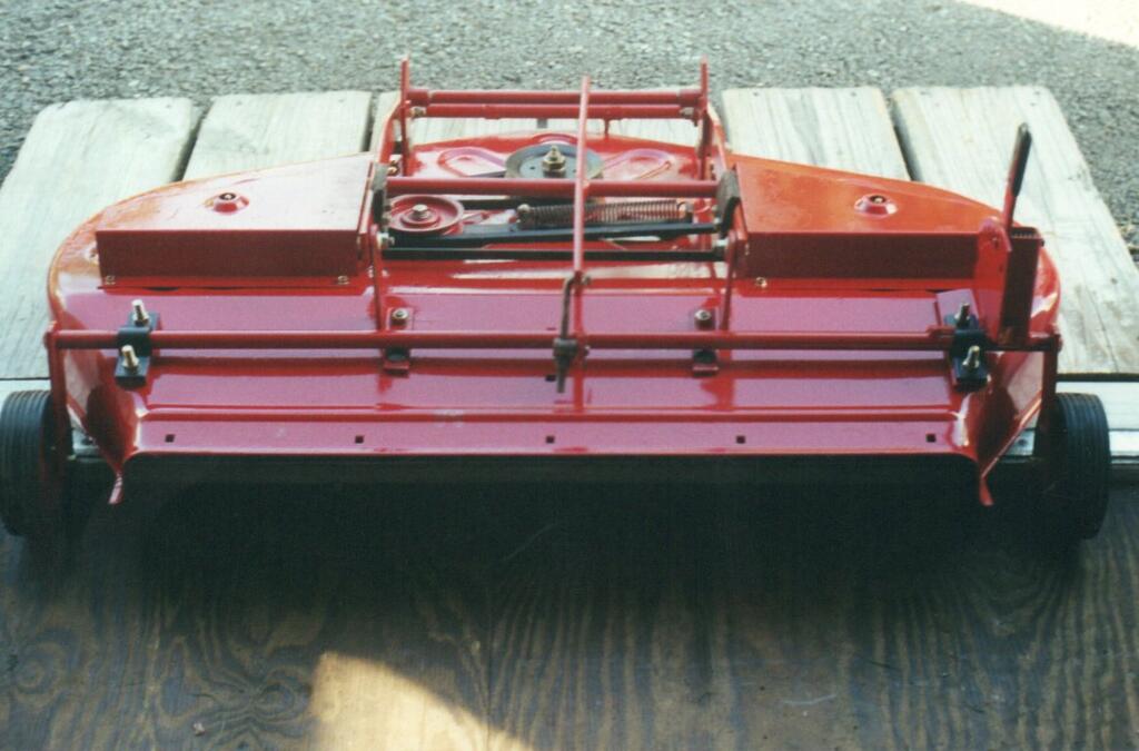

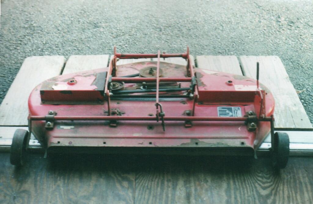

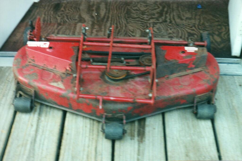

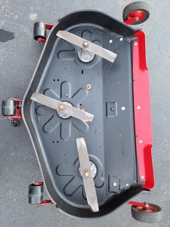

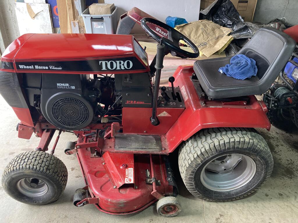

JCM 11,342 #4 Posted March 29, 2025 This one pictured was a deck that came with a 1986 312-8 that I restored both deck and tractor. This one as yours with nothing attached to the holes. This was an original owner tractor when I bought it. @Bar Nuthin 2 5 Share this post Link to post Share on other sites
MainelyWheelhorse 3,008 #5 Posted March 29, 2025 3 hours ago, 953 nut said: Some people bolt or pop-rivet a piece of vinyl floor base board on there to keep the clippings from going all over. A thin strip of rubber bolted through the provided square holes works good too that’s what I used on mine. 2 Share this post Link to post Share on other sites
Blasterdad 3,167 #6 Posted March 29, 2025 3 hours ago, Bar Nuthin said: Curios as to what bolts along the back edge. Looks like there's never been anything there, so I'm guessing whatever it is - is optional. Maybe a striper, or just a deflector? I have that same deck 42" RD. Some were recyclers, a block off plate bolts there to help with mulching. I took it off mine. 1 Share this post Link to post Share on other sites
oliver2-44 11,656 #7 Posted March 29, 2025 I have a deck like that and it has a short deflector plate. Mine looks factory. 2 Share this post Link to post Share on other sites
Ed Kennell 46,795 #8 Posted March 29, 2025 Mower Rotary 42in RD 1976 65-42MR01 TIPL.pdf Factory deflector item 113. 1 Share this post Link to post Share on other sites

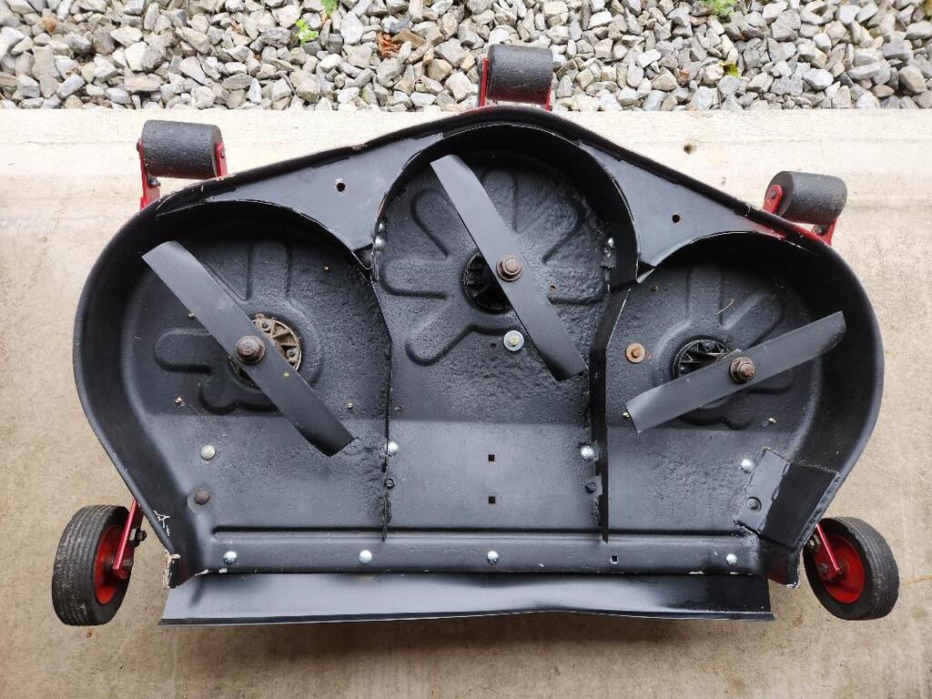

Brockport Bill 2,448 #9 Posted March 29, 2025 i have rehabbed a number of the 42 rd decks -- i have found installing a piece of household baseboard vinyl ( has a natural curl ) with carriage bolts to be a simple and inexpensive way of deflecting the grass clippings downward -- especially important if you have a H tractor rather than a gear tranny so as to avoid the clippings going on to the Hydro fins. Good Luck, Bill 1 8 Share this post Link to post Share on other sites
peter lena 9,993 #10 Posted March 29, 2025 @Brockport Bill very nice job on that , ! only different thing I did was remove the ROT BOXES under the deck , initially experimented with a very sad deck , also always cut at highest setting , for better discharge flow . actually deck function is a thorough detailing , and elimination of problem spots , once I made the change out , its a BASE LINE FOR REPEDITIVE AREAS . still marvel at the pto lever function to related belt mule drive , and all bearings , no whining noise or screaming clutch , it all looks original , but detailing its movement , was the deal for me , pete 1 Share this post Link to post Share on other sites
MainelyWheelhorse 3,008 #11 Posted March 29, 2025 (edited) 17 hours ago, Bar Nuthin said: I wasn't looking for a mower deck, but when someone offers up fairly solid rear discharge for $50 - you kinda have to take it - right? Model tag is shot, so I'll have to do some searching. Curios as to what bolts along the back edge. Looks like there's never been anything there, so I'm guessing whatever it is - is optional. Maybe a striper, or just a deflector? I’d say it’s somewhere in the 80’s as the ID tag looks like the one on my 42 RD deck which was I think an 89. The one on my 92 312’s mowing deck that was bought with it when new is completely different. Also, the ID tag for my 87 308 is similar to yours as well. Edited March 29, 2025 by MainelyWheelhorse 1 Share this post Link to post Share on other sites
Bar Nuthin 2,932 #12 Posted March 29, 2025 6 minutes ago, MainelyWheelhorse said: I’d say it’s somewhere in the 80’s as the ID tag looks like the one on my 42 RD deck which was I think an 89. The one on my 92 312’s mowing deck that was bought with it when new is completely different. I agree. The grease zerk holes in the belt guards put it into the mid-'80s 1 Share this post Link to post Share on other sites
Bar Nuthin 2,932 #13 Posted March 29, 2025 (edited) These baffles seem counter-intuitive to me. Plus they look like a built in rust trap. @Brockport Bill what is your opinion between the 2 decks you have? Edited March 29, 2025 by Bar Nuthin Share this post Link to post Share on other sites
Brockport Bill 2,448 #14 Posted March 30, 2025 8 hours ago, Bar Nuthin said: These baffles seem counter-intuitive to me. Plus they look like a built in rust trap. @Brockport Bill what is your opinion between the 2 decks you have? its difficult to know the design logic at WH company when they did the deck engineering? yes, i agree the baffles are just grass traps and therefore rust incubators ------ and worse they have designed openings which invite the grass into the cavities so i dont get the purpose -- Also, its hard to guess the design of those with the 2 sectioning baffles that go from front of the underneath to the rear dicharge area divided into thirds???? ------ other than it keeps the grass airflow segragated to its own blade section for the discharge -- of course then WH also made those with NO baffles or cowlings - - so hard to know the WH logic -- Frankly, I doubt it makes much difference how the grass is actually cut or discharged other than in the entirely open design there must be lots of cross turbulance from the three different blade areas 1 Share this post Link to post Share on other sites
Bar Nuthin 2,932 #15 Posted March 30, 2025 4 hours ago, Brockport Bill said: the baffles are just grass traps and therefore rust incubators I took a closer look today, and they are packed full of nasty. They're coming off!!! 1 Share this post Link to post Share on other sites

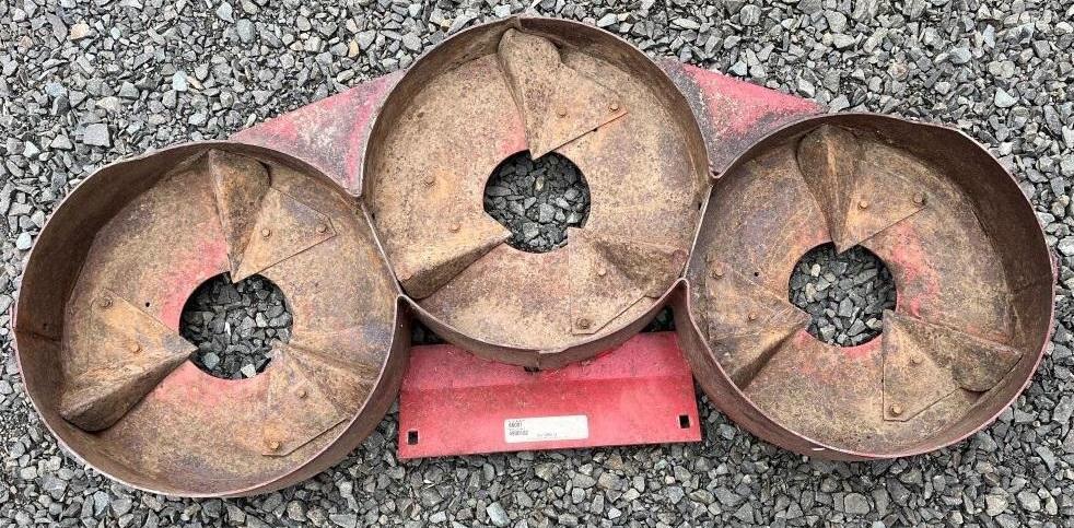

Blasterdad 3,167 #23 Posted April 4, 2025 8 hours ago, Bar Nuthin said: My thought is that with the factory baffles and the addition of a rear flap might accomplish my goal. This is what Toro used for the 42" RD Recycler decks. Just to give you an idea... 1 Share this post Link to post Share on other sites
Bar Nuthin 2,932 #24 Posted April 5, 2025 3 hours ago, Blasterdad said: This is what Toro used for the 42" RD Recycler decks. Just to give you an idea... Wow! That looks like one crazy setup! I don't imagine there are many survivors out there. Share this post Link to post Share on other sites
Blasterdad 3,167 #25 Posted April 5, 2025 51 minutes ago, Bar Nuthin said: Wow! That looks like one crazy setup! I don't imagine there are many survivors out there. I seen one at the Big Show last year, but yeah, few & far between. 1 Share this post Link to post Share on other sites
