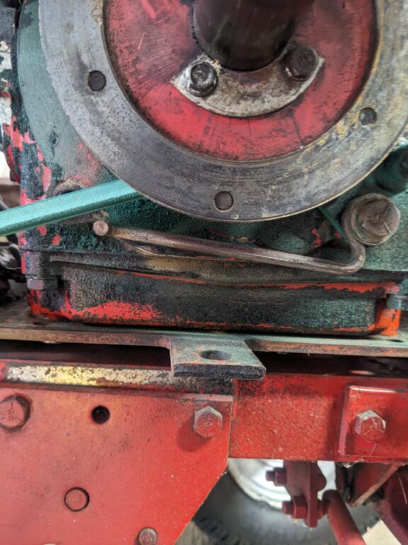

tmc2872 15 #1 Posted March 26, 2025 So new to this forum (all winter lurker) and I am having trouble with my 68 raider 12. My drive belt is not disengaging when I go to shift gears. I don't think I have my belt guides set correctly. Any help would be greatly appreciated. I inherited this tractor from my neighbor who was going to scrap it. I have already rewired it rebuilt the carb and put just a bunch of sweat equity in to it. I really like this little tractor and would love to be able to use it this upcoming season. Just getting a little frustrated with it right now. Thanks for any help again. 3 Share this post Link to post Share on other sites

tmc2872 15 #4 Posted March 26, 2025 I don't have any internal tabs on the inside 1 Share this post Link to post Share on other sites
tmc2872 15 #5 Posted March 26, 2025 I'm wondering if I have these guides installed wrong. 1 Share this post Link to post Share on other sites

squonk 47,729 #7 Posted March 26, 2025 (edited) 12 minutes ago, tmc2872 said: I don't have any internal tabs on the inside That guide is not correct. It goes on the back side of the belt. It's designed so when you push on the pedal the belt slacks and the guide supports it. Then the slack pushes the belt away from the pulley. Edited March 26, 2025 by squonk 3 4 Share this post Link to post Share on other sites

tmc2872 15 #9 Posted March 26, 2025 It seems to rub on that bolt head when I had it that way. Hence the reason I put it on the inside of the belt. 1 Share this post Link to post Share on other sites
Handy Don 17,189 #10 Posted March 26, 2025 (edited) I’m fairly sure that the bent-rod guide and the bolt are in the wrong place--just remove them. The “pulling” side of the belt, when the clutch is fully engaged, should be a straight shot from the bottom of the engine pulley to the bottom of the transaxle pulley. it should pass very close to but not touching the inside of the lower “shelf” of the belt cover. Hoping someone more familiar with that model will chip in and tell you the correct location for that guide! 😁 Edited March 26, 2025 by Handy Don 2 1 Share this post Link to post Share on other sites
Ed Kennell 46,794 #11 Posted March 26, 2025 That bolt and wire guide should be moved forward to the tapped hole forward of the pulley. That should position the guide closer to the pulley like the top guide. 4 5 Share this post Link to post Share on other sites
Handy Don 17,189 #12 Posted March 26, 2025 5 minutes ago, Ed Kennell said: That bolt and wire guide should be moved forward to the tapped hole forward of the pulley. That should position the guide closer to the pulley like the top guide. Ah, thanks Ed. So this guide gets positioned close to the belt so it makes contact and drags on the belt when the clutch is disengaged instead of a tab on the bottom of the belt cover! 3 Share this post Link to post Share on other sites

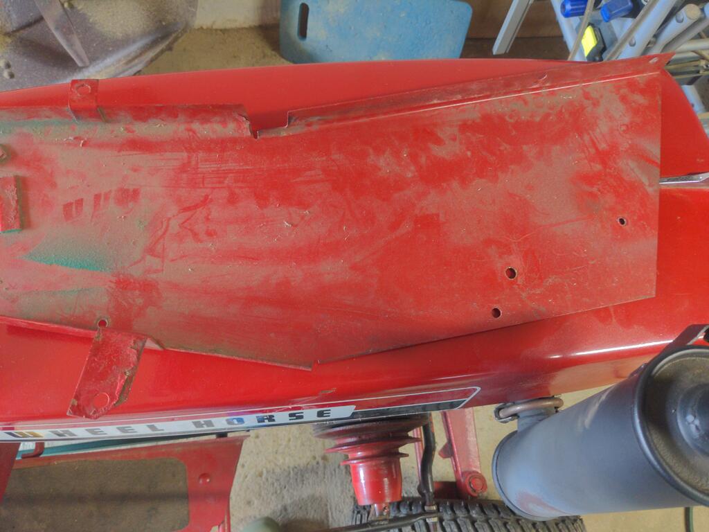

gwest_ca-(File Mod) 12,416 #13 Posted March 26, 2025 Later models had tabs welded to the front of the guard. This will give you an idea of the location to be effective. 1 Share this post Link to post Share on other sites
squonk 47,729 #14 Posted March 26, 2025 6 minutes ago, gwest_ca said: Later models had tabs welded to the front of the guard. This will give you an idea of the location to be effective. pic doesn't work Gary 1 Share this post Link to post Share on other sites

tmc2872 15 #20 Posted March 31, 2025 Was this what you guys were meaning? It still doesn't seem to be getting enough drag. Share this post Link to post Share on other sites
Ed Kennell 46,794 #21 Posted March 31, 2025 (edited) 47 minutes ago, tmc2872 said: Was this what you guys were meaning? It still doesn't seem to be getting enough drag. The guide looks to be located correctly now, but the gap with the belt should be 1/32" on the top and bottom guide when the belt is tight. And the belt guard must also be installed to support the bottom loop of the belt to to assist in the disengaging of the belt from the engine drive pulley Edited March 31, 2025 by Ed Kennell 4 Share this post Link to post Share on other sites

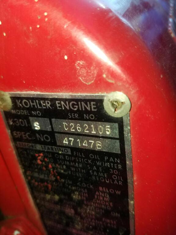

squonk 47,729 #22 Posted March 31, 2025 (edited) That doesn't look like the right engine oil pan for a 68 Raider 12. Engine should be a K301S and it looks like an "AS" style pan like a 1076 would have. May have a swapped engine. The engine crankshaft height might not be correct for the belt guard you are using. Edited March 31, 2025 by squonk 5 2 Share this post Link to post Share on other sites
953 nut 68,140 #23 Posted March 31, 2025 1 hour ago, squonk said: doesn't look like the right engine oil pan for a 68 Raider 12. Engine should be a K301S and it looks like an "AS" style pan like a 1076 would have. May have a swapped engine. The engine crankshaft height might not be correct for the belt guard you are using. Good eye Mike. 1 Share this post Link to post Share on other sites

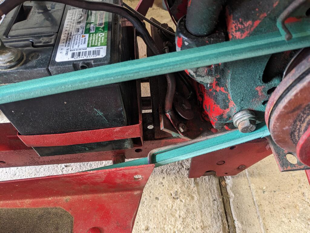

squonk 47,729 #24 Posted March 31, 2025 This is a Raider 12, Notice the taller oil pan 1 Share this post Link to post Share on other sites
WHX?? 57,640 #25 Posted March 31, 2025 8 minutes ago, 953 nut said: Good eye Mike. Doesn't mean you can't make it work. Space the engine up to the height of a deep pan? Should be enough hood height. I don't think that spring thingy should even be there. Correct motor for a '68 12 and best pic I have for the PTO. 1 Share this post Link to post Share on other sites
