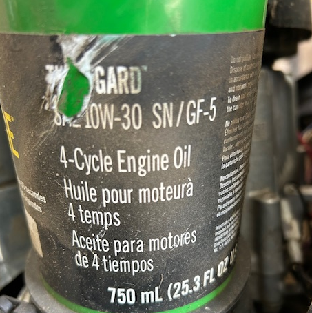

JoeM 10,268 #1 Posted March 26, 2025 I have seen a John Deere 30 second easy change oil system. Neighbor brought her machine over for a service and it had this oil change system on it. Well not running anything new, I never seen one of these. After a while and looking into it, wow what bunch of bananas this is. First, it only changes about half of the oil (contained in the filter). Second the unit at Lowes cost just north of $60. I guess changing some of the oil and filter is better than changing none? And it you got the extra cash, oh well, they seen you coming. Needless to say, I am converting it to the old spin on filter for about $20 in parts. And this machine was purchased at a dealer! Just sharing. 1 1 3 3 Share this post Link to post Share on other sites

JoeM 10,268 #6 Posted March 27, 2025 7 hours ago, EB-80/8inPA said: Dry sump system with the reservoir in that disposable can thingy? Half and half I suppose. The sump has oil. I found a drain plug on the other side of the engine. Going to warm it up and drain the sump too. See what comes out . I think the whole system holds 2 quarts. I just can not believe they come out with such a gimmick. Share this post Link to post Share on other sites

JoeM 10,268 #8 Posted March 27, 2025 (edited) I did drain the sump and got a little more than 1 1/2 quarts, I figure that can drains back into the sump a bit not sure how. The whole Briggs thing from no oil change to this thing is sooooo bad. Turns out not to be a Briggs thing.....John Deere exclusive, even worse. Edited March 28, 2025 by JoeM 1 Share this post Link to post Share on other sites
