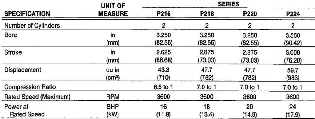

onanparts.com 185 #15 Posted March 30, 2025 On 3/28/2025 at 5:40 PM, Bill D said: I think it's heat plus the larger bore. This makes the area between the cylinder wall and the valve seat just thin enough to cause problems. Nope. ^^^^^^ P216, P218 & P220 Blocks are identical inside and out. All with 3 1/4" STD bores. Example: 500 blocks at the beginning of the assembly line. At the end? 250 P216's, 125 P218's and 125 P220's. Internal parts determine what model. P218 and P220 are identical twins if not for the higher lift cam and larger carb jets on the P220. Several production runs where the seats were not peened or peened correctly to lock in the seat happened at some point in time. Of the millions made, a small fraction had this issue. Debris clogging the head etc. can and has caused those seats to come loose. If you want to be happy for a day, Drink! Want to be happy for a year, Marry! Want to be happy for a lifetime? Take care of your Onan! 3 Share this post Link to post Share on other sites
Bill D 2,992 #16 Posted March 30, 2025 56 minutes ago, onanparts.com said: Nope. ^^^^^^ P216, P218 & P220 Blocks are identical inside and out. All with 3 1/4" STD bores. Example: 500 blocks at the beginning of the assembly line. At the end? 250 P216's, 125 P218's and 125 P220's. Internal parts determine what model. P218 and P220 are identical twins if not for the higher lift cam and larger carb jets on the P220. Several production runs where the seats were not peened or peened correctly to lock in the seat happened at some point in time. Of the millions made, a small fraction had this issue. Debris clogging the head etc. can and has caused those seats to come loose. If you want to be happy for a day, Drink! Want to be happy for a year, Marry! Want to be happy for a lifetime? Take care of your Onan! Thanks for the clarification. I always thought the 220 had a larger bore. Share this post Link to post Share on other sites
onanparts.com 185 #17 Posted March 30, 2025 7 minutes ago, Bill D said: Thanks for the clarification. I always thought the 220 had a larger bore. You betcha! It's the Big Block, big brother to the small blocks that has a larger bore. P224, 24HP. Share this post Link to post Share on other sites
