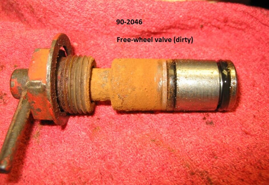

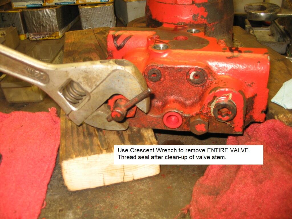

daveoman1966 3,885 #21 Posted March 24, 2025 This is the tow valve. Use a crescent wrench and take it completely out and clean it up. Smear a bit of Vaseline on it before reinstalling. 1 Share this post Link to post Share on other sites
