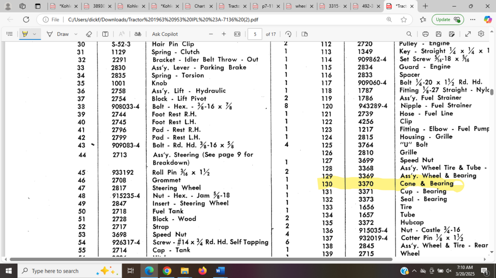

Tonytoro416 1,396 #1 Posted March 20, 2025 Am I correct in my 953 taking a 3/4” bore X 1 3/4” OD flanged bearing for front wheels ? Share this post Link to post Share on other sites
Retired Wrencher 7,043 #2 Posted March 20, 2025 Did you check the manuals section here for a part number? I hope this helps. Share this post Link to post Share on other sites
953 nut 70,656 #3 Posted March 20, 2025 (edited) 9 hours ago, Tonytoro416 said: Am I correct in my 953 taking a 3/4” bore X 1 3/4” OD flanged bearing for front wheels ? No, the front wheels on a 953, 1054 and GT-14 have tapered roller bearings like the ones used on most automobiles and trucks in the 1960s. Edited March 20, 2025 by 953 nut 2 1 Share this post Link to post Share on other sites
peter lena 10,125 #4 Posted March 20, 2025 @Tonytoro416 another vital part of that set up is bushings , eliminating that LATERAL PLAY , along with good lubrication , makes those bearings live , personally use the HILLMAN MACHINE BUSHINGS , 3/4 x 1 1/4 x 18 ga , 14 ga , for a solid snug fit , also like a vinyl snug fitting end cap . have that set up on my 3 units , lots of hours , no play or bearing issues , local hardware store has the bushings . pete 1 Share this post Link to post Share on other sites
953 nut 70,656 #5 Posted March 20, 2025 These are tapered roller bearings, tighten the castle nut, back it off slightly and insert the cotter pin. https://en.wikipedia.org/wiki/Tapered_roller_bearing Share this post Link to post Share on other sites
squonk 48,427 #6 Posted March 20, 2025 There will be a number stamped on both the race and bearing. Pretty sure they are a common set you can get at any auto parts store. The seal may need to be ordered though. Share this post Link to post Share on other sites
Tonytoro416 1,396 #7 Posted March 21, 2025 15 hours ago, 953 nut said: No, the front wheels on a 953, 1054 and GT-14 have tapered roller bearings like the ones used on most automobiles and trucks in the 1960s. That’s what I ordered 1 Share this post Link to post Share on other sites
squonk 48,427 #8 Posted March 21, 2025 If you only needed the bearing that's fine. but if you needed the race (cup) also you would also need 3371 Share this post Link to post Share on other sites
