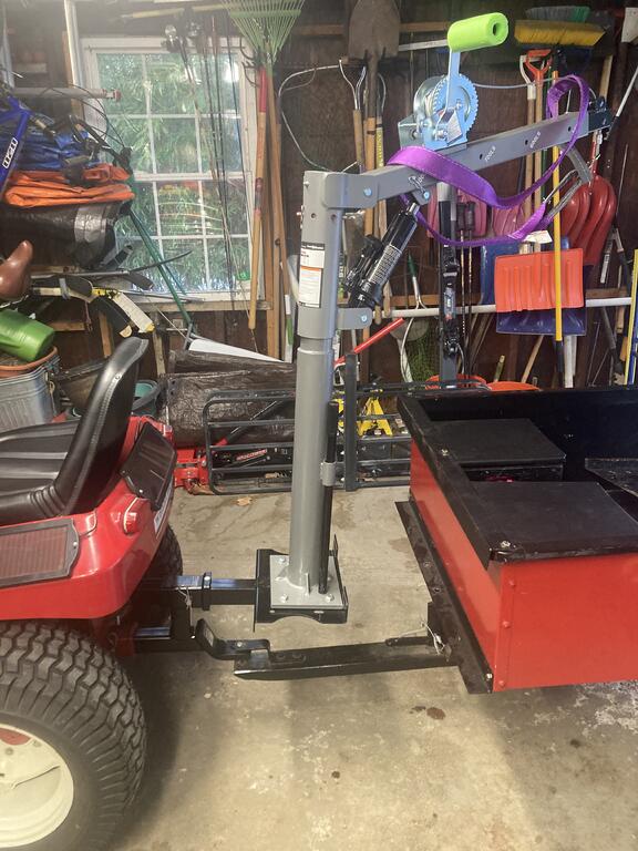

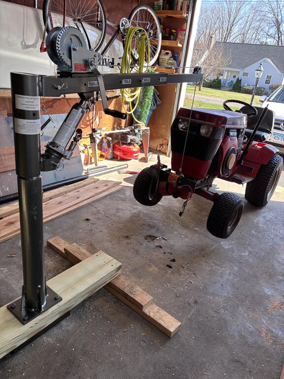

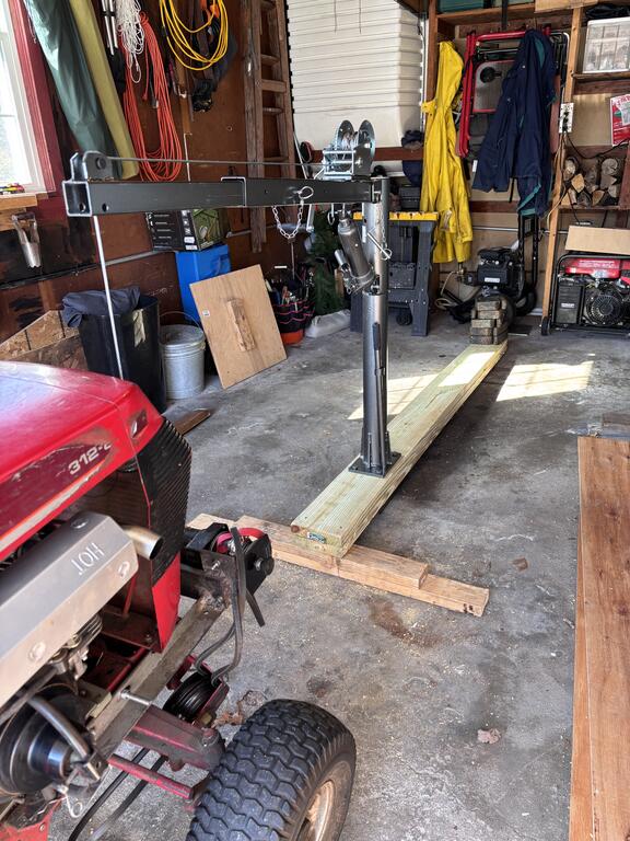

CCW 1,522 #18 Posted April 9, 2025 (edited) Update - Looking at the suggestions above I decided to go with the pickup truck crane. Currently going through the design and testing process and on Tuesday will pick up a 350 lb block of concrete for further testing. Looking at the second photo you can see five WH suitcase weights on the end of the eight foot 2x8s. Base did not move at all in this test lifting the front of my 312-8. My plan is for three, six or eight foot, 4x4s to be attached to the double 2x8s. One at each end where the edge of the dock is and one just in front of the crane pedestal. If more counter weight is needed then helpers can stand on the 2x8 base. Also the 4x4 cross members at each end will be clamped to the dock. Since all your expertise came into play on this project I am open to more suggestions. Edited April 9, 2025 by CCW 1 Share this post Link to post Share on other sites
Handy Don 17,735 #19 Posted April 10, 2025 I think you are definitely on the right track here. Looking good! Please don’t ignore the forces in play at the base of the vertical member of the crane where it attaches to the wooden base. Consider grade 5 or 8 for the bolts and perhaps a metal plate on top and bottom of the wooden beams to distribute the load across a wider area. 1 Share this post Link to post Share on other sites
SylvanLakeWH 32,921 #20 Posted April 10, 2025 I would also test lift off the side of it as you intend to " pivot" the load... Also, lifting the tractor keeps the load static because of rear wheel contact. Dead load swinging is a true test of intent... 1 Share this post Link to post Share on other sites
Handy Don 17,735 #21 Posted April 10, 2025 23 minutes ago, SylvanLakeWH said: I would also test lift off the side of it as you intend to " pivot" the load... Excellent point. Using only nails on any part of the wooden base would be risky, as they could pull out when the force is “up” instead of “down.” The carpenter that helped my dad build his house frequently reminded us that “You can use nails for building a house but for anything else, use screws or bolts.” I was eight years old and it stuck, so that tells you how often he said it! 1 Share this post Link to post Share on other sites
CCW 1,522 #22 Posted April 10, 2025 @Handy Don & @SylvanLakeWH Thanks for the input. The bolts are 1/2 inch grade 5 and there is metal angle iron on the underside of the 2x8. Next step is to bolt on 9 foot 2x12 cross members at each end and just behind the crane if needed. When in use on the dock helpers can stand on the 2x12 to add any needed counter weight. 4 Share this post Link to post Share on other sites
