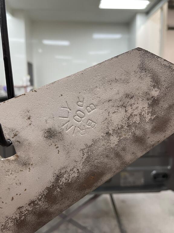

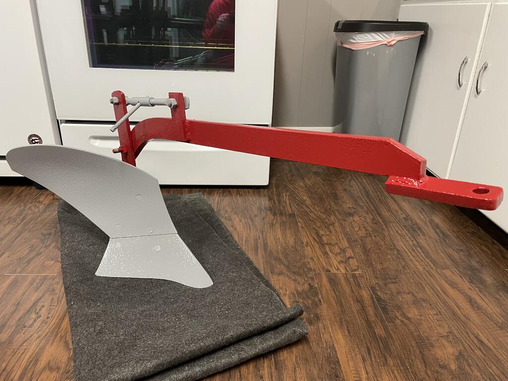

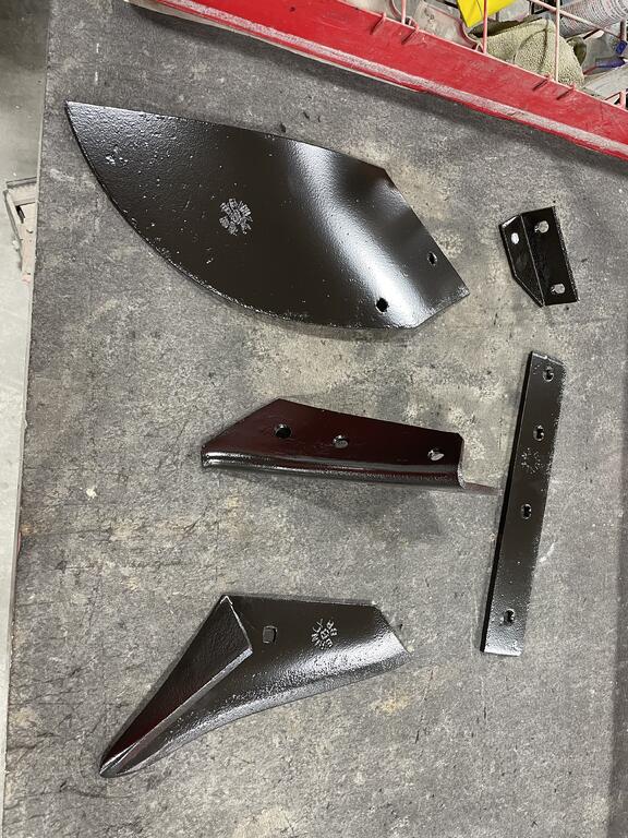

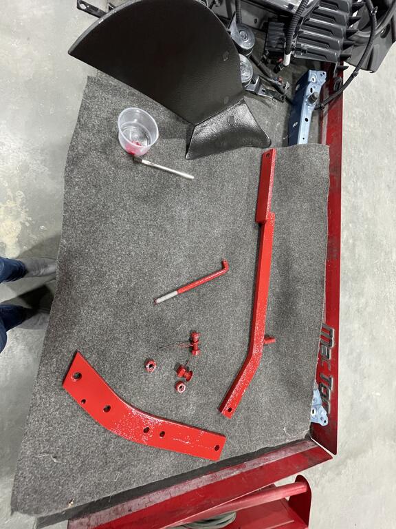

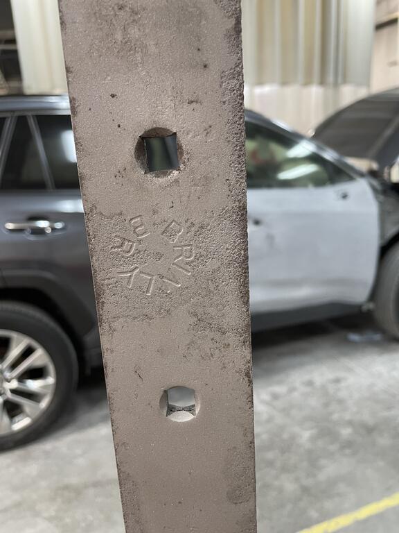

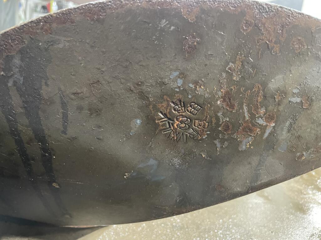

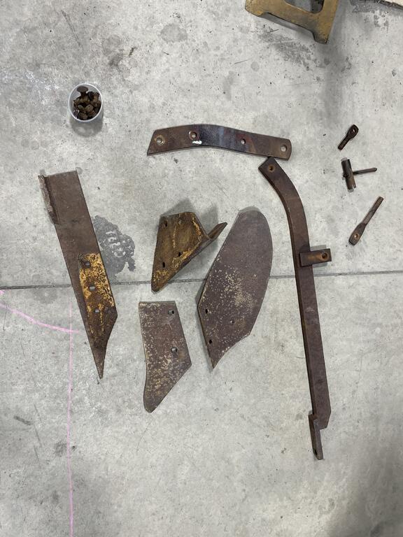

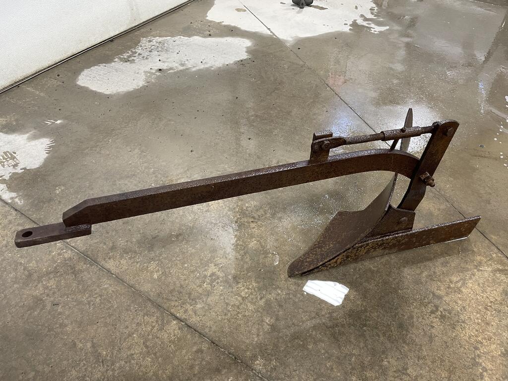

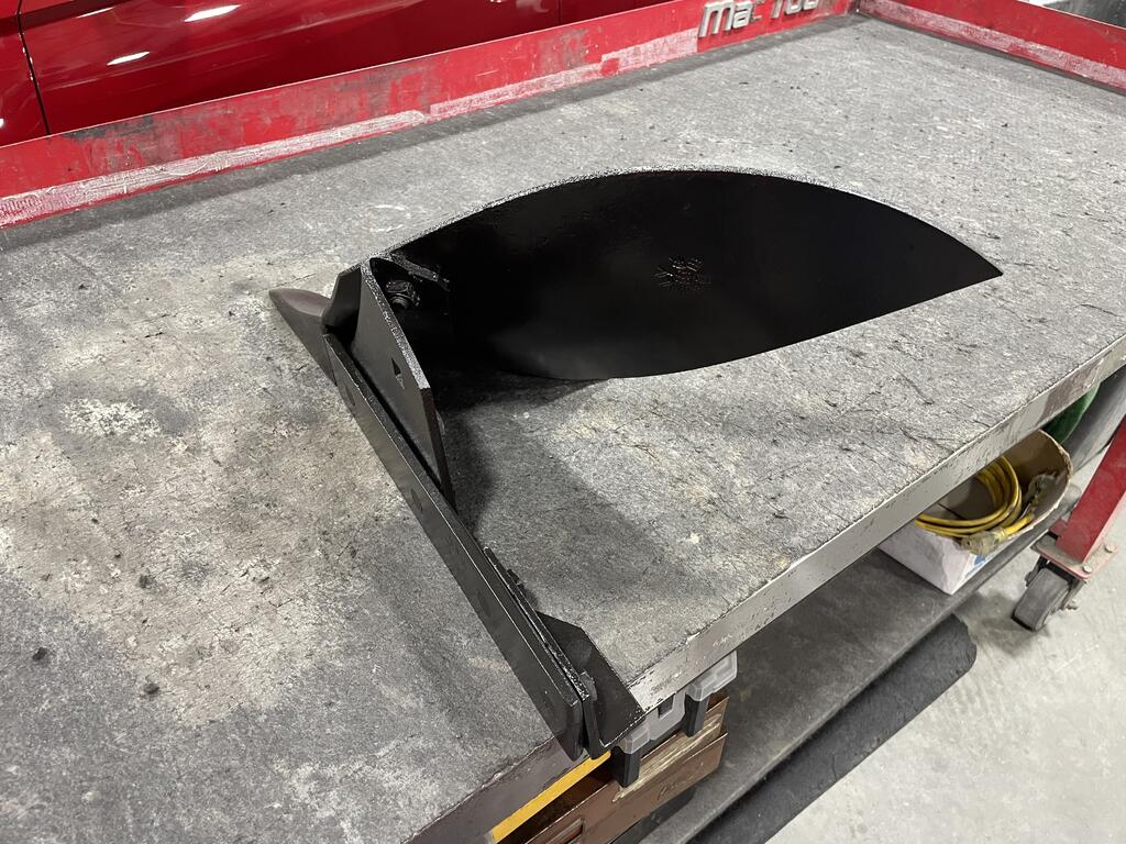

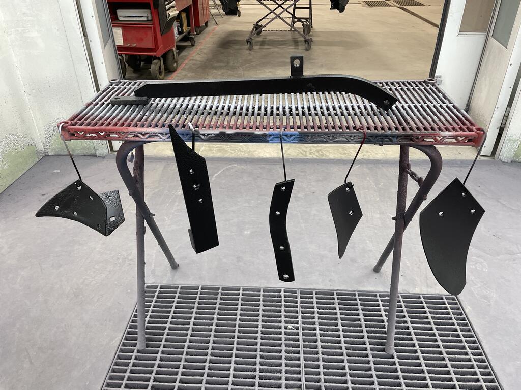

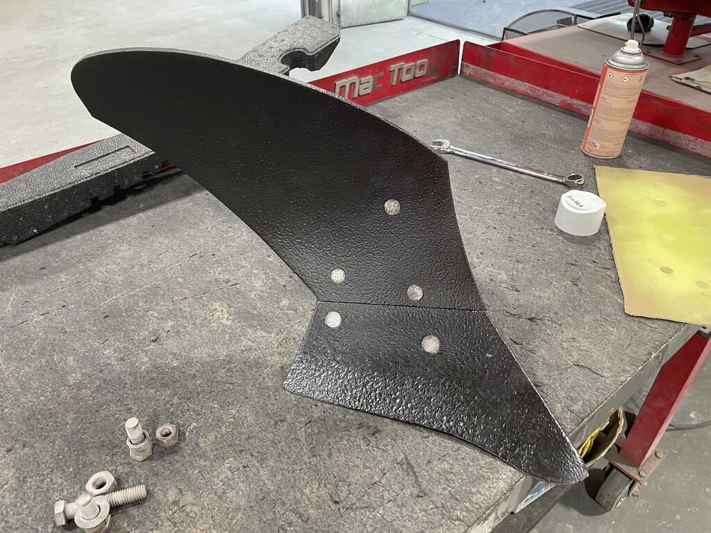

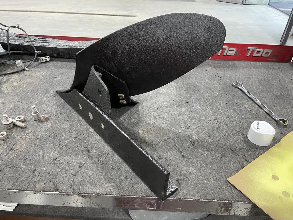

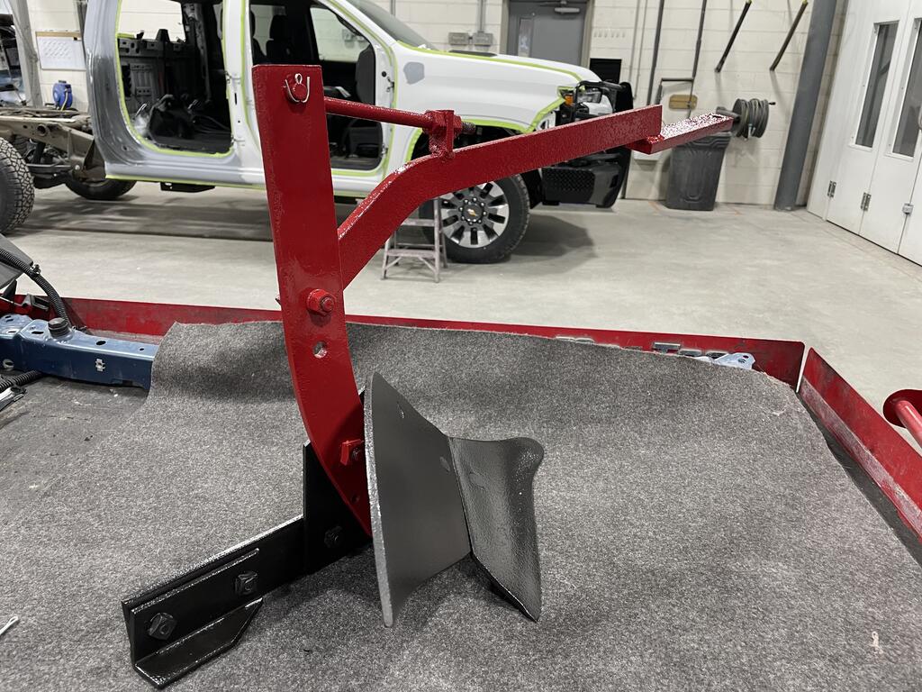

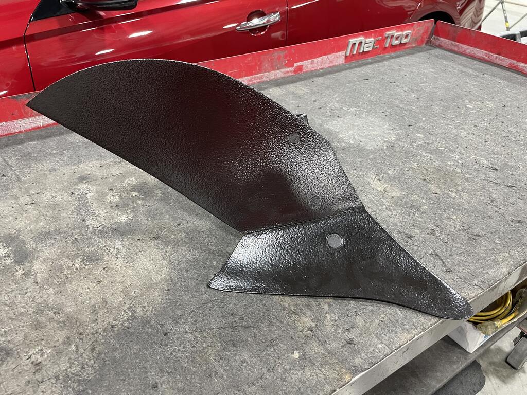

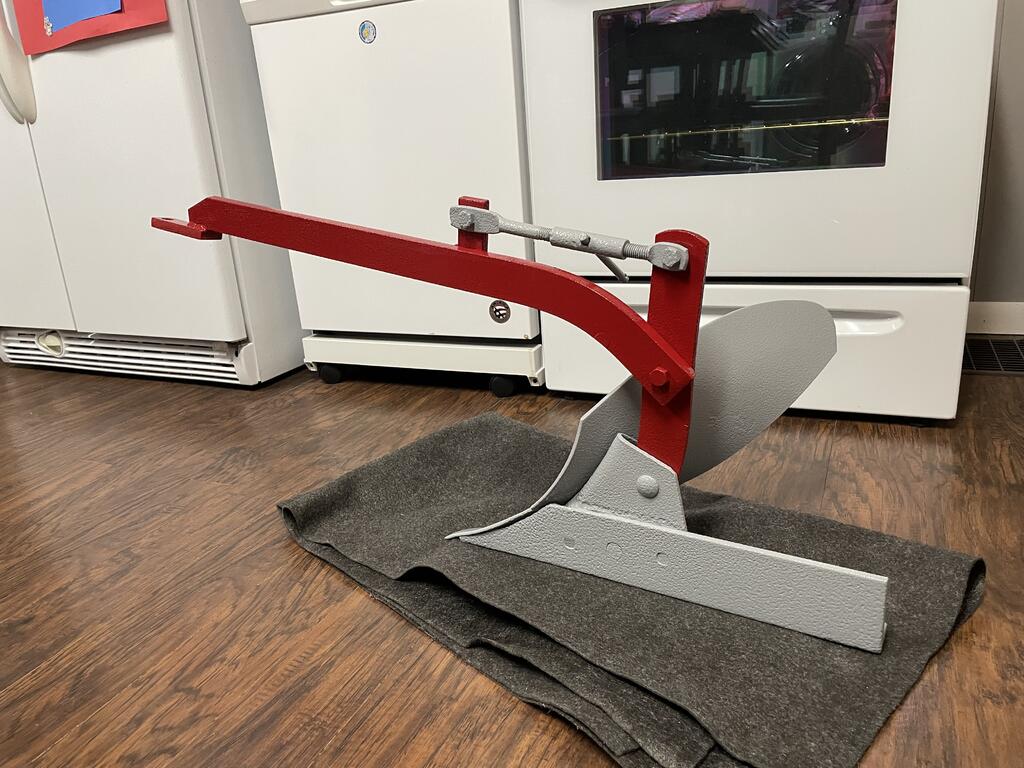

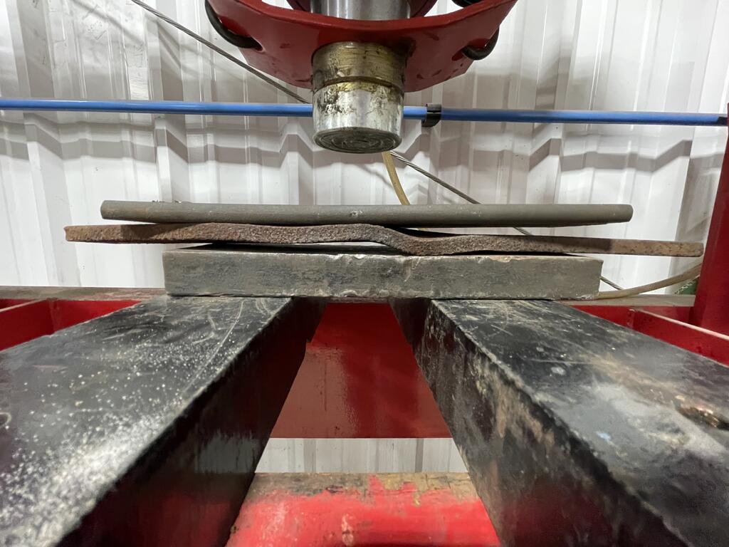

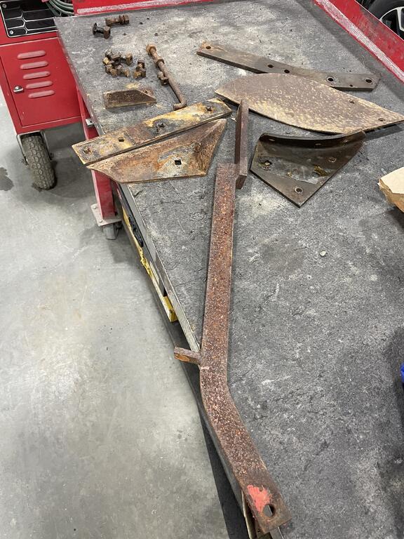

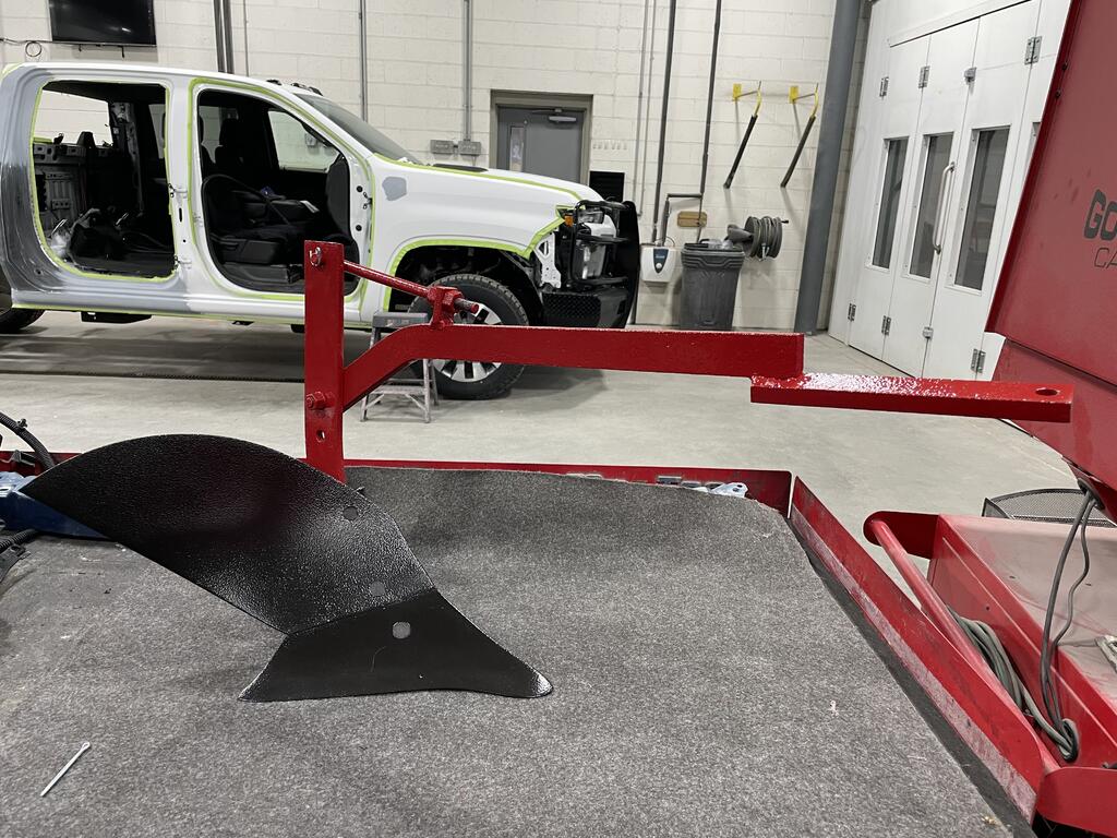

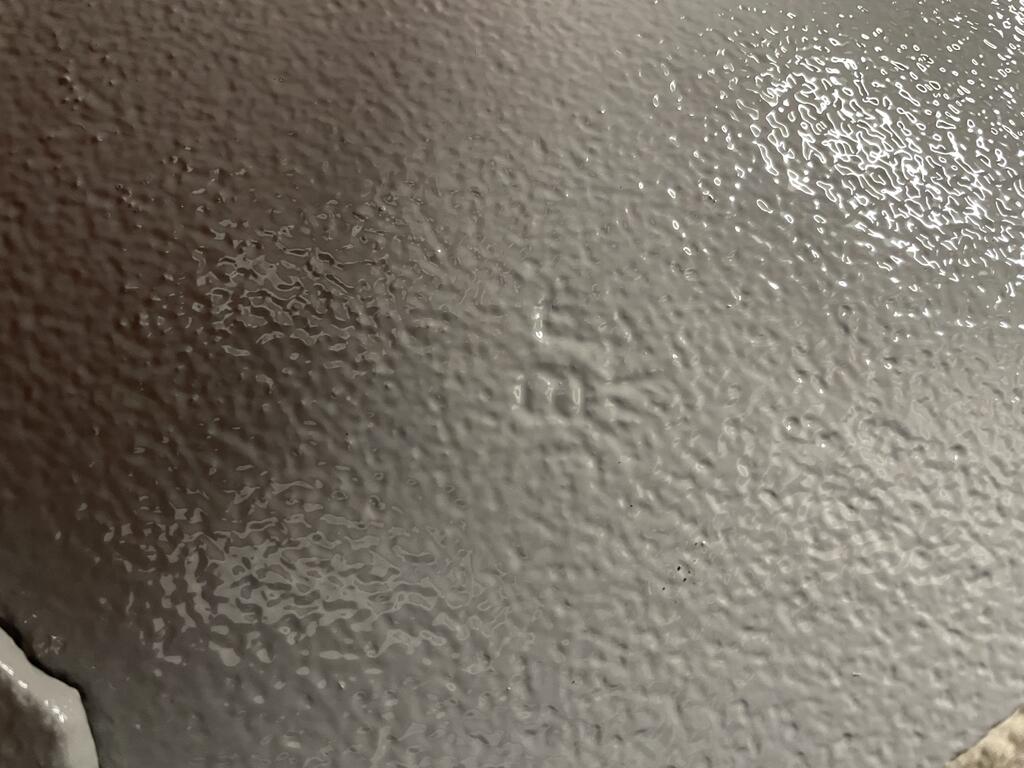

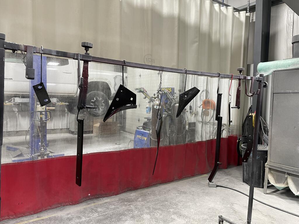

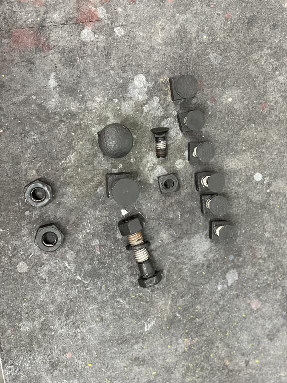

Sarthurs01 1,058 #1 Posted March 19, 2025 I decided to take and restore the two 8” plows I had, fun projects to keep the winter months moving along. To my surprise, every bolt came out without a problem! Sandblasted, epoxy primed, and painted they came out pretty good! 3 13 Share this post Link to post Share on other sites
953 nut 68,157 #2 Posted March 19, 2025 Coin collectors pay an arm and a leg for double struck coins, might be able to find some stupid money for this plow. 2 10 Share this post Link to post Share on other sites

Pullstart 71,005 #5 Posted March 19, 2025 They look great! If you plan to use them, the first thing you’ll likely want to do is grind off the paint on the plow surfaces, and wipe a little grease on them to keep rust at bay. Bare, shiny plows work better than painted ones. 3 Share this post Link to post Share on other sites
Sarthurs01 1,058 #6 Posted March 19, 2025 22 minutes ago, Pullstart said: They look great! If you plan to use them, the first thing you’ll likely want to do is grind off the paint on the plow surfaces, and wipe a little grease on them to keep rust at bay. Bare, shiny plows work better than painted ones. They are going on the backs of the RJs for show, I have a briny all polished up and ready for the Charger 12. 3 2 Share this post Link to post Share on other sites

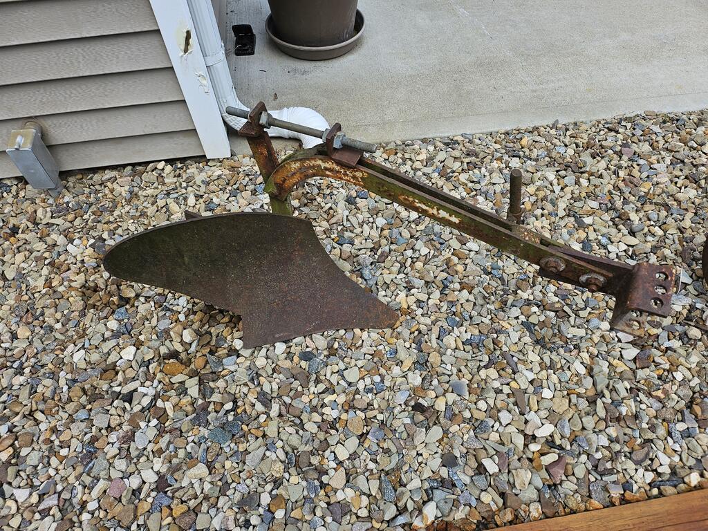

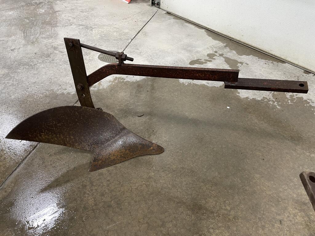

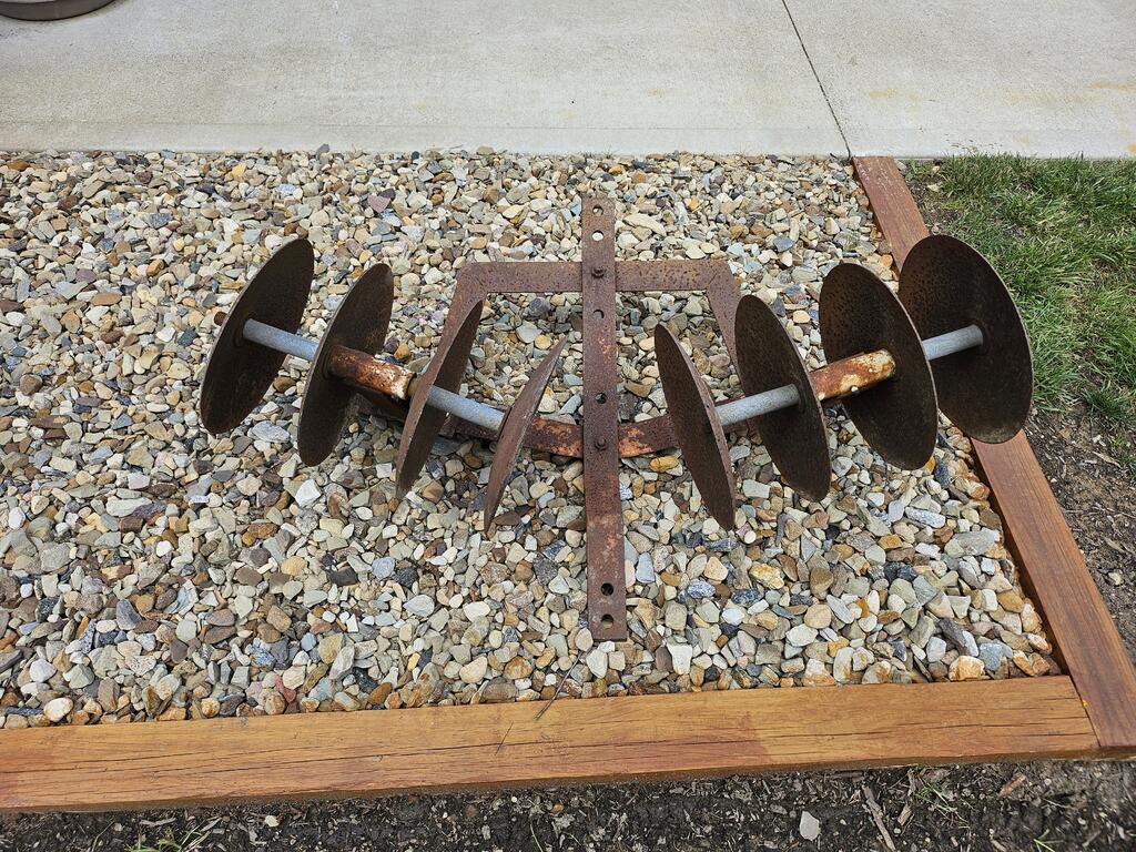

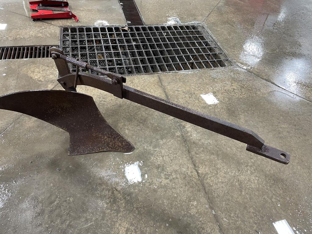

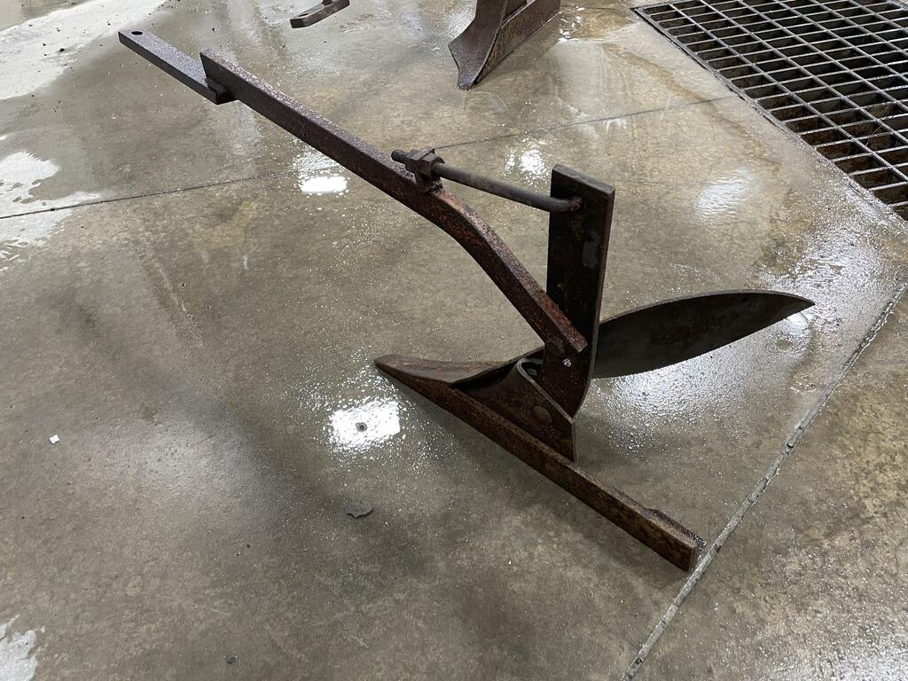

ML3 2,464 #8 Posted March 20, 2025 On 3/19/2025 at 8:36 AM, Sarthurs01 said: I decided to take and restore the two 8” plows I had, fun projects to keep the winter months moving along. To my surprise, every bolt came out without a problem! Sandblasted, epoxy primed, and painted they came out pretty good! Nice! Picked these up at a local show last summer- both for $40. Hoping to get them refinished this spring if time allows...... No use for them- just to hang back of my show tractors 3 1 Share this post Link to post Share on other sites

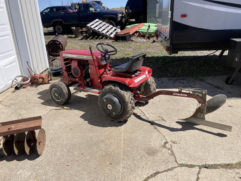

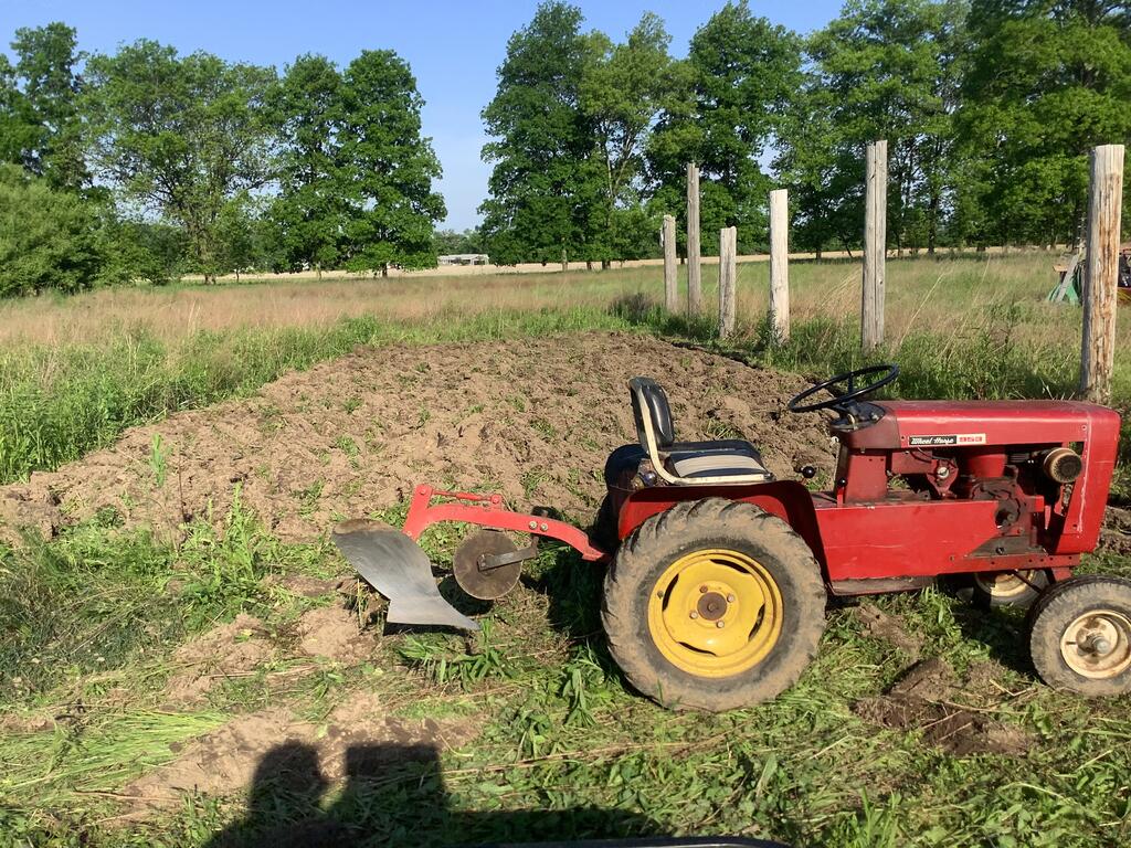

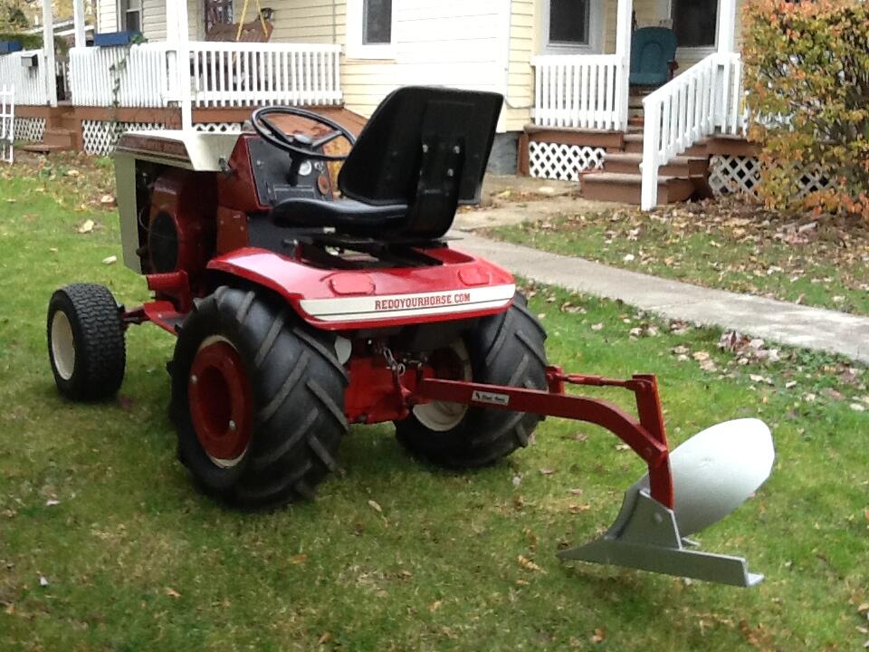

squonk 47,743 #9 Posted March 20, 2025 Redid this WH/Brinly 8 many moons ago. 1 3 Share this post Link to post Share on other sites

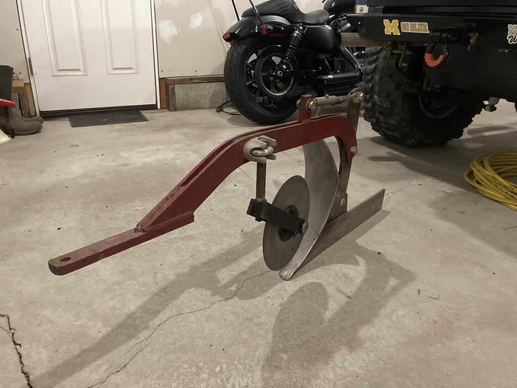

Blasterdad 3,167 #10 Posted March 20, 2025 I lucked out with this one, all I had to do to "restore" it was replace the shaft collar on the coulter & put a new sticker from Terry on it. 2 1 Share this post Link to post Share on other sites
