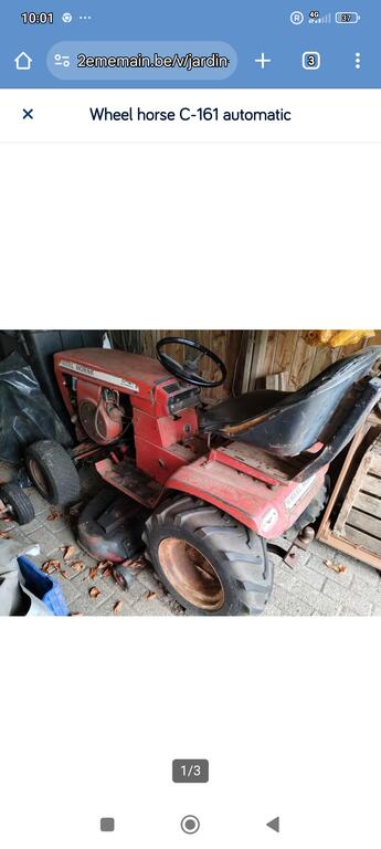

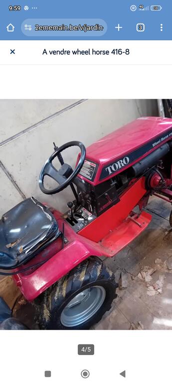

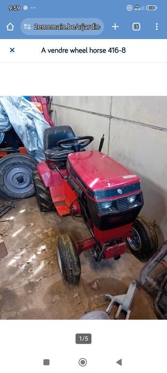

Gilou15 52 #1 Posted March 19, 2025 (edited) Salut les gars ! J'ai deux choix aujourd'hui : -Une 416 huit vitesses 1000€ (P216) - Une C161 Auto 1300€ (K341) Que pensez-vous de En France c'est rare et cher... Edited March 19, 2025 by Gilou15 1 Share this post Link to post Share on other sites
ebinmaine 80,743 #2 Posted March 19, 2025 Given the choice between the two I would choose the C160 as long as you're okay with hydros. That will be a great tractor with a great transmission and also a hydropowered lift mechanism. A 416 and a C160 are both great choices. 1 Share this post Link to post Share on other sites

953 nut 69,368 #4 Posted March 19, 2025 Hi guys! I have two choices today: - An eight-speed 416 for €1,000 (P216) - A C161 automatic for €1,300 (K341) What do you think of... In France, they're rare and expensive... In my opinion the 416 would be the better choice especially if it is a 1987 or 1988 which has the Kohler engine. The eight speed transaxle tends to be trouble free for much longer. À mon avis, le 416 serait le meilleur choix, surtout s'il s'agit d'un modèle de 1987 ou 1988 équipé du moteur Kohler. La boîte-pont à huit rapports offre généralement une durée de vie beaucoup plus longue. 1 Share this post Link to post Share on other sites

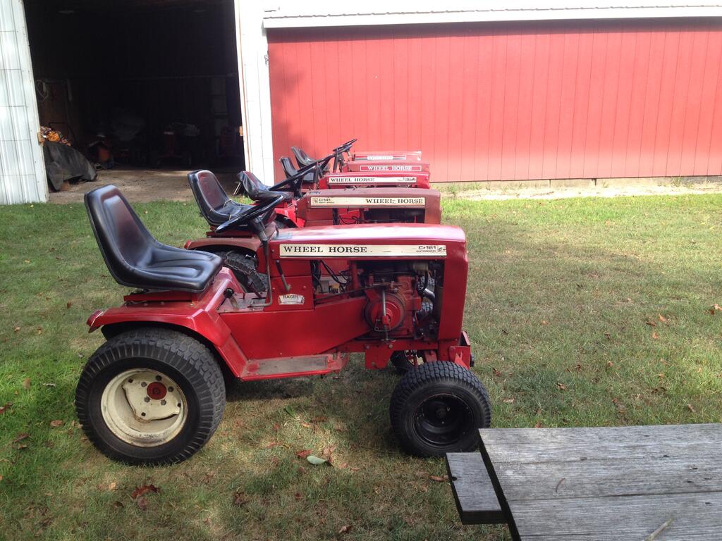

Blasterdad 3,168 #5 Posted March 19, 2025 6 minutes ago, 953 nut said: In my opinion the 416 would be the better choice especially if it is a 1987 or 1988 which has the Kohler engine. @Gilou15 The P216 is an Onan engine 10 minutes ago, 953 nut said: The eight speed transaxle tends to be trouble free for much longer. I have never had ANY problems with my Hydro Transmissions. I have that same tractor, it's a beast & one of my favorites. IMG_1786.MOV 1 1 Share this post Link to post Share on other sites
kpinnc 18,969 #6 Posted March 19, 2025 Go with the C-161. Onans are good engines, but can be fickle and repair parts are expensive if you find them at all. 1 1 1 Share this post Link to post Share on other sites
Gilou15 52 #7 Posted March 19, 2025 Thanks for all yours answers! It is a Toro power plus (Onan )on the 416 .... For the 161 : is there a difference with a 160 ? However,I would prefer Eaton than Sundstrand..and the diff 10 pinions is it reliable ..Is it really limited slip ?? Share this post Link to post Share on other sites

Gilou15 52 #12 Posted March 21, 2025 On 3/19/2025 at 11:42 AM, Blasterdad said: @Gilou15 The P216 is an Onan engine I have never had ANY problems with my Hydro Transmissions. I have that same tractor, it's a beast & one of my favorites. IMG_1786.MOV 251.39 MB · 1 download Wonderful collection !! Share this post Link to post Share on other sites
