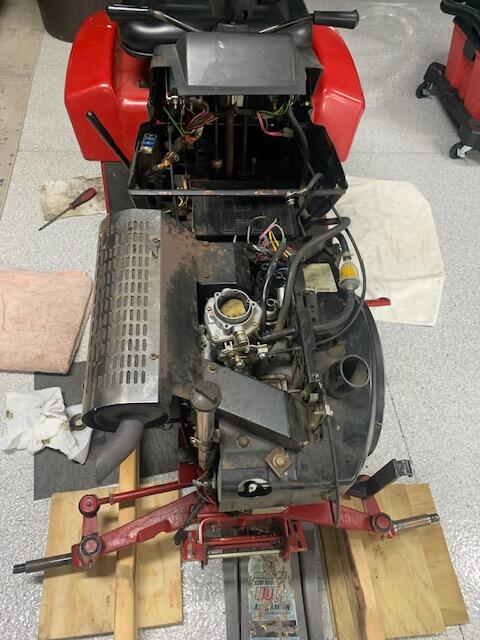

Thetbone 61 #26 Posted April 15, 2025 Testing the fuel pump, how is that done? Share this post Link to post Share on other sites

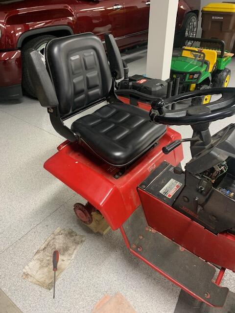

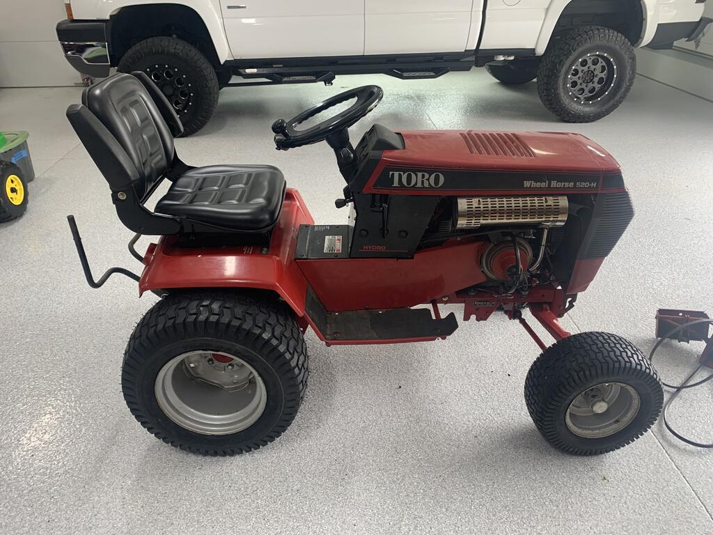

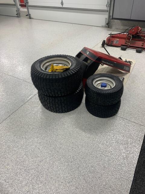

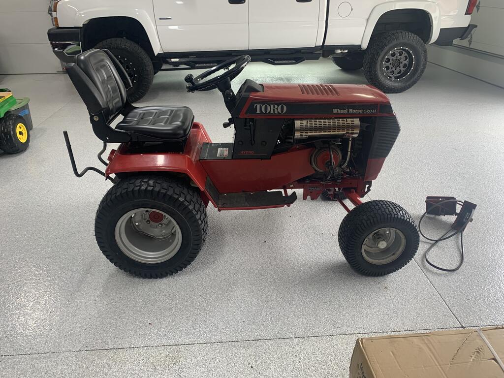

Thetbone 61 #27 Posted April 22, 2025 UPDATE: I ran out of time to accomplish what I planned for the work I wanted to do, so I will regroup this Fall and get after it quicker! Lessons learned. I did however get some new rubber for the Wheelhorse, got the seat back on, the right way, damn seats can be tricky!!! Got her cleaned up pretty good as well. 1 Share this post Link to post Share on other sites
Thetbone 61 #28 Posted April 22, 2025 I want to thank Squonk for getting me the Spark Plug wires, that was a lifesaver. 1 Share this post Link to post Share on other sites
953 nut 70,656 #29 Posted April 23, 2025 On 4/15/2025 at 4:41 PM, Thetbone said: Testing the fuel pump, how is that done? Your fuel pump is probably a vacuum operated pump. As the pistons move in and out the crank case pressure will change making the diaphragm move. If you are mechanically inclined (and brave) enough you could use a vacuum hose from a car or truck to check the diaphragm applying and removing vacuum to test the pumping action. No vacuum should leak out while doing this. To test the two check valves you should be able to blow low pressure air or some spray carburetor cleaner from the suction side to the discharge side but nothing should be able to pass from the discharge side to the suction. Share this post Link to post Share on other sites

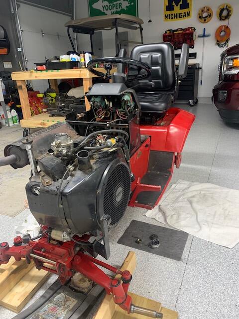

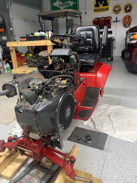

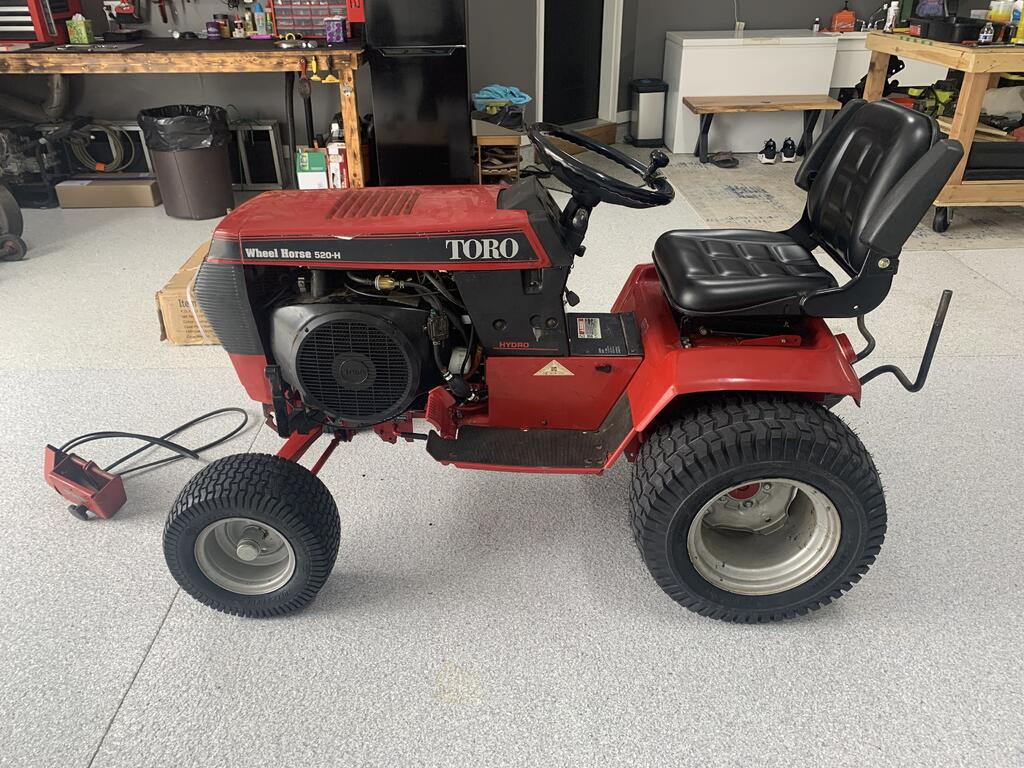

Thetbone 61 #30 Posted April 27, 2025 Put her back together until Fall. 2 2 Share this post Link to post Share on other sites
WHX?? 58,388 #31 Posted April 27, 2025 (edited) Epoxy floor Bone? We were just yaking about those. Yours looks nice. Edited April 27, 2025 by WHX?? link 1 Share this post Link to post Share on other sites
Thetbone 61 #32 Posted April 28, 2025 Yes, we did it at the end of the build of the house, it's the best!! 1 Share this post Link to post Share on other sites
