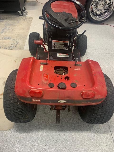

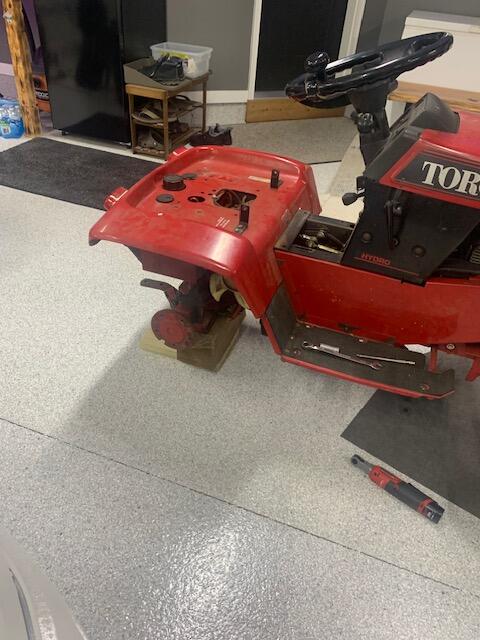

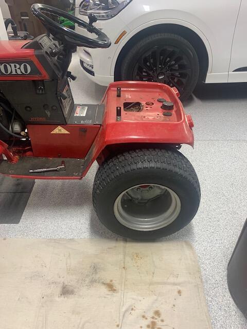

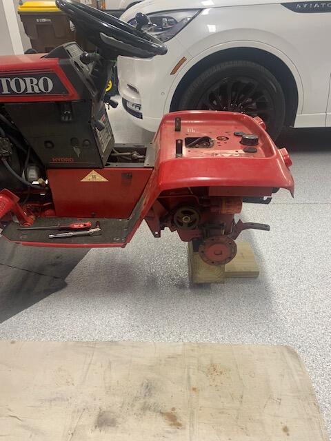

Thetbone 61 #10 Posted March 23, 2025 And it begins... 4 1 Share this post Link to post Share on other sites
Thetbone 61 #11 Posted March 23, 2025 I am learning as I go, can't call this a total restoration, more like clean, re-paint as needed, replace as needed. 5 Share this post Link to post Share on other sites
Thetbone 61 #12 Posted March 23, 2025 I'm not a big picture taker, I will do my best! Had minor surgery so I won't have progress until next weekend. I will need a newer hood, any suggestions on where to find that? I have searched Ebay but not much. 2 Share this post Link to post Share on other sites

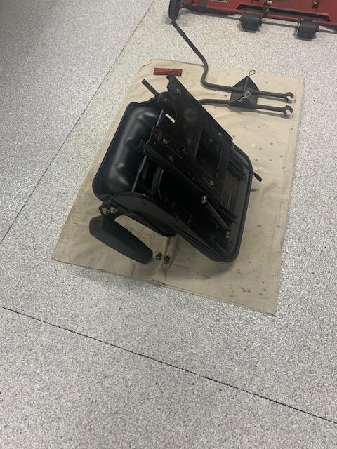

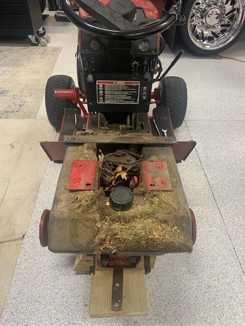

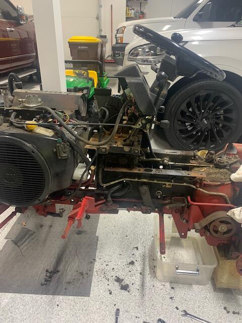

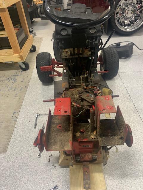

Thetbone 61 #20 Posted March 31, 2025 Pulled some more of the metal off. 2 Share this post Link to post Share on other sites
Thetbone 61 #21 Posted March 31, 2025 Unfortunately I am running out of time, this is what I use to mow my yard, 1 acre. I think my goal is to clean everything, not repaint items. I'll clean all the nuts and bolts good, replace as needed. What I do need is to fix the seat and figure out why the tractor has a hard time starting. 2 Share this post Link to post Share on other sites

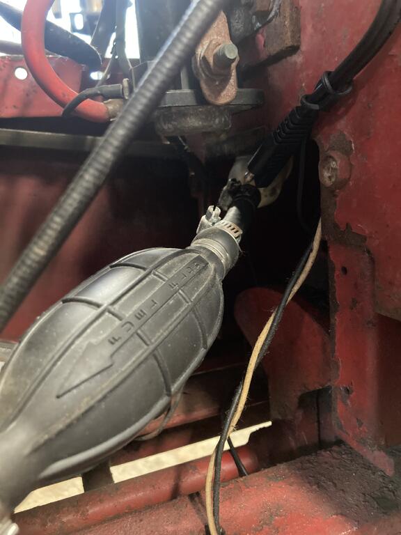

SylvanLakeWH 32,541 #23 Posted March 31, 2025 I put a marine primer bulb on my C-105 to help with starting. A couple squeezes and it fires right up... just a thought... 4 Share this post Link to post Share on other sites
ebinmaine 80,741 #24 Posted March 31, 2025 6 minutes ago, SylvanLakeWH said: I put a marine primer bulb on my C-105 to help with starting. A couple squeezes and it fires right up... just a thought... Definitely recommended. 1 hour ago, Thetbone said: why the tractor has a hard time starting. I'm no Onan expert. At the very least do: New spark plugs. ALL new fuel line New filter(s) Primer bulb Clean out carb (rebuild?) Carefully check intake manifold for vacuum leaks. Carefully check fuel pump for proper operation. Remove and clean out tank. 2 Share this post Link to post Share on other sites
