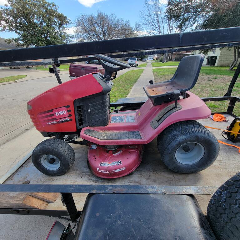

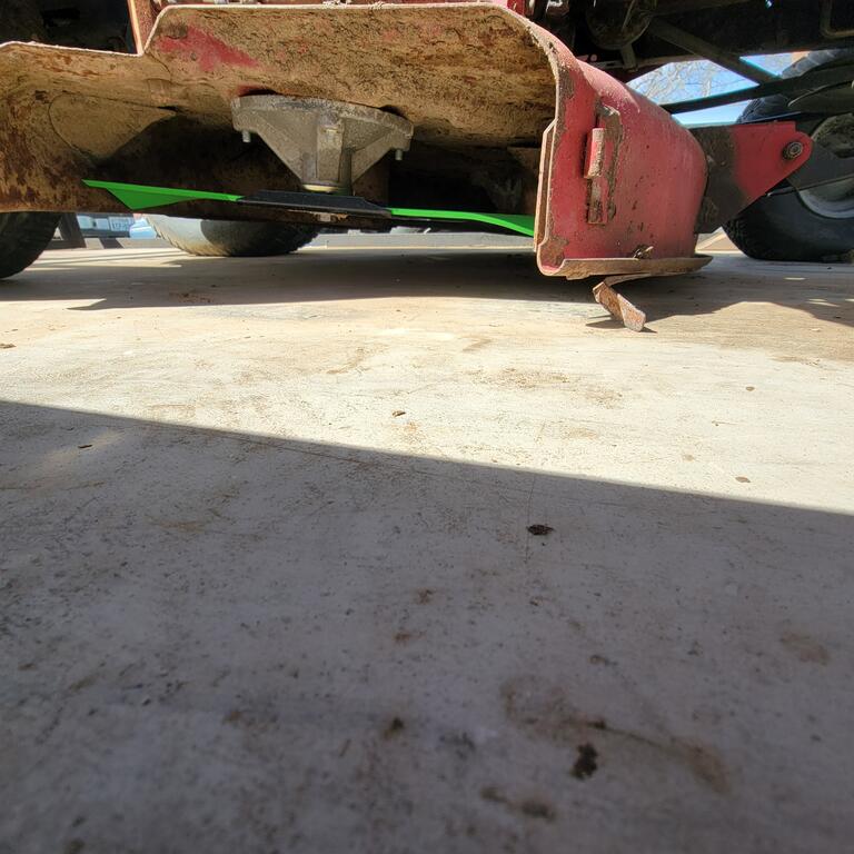

Carver 9 #1 Posted March 18, 2025 This mower is new to me and the young man I bought it from said his father had the deck off for many years using it to pull the grandkids around in wagons. He acquired from dad it and re-installed the deck along with new belts and blades. (Blades were pretty bright green and installed upside down). He told me it runs ( turns out it runs great ! ) but when you start to engage the PTO the engine dies. I have a TORO Bronco that will not allow you to engage the blades if in reverse. When the engine dies, it sounds like it is losing spark at the moment you move the lever up at all. I am suspecting this mower has the same shut-off switch and it is faulty. The gearshift says neutral but the mower dies just as quick even if I put the gearshift in forward. If this is in fact the case, can anyone give me a hint of where the reverse lockout switch might be located? I would also appreciate any alternative possible causes that might cause the motor to shut down so quickly when the PTO is engaged. Thanks in advance, Phill Share this post Link to post Share on other sites

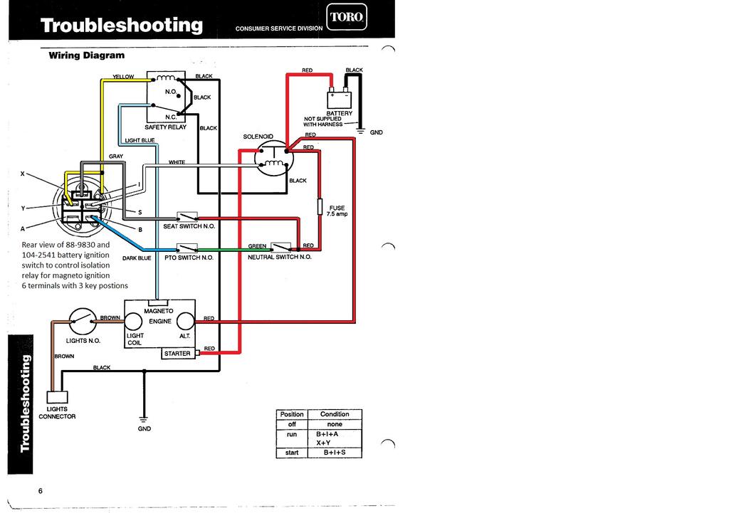

953 nut 69,366 #4 Posted March 18, 2025 I also would suspect the sear switch or the wiring to it being the cause of your shut down. The attached Owner Manual has a wiring diagram on page 20. The Demystification Guide breaks the wiring down by function. on page 8 it shows the "Spark Circuit Ignition Switch In RUN" which is where you are experiencing the problem. When you activate the PTO and the seat switch is not made up the ignition will shut off. Check the seat switch and wiring going to it. The switch may be in the seat padding itself. Share this post Link to post Share on other sites

gwest_ca-(File Mod) 12,488 #8 Posted March 18, 2025 The tractor is a 1995 model - the first 2 digits of the serial reversed. This wiring diagram can be a head scratcher. Not what I expected to see. Share this post Link to post Share on other sites
Ed Kennell 47,374 #9 Posted March 18, 2025 55 minutes ago, gwest_ca said: This wiring diagram can be a head scratcher. I bet the electrical engineer that designed this was really surprised it even worked. 1 Share this post Link to post Share on other sites
gwest_ca-(File Mod) 12,488 #10 Posted March 18, 2025 Toro shows 4 switches and they are all on this diagram https://www.partstree.com/models/71184-12-38-xl-toro-lawn-tractor-sn-059010001-059999999-1995/electrical-assembly-3/ The detailed diagrams show a "Brake switch" but no brake switch on the above wiring diagram. Perhaps it should be a "Neutral switch"? 1 Share this post Link to post Share on other sites
gwest_ca-(File Mod) 12,488 #11 Posted March 19, 2025 The seat switch can not be working to power the ignition switch X terminal which passes the voltage to the Y terminal with the ignition in the RUN position. Why? - because the other power source through the pto switch must be working or it would not start. The relay is OK because the tractor runs. It is possible the ignition switch has failed to make the XY connection in the RUN position. In any case that yellow wire needs voltage to open the relay contacts so the magneto is not grounded. Switch function is described in the XL service manual starting on page 5-4. There is a link to it farther up. I made some minor changes to the colored wiring diagram above. Share this post Link to post Share on other sites

Carver 9 #13 Posted March 19, 2025 (edited) With all the gracious help of this group, my $50 bargain is running and the blades will spin up now. My Old 42"Bronco is running again and will remain my main mower, but I am going to keep going on this one. I printed the manual and the electrical schematic and they have proven invaluable. As you can see from the pics, I have more than a little cosmetic work to do as well as a battery and tires ( the ties hold air fine, but are ancient and thoroughly dry-rotted ). Now that I know the basics are workable, I will surely find a lot of parts that I will need to replace as the budget and time allows. As I am an extreme newbie in this repair/restoration effort I am just shooting in the dark trying to locate various parts for this. Any advice on potential suppliers would certainly be appreciated. I am located near Dallas, Texas for reference, but not at all adverse to online purchases. I moved the deck questions to the restoration forum. Thanks again for all the help , Phill Edited March 20, 2025 by Carver moved deck question to teh restoration forum 1 Share this post Link to post Share on other sites
