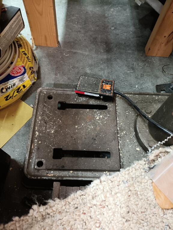

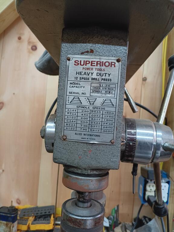

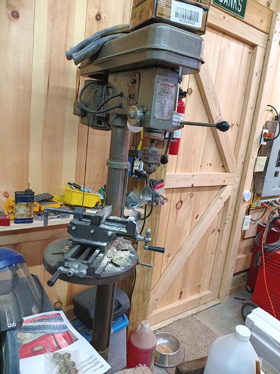

ebinmaine 81,282 #7 Posted March 16, 2025 1 hour ago, WHX?? said: Starting with the only label I am aware of, and then down the sides. Last pic is of course the foot on the floor. 2 Share this post Link to post Share on other sites
Wayne0 1,666 #8 Posted March 16, 2025 Looks like a re labeled Jet. 1 Share this post Link to post Share on other sites

lynnmor 9,081 #13 Posted March 16, 2025 It shows a Morse taper #2 on the name plate. Hopefully the video showed how to pop the chuck out using a wedge. Once out, check the inside of the taper and the run-out in there, it is time to invest in a cheap dial indicator. What you have is a cheap drill press made in Taiwan where numerous brands of the same design were produced. Those cheap chucks often should be replaced with a Jacobs and the taper adapter can be suspect as well, your newly acquired dial indicator will show what needs replaced. Yes, I have a cheap drill press similar to yours but it at least has a down stop to control drill depth. I used an indicator to tram the table and found it way out, so I cut it on the mill to bring it in to a reasonable tolerance. 1 Share this post Link to post Share on other sites

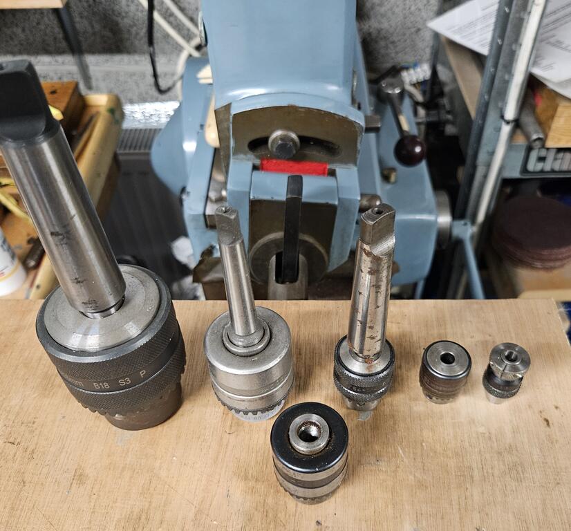

Mickwhitt 5,259 #16 Posted March 16, 2025 So. A bit of information about drill chucks in my workshop. This is a range of chucks, the first three left to right are mounted on morse taper shanks. From morse 4 on the left, then morse 1 then morse 2. They are all stub mounted on Jacobs tapers. The two chucks on the right show the tapered hole for the stub taper. The smallest of these chucks is a high precision Albrecht and worth about £400. The one on its own is a threaded body to go on a screw arbor. Engineering chucks like your machine are most usually morse or Jacobs stub tapers. This photo shows a couple of taper shank drill bits, which are great if your drill press has a morse taper quill. You just tap the drill into the quill and your good to go, very accurate with no slipping. The larger item is actually a series of morse taper adaptors young down from morse 4 to morse 0. You'd never need to nest all together like that but it demonstrates that tapers can be accommodated in different machines. My lathe has a morse 5 taper in the headstock which is pretty big. This shot shshot and arbor which is M 2 into the drill and Jacobs 3 into the chuck. The U shaped flat metal pieces are tapered wedges to drive a Jacobs taper off. You tap them towards each other and the tapers do the work. The taper shank drill is fitted into a parallel shank adaptor, so you can use a taper bit in a parallel jaw chuck. Next to it is the taper drift used to eject the tapered bit from the socket. The drift is tapped into the slot and ejects the drill, or chuck. This is the morse 3 quill of my pillar drill. You can see the slot in the extended quill that tell you it's a morse quill. No slot it will be a stub arbor you will need a pair of taper drifts to remove. This drill press is a beauty as it has an auto eject mechanism which pops the morse taper out of the quill without a drift. Lastly this is a quick change M1 tool holder for my lathe tailstock. There is no ejector slot and so the threaded widget is screwed in to push the taper out from behind. So there are a lot of permutations on morse tapers. if its a screw chuck be aware that the thread could be left or right hand. Most of the handle drills I have are right hand with a screw securing the chuck to the threaded shank down behind the jaws. But some are left hand with no securing screw, usually on drills that are none reversing. To remove a threaded chuck it's a case of putting the chuck key into one of the holes and tapping it sharply with a mallet to shock it loose. Not easy if you don't know if it's right or kept hand thread. 2 Share this post Link to post Share on other sites

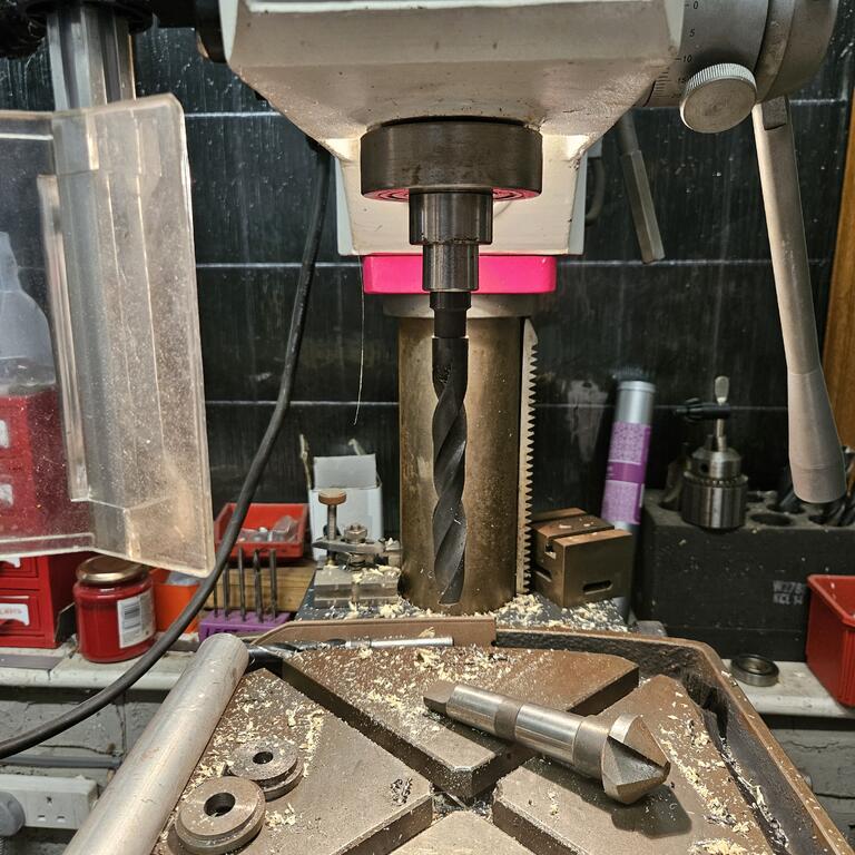

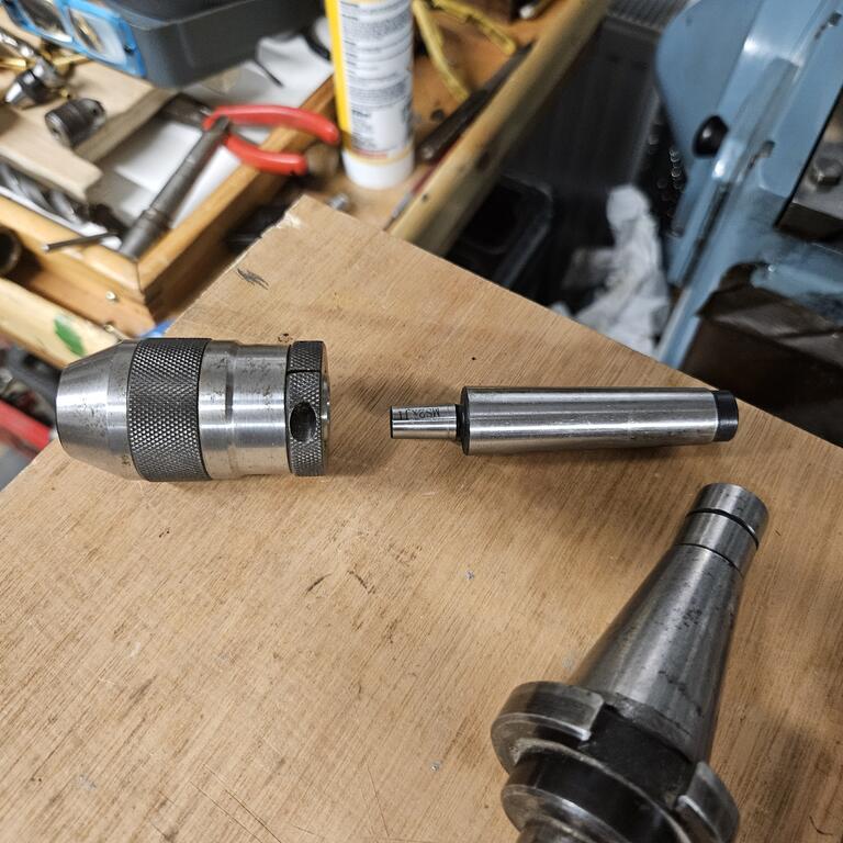

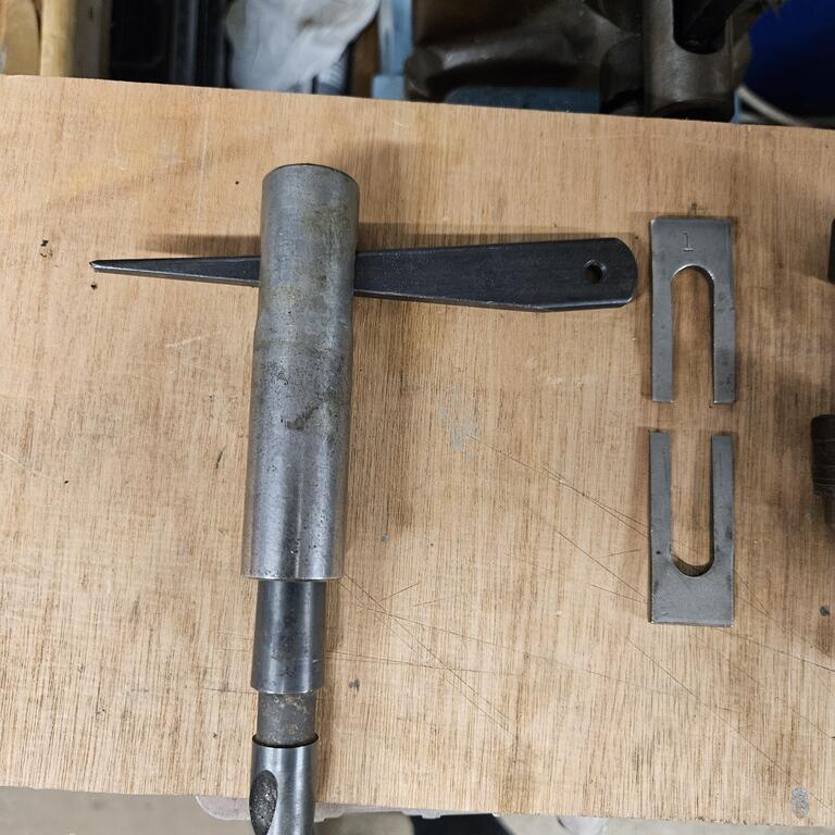

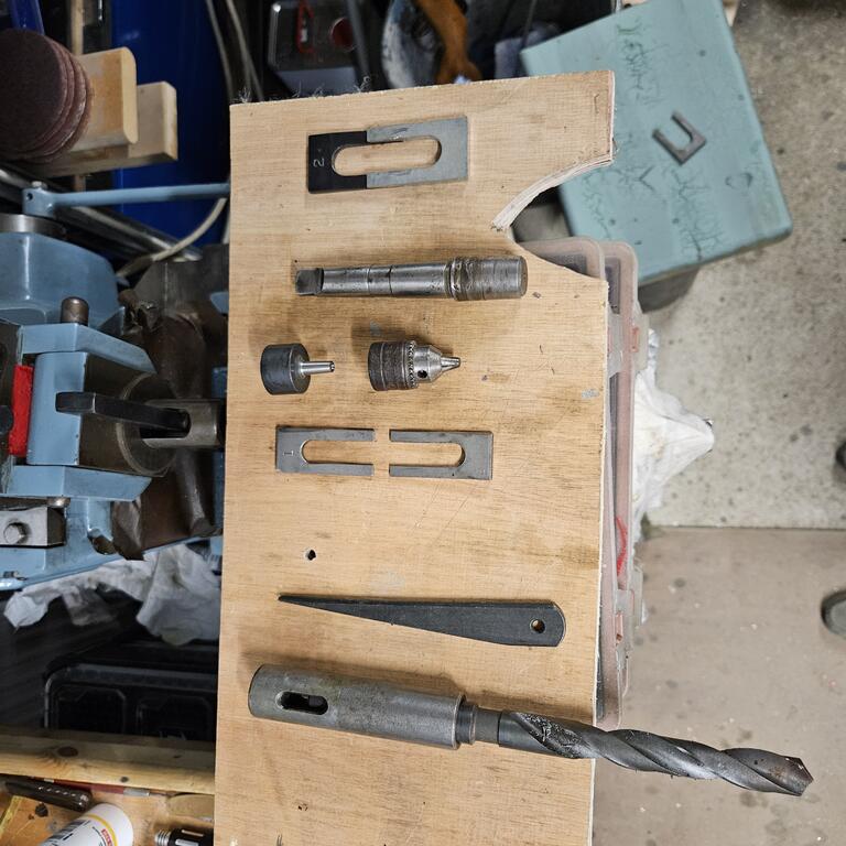

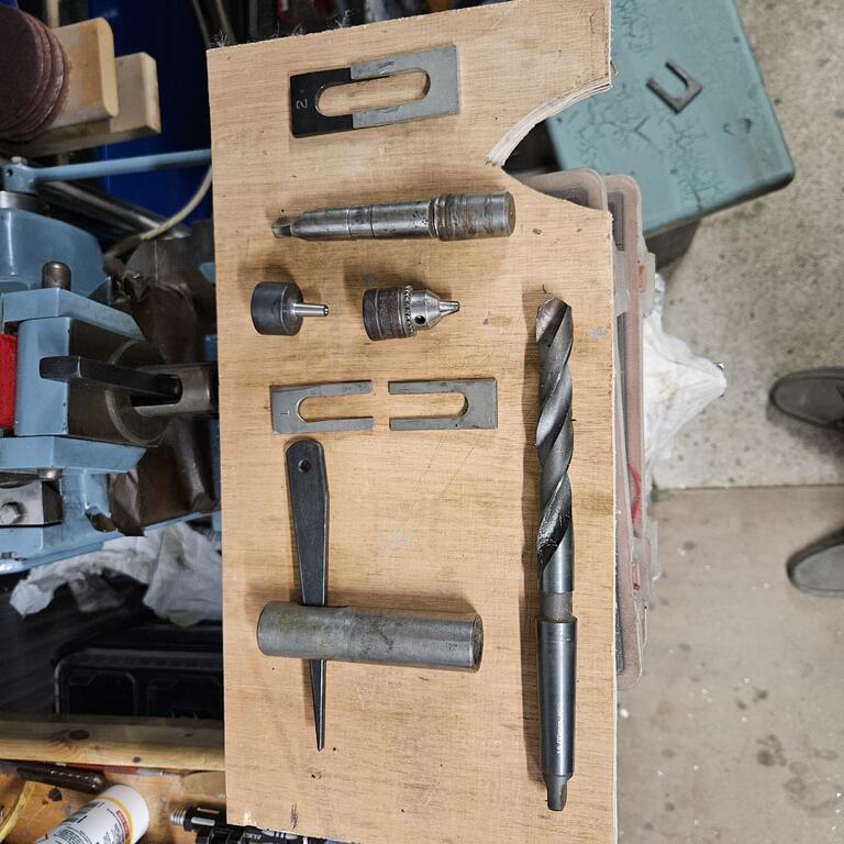

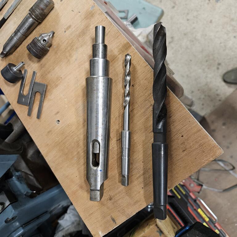

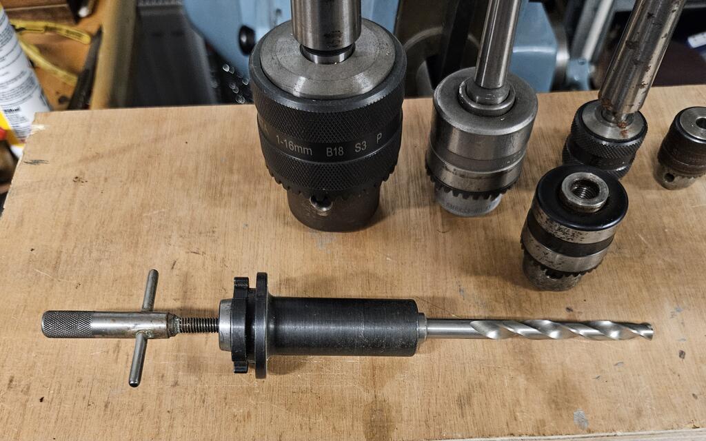

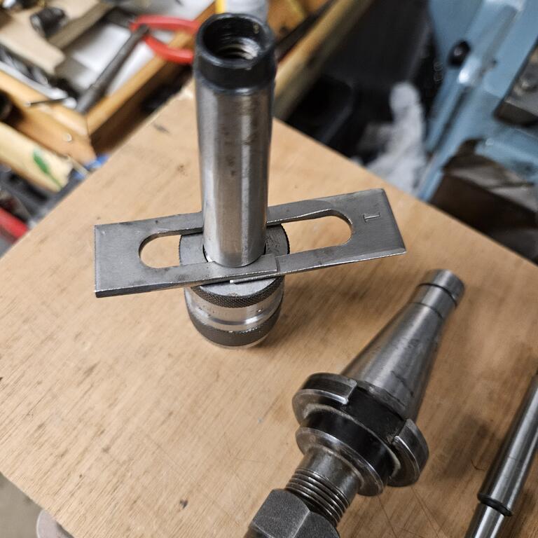

Mickwhitt 5,259 #17 Posted March 16, 2025 As an addendum to my previous musings... A few pics to illustrate some of the things I mentioned. This is a large M2 drill bit in my M3 pillar drill using an adaptor sleeve. This is a M3 x 40mm countersink bit in the same machine. Here are some more bits and bobs. The odd looking chuck in the centre is a 30 International taper with a collet drill chuck that fits in my jig boring machine. To the left of it is a stub arbor mounted chuck with the taper wedges set in place to drive the chuck off. Tother two bits are M1 and parallel stub arbors. That's the chuck above parted from the stub arbor. BE AWARE, if the chuck has frozen onto the arbor I have seen people have to machine the chuck off destroying it completely. Not something to worry about with a morse type arbor but if it's the drill spindle type then the chuck literally has to be cut off. If it were my drill press I'd find out what type of quill it was and change the chuck for a quality brand one as a starting point. It does say #M2 on the plate so it's odds on to have a slot for a drift in the quill when you lower it down. Let me know how you get on. Mick 1 1 Share this post Link to post Share on other sites

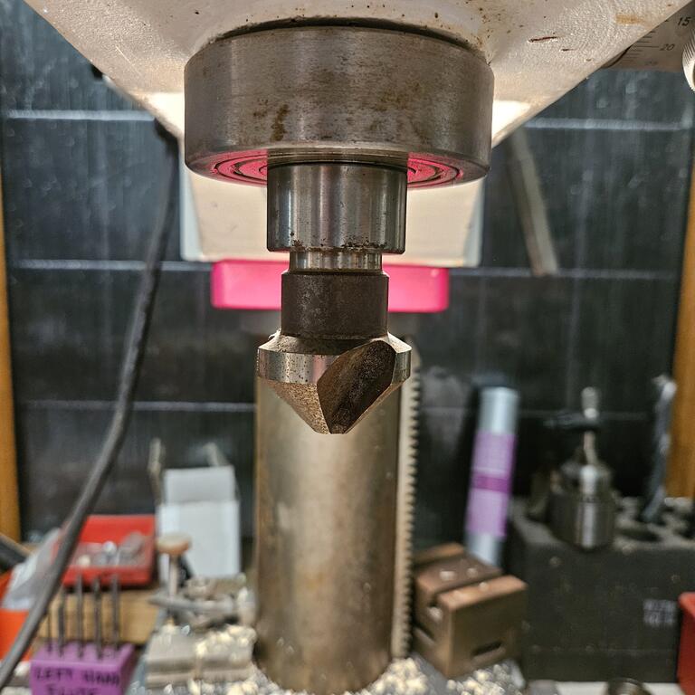

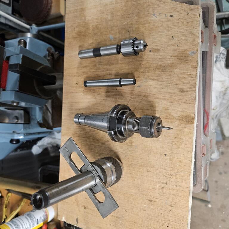

ebinmaine 81,282 #18 Posted March 17, 2025 8 hours ago, lynnmor said: it is time to invest in a cheap dial indicator Turns out I have one here. Magnet mount too. It'll be a bit before I can check the runout. The Trina momma and her apartment is priority one for a couple weeks. Share this post Link to post Share on other sites
