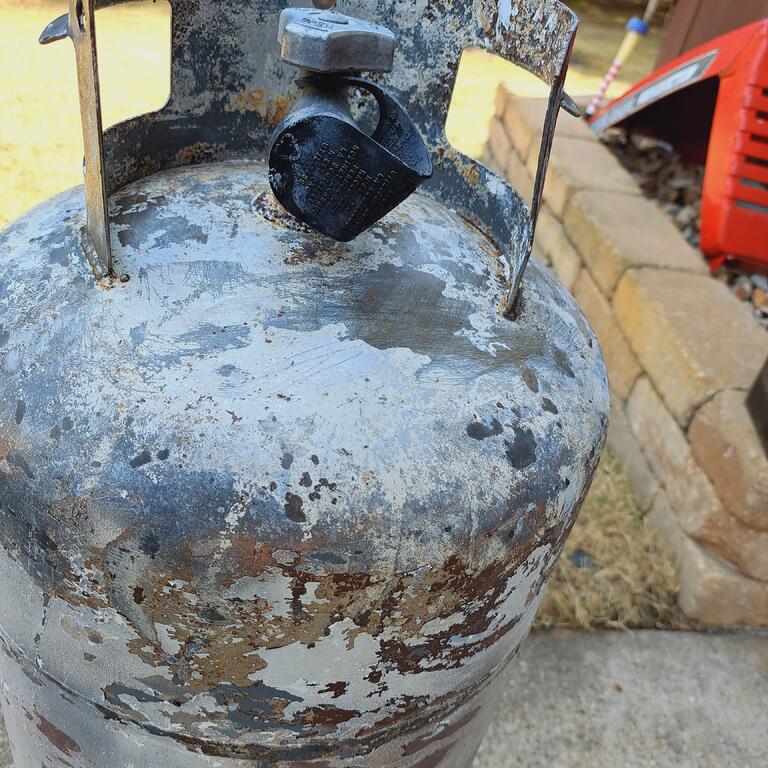

WHX?? 57,642 #16 Posted March 14, 2025 1 hour ago, Wayne0 said: Best paint stripper I ever used was "BIX". Using this on a lp tank. Works ... kinda. Lots of scrubbing & wire brushing. Ways to go yet. Share this post Link to post Share on other sites
Wayne0 1,609 #17 Posted March 14, 2025 2 hours ago, WHX?? said: Using this on a lp tank. Works ... kinda. Lots of scrubbing & wire brushing. Ways to go yet. Probably a newer formula, not as nasty. Mine's about 20 years old! 1 Share this post Link to post Share on other sites
