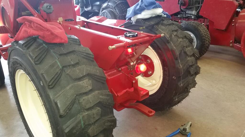

WHX?? 58,388 #5 Posted March 11, 2025 (edited) 9 minutes ago, dmoore said: used when tractors were new What Dan showed. Just guessing a draw bar was also a desirable option in the day since there is a ton of them out there. I like to run a regular draw bar and a sleeve. In our business we seldom use a sleeve except on plow mules. Edited March 11, 2025 by WHX?? 1 3 Share this post Link to post Share on other sites

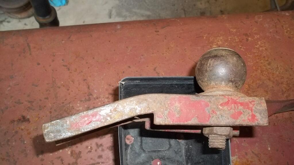

953 nut 70,656 #9 Posted March 11, 2025 I have cut down one end of a scrap piece of 2" channel iron and bent it to allow a hitch with a ball to ride a bit higher using the sleeve hitch in the up position. 7 1 Share this post Link to post Share on other sites

Handy Don 17,735 #11 Posted March 11, 2025 2 hours ago, 953 nut said: I have cut down one end of a scrap piece of 2" channel iron and bent it to allow a hitch with a ball to ride a bit higher using the sleeve hitch in the up position. This one is on my 854 as I type! 😉 When putting a ball on a slot or clevis hitch it is good to remember that trailer forces can lift the hitch unexpectedly. Also, having a lifted blower or dozer blade while also putting a trailer on the hitch puts the weight of both implements onto the center rock shaft and, for non-hydros, on the lift lever latch. 2 Share this post Link to post Share on other sites

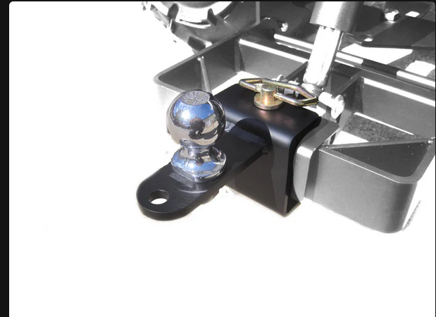

sergeant 350 #12 Posted March 11, 2025 (edited) Here is what I use On any of My sleeves: integral hitch and clevis hitch, whatever the Manufacturer calls it. https://johnnyproducts.com/products/generic-multi-tongue-to-sleeve-hitch-towing-adaptor-attaches-to-any-sleeve-hitch-on-your-tractor-fits-elitewill-nixface-nubehone-craftsman-cub-cadet-and-other-sleeve-hitches-black Do You have a slot Hitch or clevis Hitch ? If You Just have the slot Hitch add this https://wheelhorsepartsandmore.com/product/toro-wheel-horse-slot-hitch-adapter/ Plus John's adapter Edited March 11, 2025 by sergeant 2 Share this post Link to post Share on other sites

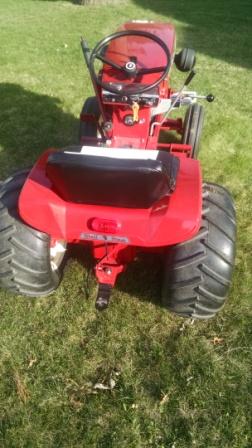

squonk 48,427 #14 Posted March 11, 2025 Always have both style hitches on the rear. Cheap and flexible. Then add a front mount for trailer moving! 2 Share this post Link to post Share on other sites

WHX?? 58,388 #16 Posted March 13, 2025 Most times yes. If a sleeve hitch was not used there were two spacers involved to take up the space of the sleeve. 1 Share this post Link to post Share on other sites

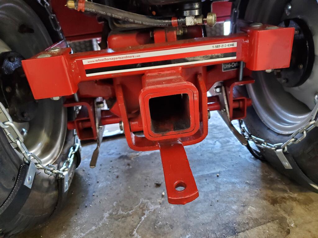

Racinbob 13,290 #17 Posted March 14, 2025 For many years I used the 2"x1/2" bar stock in the slot hitch. I had an extra hole drilled in it and ran a bolt through it and the drawbar hitch. In addition to the usual smaller trailers I would pull a 30' travel trailer in and out of the pole barn. To keep the front end down I had to mount the snowblower. I always had the tongue jack fairly close to the ground just in case but surprisingly never broke the cable. That set-up has been retired since I latched on to two of Lowells receiver hitches. 1 Share this post Link to post Share on other sites
WHX?? 58,388 #18 Posted March 14, 2025 Nice chains Bob Share this post Link to post Share on other sites

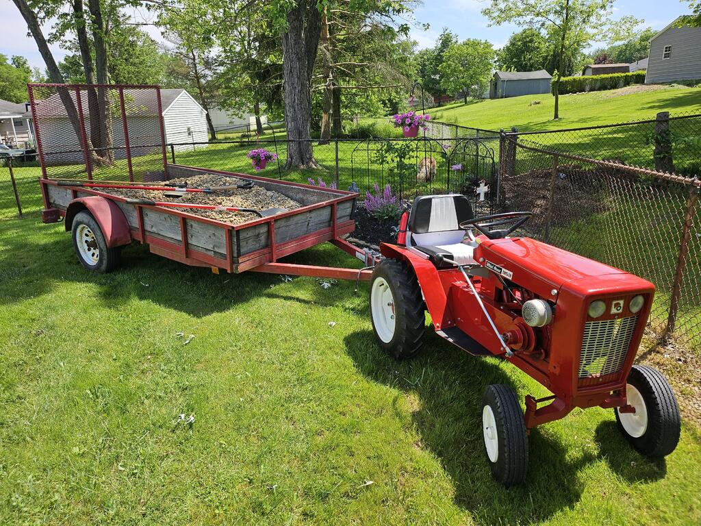

ML3 2,571 #21 Posted March 15, 2025 (edited) Although I have plenty round hoods with hitches I needed to use the 953 to move trailer load of stone last summer. Almost 2000lbs including trailer. Front end of tractor was very light especially when going uphill into back of yard. I was surprised how relatively easy 953 pulled that amount of weight Edited March 15, 2025 by ML3 2 Share this post Link to post Share on other sites

dmoore 1,042 #24 Posted March 17, 2025 On 3/10/2025 at 8:42 PM, WHX?? said: What Dan showed. Just guessing a draw bar was also a desirable option in the day since there is a ton of them out there. I like to run a regular draw bar and a sleeve. In our business we seldom use a sleeve except on plow mules. Looks like the pin is shorter on my 854. Not enough length to use the standard hitch. My C-101 has the standard hitch like in your pic. I guess 2 different pin lengths or the 854 has a wider trans which I don't think so. Share this post Link to post Share on other sites
