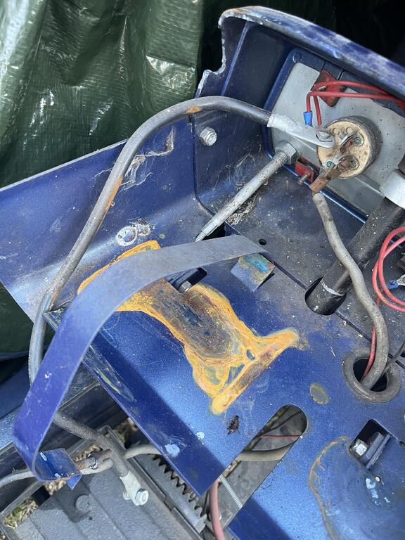

stvski80085 279 #26 Posted March 12, 2025 So this looks interesting. 1 Share this post Link to post Share on other sites
ebinmaine 80,083 #27 Posted March 12, 2025 Where does each color go? To and from? Share this post Link to post Share on other sites
stvski80085 279 #28 Posted March 12, 2025 (edited) Red to frame. Black to key. I wonder if the Derrick from vice grip garage had this. Edited March 12, 2025 by stvski80085 Share this post Link to post Share on other sites
stvski80085 279 #29 Posted March 12, 2025 Or it was anti theft device. 3 Share this post Link to post Share on other sites
ebinmaine 80,083 #30 Posted March 12, 2025 I'd be changing that!! Share this post Link to post Share on other sites
stvski80085 279 #31 Posted March 12, 2025 I am planning on it. It wasn’t a length of cable issue so I don’t know. I will fix before I fire it up this weekend. Well, try too. Share this post Link to post Share on other sites
ebinmaine 80,083 #32 Posted March 12, 2025 7 hours ago, stvski80085 said: I am planning on it. It wasn’t a length of cable issue so I don’t know. I will fix before I fire it up this weekend. Well, try too. The original cables are all black. All 3. The red is a replacement by a PO. Why someone would even consider using red for ground...... Must have been what was to hand. Share this post Link to post Share on other sites
