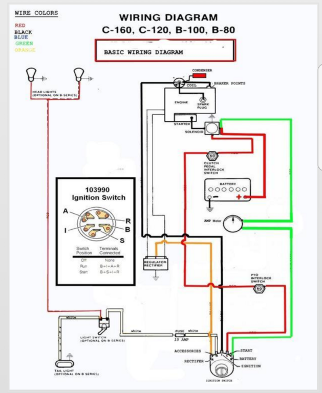

matt monte 232 #2 Posted March 5, 2025 was looking for a little advice. was excited to see her run for the 1st time today. Sadly that wasnt the case. I had my hand EVERYWHERE so i started with the basics. Cranks but doesnt run. Oddly enough if i spray starter fluid and hold the key cranking, she'll run at a high idle, as soon as i let go of the key, she dies, found that kinda by accident. Heres what i know: While its a "new to me engine" I had her running perfectly before i tore her down. I media blasted, cleaned her. I left the piston and connecting rod together inside block but tore her down to replace all gaskets. I replaced carb, fuel system as well as everything electrical except for the ignition switch, just forgot about it, but old one was working prior to tear down. I checked for spark and fuel. I have both. Only thing i can think of is Intake/exhaust valves. I adjusted those. Thought i did it right but since i did mess with it after i had her running, its only logical to go back to it. Honestly not sure how to proceed cause i did it with the head off, watching a YT video. I can pull a ignition switch from another known running tractor but im getting juice to the coil and inline spark tester. Also getting fuel to top of carb. I really dont feel like pulling carb to get to valves so if anyone can think of something im missing, by all means, let me know. Done for tonight, battery needs a re charge anyway. Share this post Link to post Share on other sites

matt monte 232 #5 Posted March 5, 2025 the carb was some Chinese junk off Amazon. ill have to check the parts bin for old carb. Static method? I watched "norm" from i save tractors on a YT video however i have kohler manual on a PDF, so its a perfect time to do things correctly instead of taking the hairbag method which, clearly isnt working for me. I built this from 4 old parts tractors that i saved from being a future Toyota or Honda fender,lol I'll recheck the wiring, thank you for posting wiring diagram. i had this running prior to pulling her apart so its definitely something i did causing it not to run, just didn't know where to start. Share this post Link to post Share on other sites

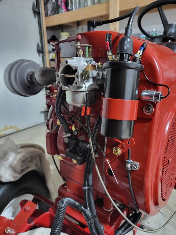

Achto 32,347 #7 Posted March 5, 2025 Hard to tell in your pictures. Do you have the condenser installed ? Share this post Link to post Share on other sites
matt monte 232 #8 Posted March 5, 2025 yes, condenser is new, everything but ignition switch is new Share this post Link to post Share on other sites

matt monte 232 #12 Posted March 5, 2025 the article was great, a bunch of setbacks. After fussing with attempting to hold multimeter cause i couldnt find my alligator clips, i broke down and went to AutoZone for new ones. Afterwards smooth sailing. When i was back to it only running if i hold key in start position, i came to terms that i must of made a mistake in my wiring. I pulled my b80 in from shed for a visual. Yeah no juice at coil in run position, ha so annoying lol thanks guys for reminding me to get back to basics. 2 Share this post Link to post Share on other sites
matt monte 232 #13 Posted March 6, 2025 when i turn the key to run, no juice to position "I" the black wire one that goes to coil. funny i feel like such a rookie lol ordered a new switch Share this post Link to post Share on other sites
