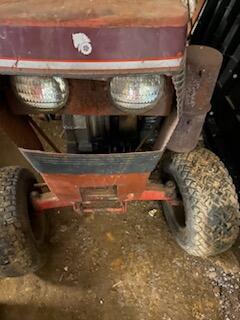

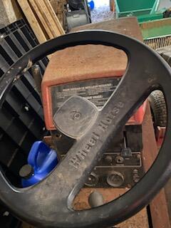

Gilou15 49 #1 Posted March 2, 2025 Hello ! I have the opportunity to buy (250€) a 512 D (for Diesel !!) It is in a poor condition and not complete (no PTO and starting motor ,no mower neither tools ) It is running and used to pull a little trailer .. The transaxle eight speed is ok What do you thing about ? In France ,it is very rare to find a WH and expensive...(I am searching ( for a long time ) for a 520H !! Rather impossible!! I have a poor Rider 10 Four speed to rebuilt and I would like to increase it with a 8 Speed gear boxe and a big engine ....... Thanks for yours answers Gilou d0b420ef01b958253a4ce14e349ebe2340195854.webp 2 Share this post Link to post Share on other sites
