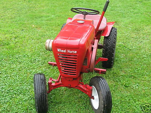

ri702bill 13,068 #7 Posted March 2, 2025 (edited) On early tractors, the steering arms are quite visably angled in to line up if extended to meet at the center of the Unidrive ( aka the Ackerman Angle). Changing the offset of the front rims definetly affects the steering action. Edited March 2, 2025 by ri702bill Share this post Link to post Share on other sites

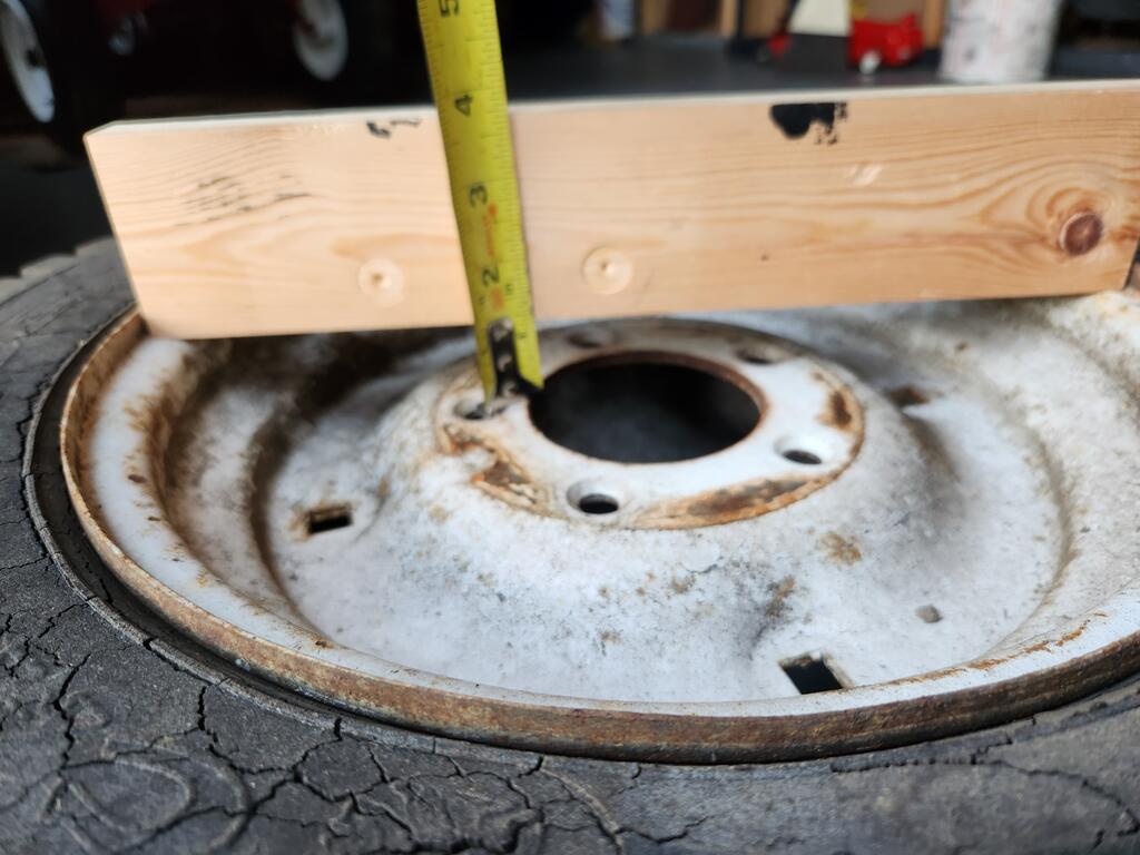

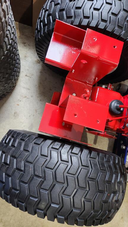

Racinbob 13,193 #8 Posted March 2, 2025 Wheel offset for dummies like me. Wheel Horses definitely have a shallow offset. I had a pair of 23-10.50 from a Craftsman that weren't even close to fitting. It awkward to measure but I cut a board to fit inside the rim lips. I would find wheel/tires on Marketplace and ask what they came off of. It was about 50/50 who knew. So I would send them this picture and ask them to measure from the backside. It's blurry but you get the idea. Most were well over 2". I also carried the board with me so it I saw some on the side of the road. I saw some online and contacted the seller. The offset was a bit more but as hard as it is to find them I just resided myself to getting spacers. These tires were just too nice. But they fit! No chains allowed without spacers though. 4 Share this post Link to post Share on other sites

clueless 3,439 #12 Posted March 2, 2025 4 hours ago, ri702bill said: On early tractors, the steering arms are quite visably angled in to line up if extended to meet at the center of the Unidrive ( aka the Ackerman Angle). Changing the offset of the front rims definetly affects the steering action. What is the rear offset of the early (702) tractors? Share this post Link to post Share on other sites

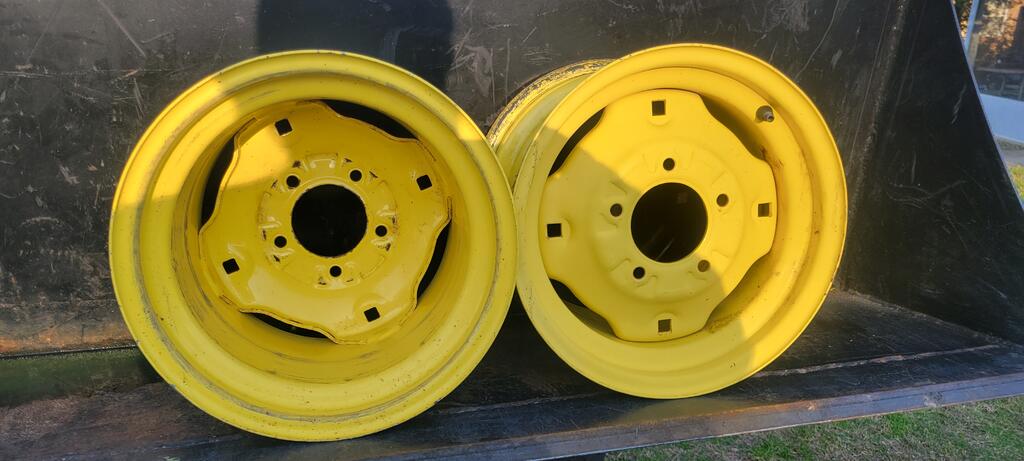

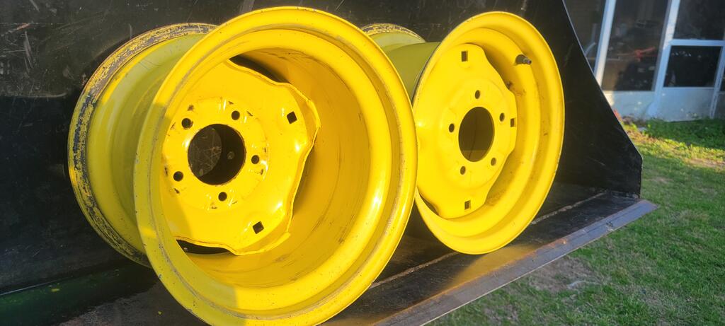

RED-Z06 2,720 #13 Posted March 2, 2025 Got some stuff measured...kinda disappointed. C160 12x7.5 1.625 backspace 312-8 12x7.5 1.625 backspace 416-H 12x7.5 1.625 backspace C100 looks narrower so its no more than 7.5 wide. The high point was by far the 12x8.5 1.625 backspace Deere wheels i found. Share this post Link to post Share on other sites

kpinnc 18,969 #15 Posted March 3, 2025 2 hours ago, RED-Z06 said: The high point was by far the 12x8.5 1.625 backspace Deere wheels i found. JD did make some nice wheels. But they often mount them backwards from wheel horse, with the dish facing inward. My Bronco has rear wheels from a JD, turned deep dish in of course. Share this post Link to post Share on other sites
RED-Z06 2,720 #16 Posted March 3, 2025 33 minutes ago, kpinnc said: JD did make some nice wheels. But they often mount them backwards from wheel horse, with the dish facing inward. My Bronco has rear wheels from a JD, turned deep dish in of course. Alot of them you can just flip them into wide mode, people usually end up running narrow all the time Share this post Link to post Share on other sites
