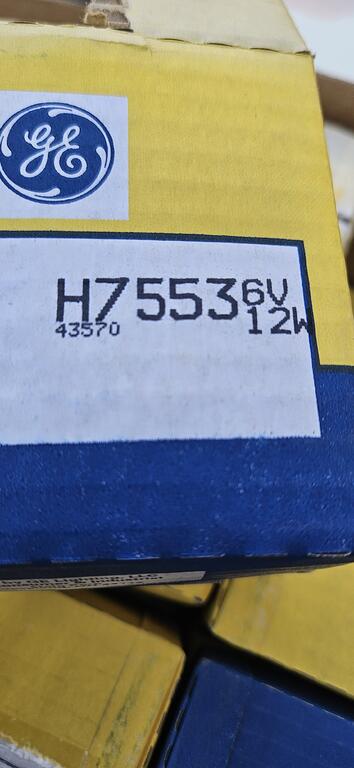

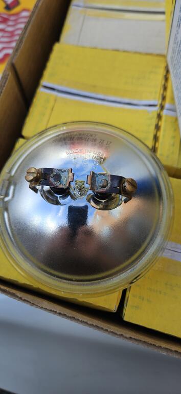

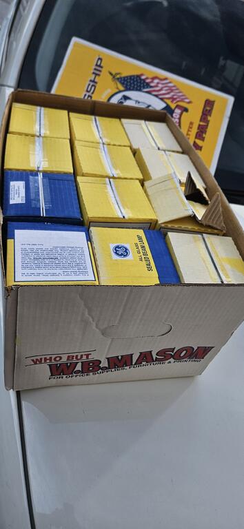

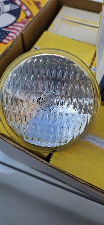

Docwheelhorse 2,987 #1 Posted February 25, 2025 Hello All, So say work throws out 3 dozen Made In USA GE headlight bulbs that where spares for our long gone Emergency Lighting. I took 'em... probably worthless-- then had a thought. Is there or can I build some type of resistor to put in line at bulb to cut voltage from 12 to 6? I dont care there only 12 watts.... i dont use headlights much anyways and these are just nice crystal clear USA bulbs. Several of my tractors are Briggs units with the AC lighting that changes voltage with RPM too. Thoughts? Thanks Tony 1 Share this post Link to post Share on other sites

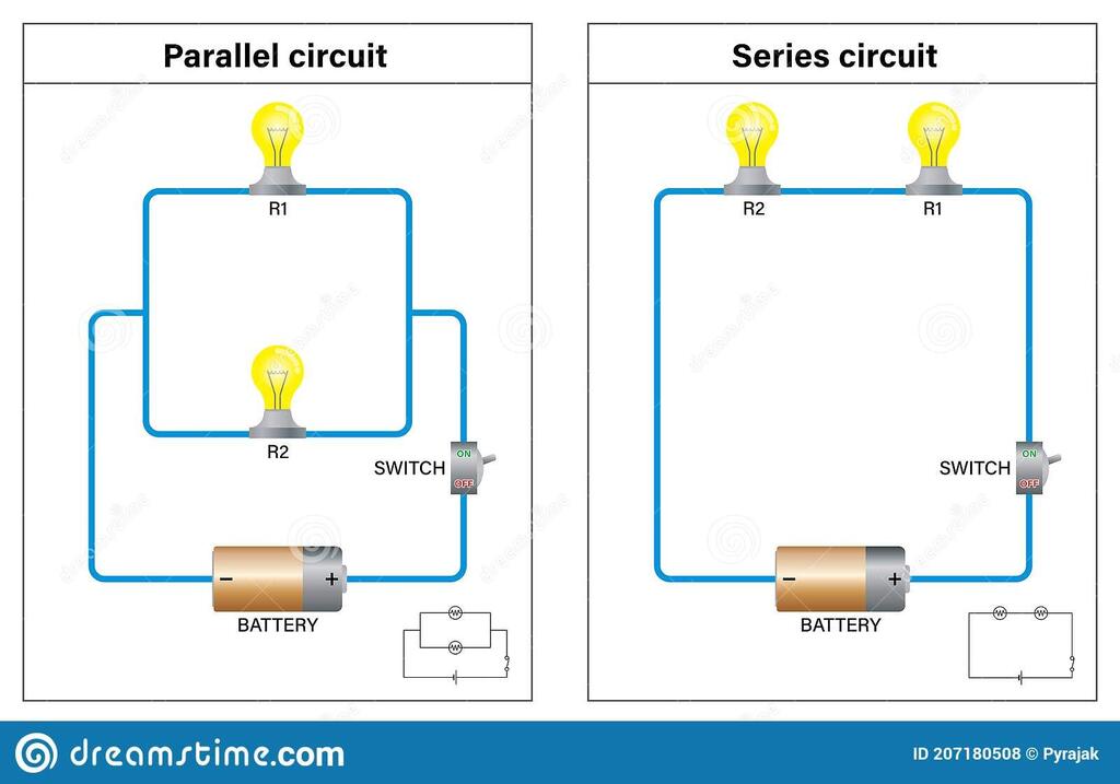

lynnmor 8,875 #2 Posted February 25, 2025 I guess you will be using 2 at a time, simply wire them in series. 6 Share this post Link to post Share on other sites
Docwheelhorse 2,987 #3 Posted February 25, 2025 Explain? 2 in series will handle 12 volts? How do I do that and thanks!! Share this post Link to post Share on other sites
davem1111 2,282 #4 Posted February 25, 2025 (edited) 11 minutes ago, Docwheelhorse said: Explain? 2 in series will handle 12 volts? How do I do that and thanks!! <---- Not an electrical engineer, but a computer guy and a tinkerer, sometimes with things that I shouldn't be tinkering with like 240v circuits I think what he's saying is, run the hot wire to the positive terminal on the first lamp, then run a wire from the negative on that to the positive on the second one, then attach ground to the negative terminal on the second one. I've used 12v batteries in parallel before, and knew that putting them in a series would double it to 24v, but never thought about using the consuming devices in a series. Did I get it right? Edited February 25, 2025 by davem1111 2 1 Share this post Link to post Share on other sites

Handy Don 16,907 #7 Posted February 25, 2025 1 hour ago, Docwheelhorse said: If its that easy you guys have put a big smile on my face!! Tony Excellent save! The ONLY issue is that like those wired-in-series Christmas light strings, when one bulb burns out, both lights go off. Remember swapping a known good down the string until you got to the dead one? Same (but at least only two bulbs!) 3 Share this post Link to post Share on other sites
ri702bill 12,383 #8 Posted February 25, 2025 5 minutes ago, Handy Don said: The ONLY issue is that like those wired-in-series Christmas light strings, when one bulb burns out, both lights go off East enough to check for voltage in & out of the first bulb. Share this post Link to post Share on other sites
Handy Don 16,907 #9 Posted February 25, 2025 Just now, ri702bill said: East enough to check for voltage in & out of the first bulb. Dark and got volts? This is the dead one. Dark and no volts? This one is still good. (Unless BOTH lamps blew at the same time! ) No access to the connections on those pesky Christmas lights, though! 2 Share this post Link to post Share on other sites

Racinbob 13,016 #13 Posted February 26, 2025 Yes, just a simple series circuit. The downside it what they said, one burns out they both go out. But a bulb operating at half voltage will last about a million years. 1 1 Share this post Link to post Share on other sites

Racinbob 13,016 #16 Posted February 26, 2025 11 minutes ago, Ed Kennell said: We don't often get to correct Bob. Those 6v Emergency bulbs are seeing a full 6volts. 100% correct. Can I blame it on not having finished my first cup of coffee? I guess my mind went back to when, as a contractor, we were working in a very large orthopedic firm in Warsaw. At the time their main plant had a 14 acre footprint and was about 50% 2 levels. They had the type of emergency lights referred to here. You can imagine how many. Doing routine checks they would find several bulbs out. I tossed out the idea of wiring the bulbs in series. The downside was that they would likely come up short on the lumen output. But in reality I thought it would still be plenty. We experimented in one large office area. Even though the office workers were quick to complain they didn't even notice. Keep in mind here. That's 6v bulbs now operating at half voltage. The light output actually is cut to about 25% their normal doing that, not half like you might think. In Tonys case he'll have 6 volt bulbs operating on a 12v supply wired to supply........half voltage......which is.....................oh yea.......................6 volts. Tony, the good news is that it will work. The bad news is that when one burns out they both will be out.............and they won't last any longer. 2 Share this post Link to post Share on other sites
