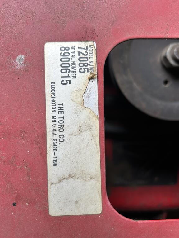

davidtmercer 83 #1 Posted February 23, 2025 I have a 267-H with 48" side discharge mower deck in very good condition. However, the tuff torque hydro transmission does not operate smoothly in forward. Very jerky. Troubleshooting sections in the manuals have not been helpful in resolving. Any advice would be appreciated. Nameplate numbers in attached picture. Share this post Link to post Share on other sites

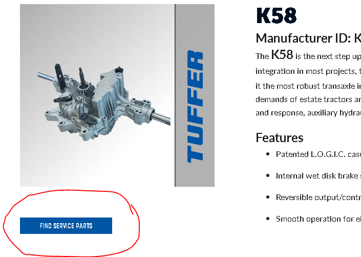

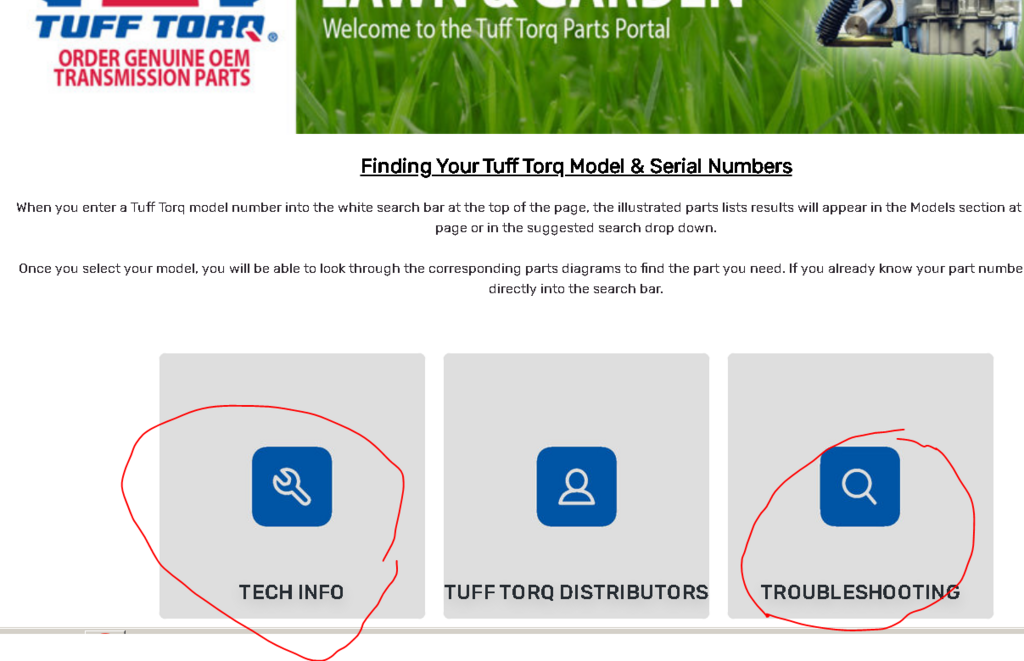

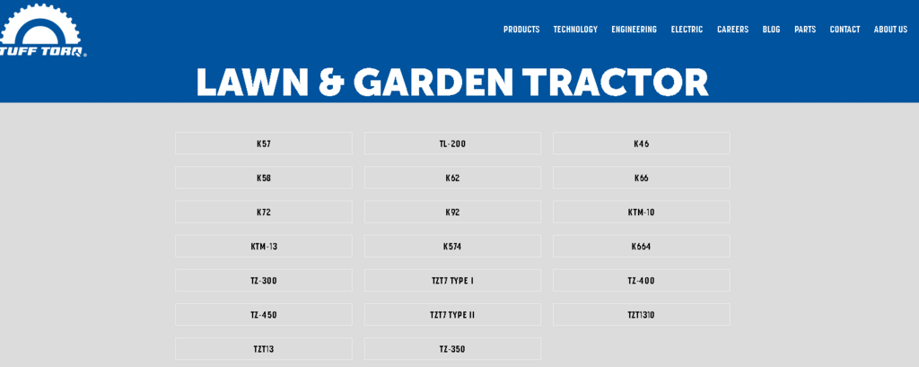

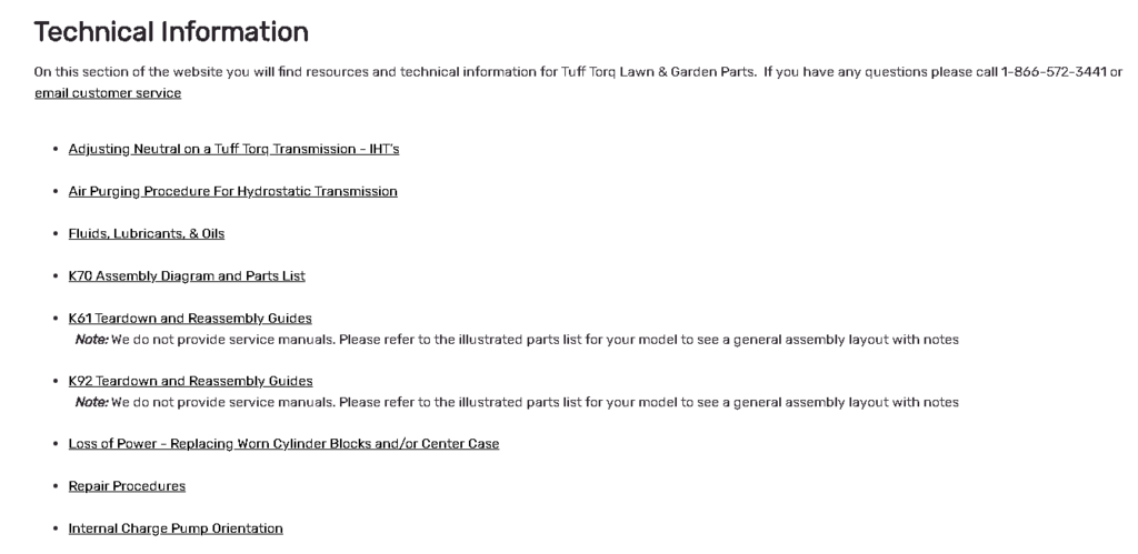

JoeM 10,030 #3 Posted February 23, 2025 You might want to get the info from your trans and go to the tough torq web site. https://www.tufftorq.com/product/k46/ there are some service manuals there and also some vids on YouTube. I repaired a K58 a few years ago and this is how I got the info. the web page looks like this after you find your model there is a field you can click on to go further you can choose and find more info here you can find these items under tech info 2 Share this post Link to post Share on other sites
