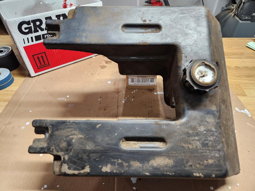

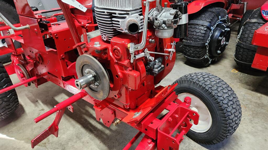

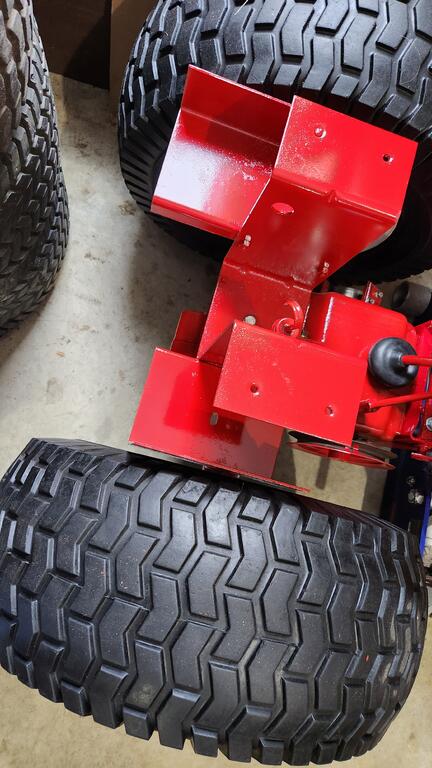

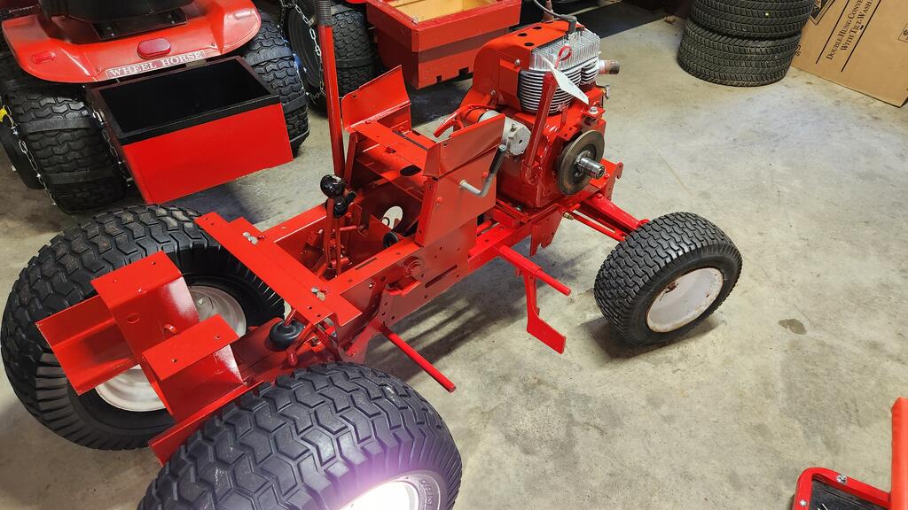

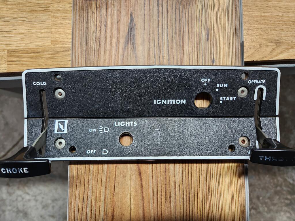

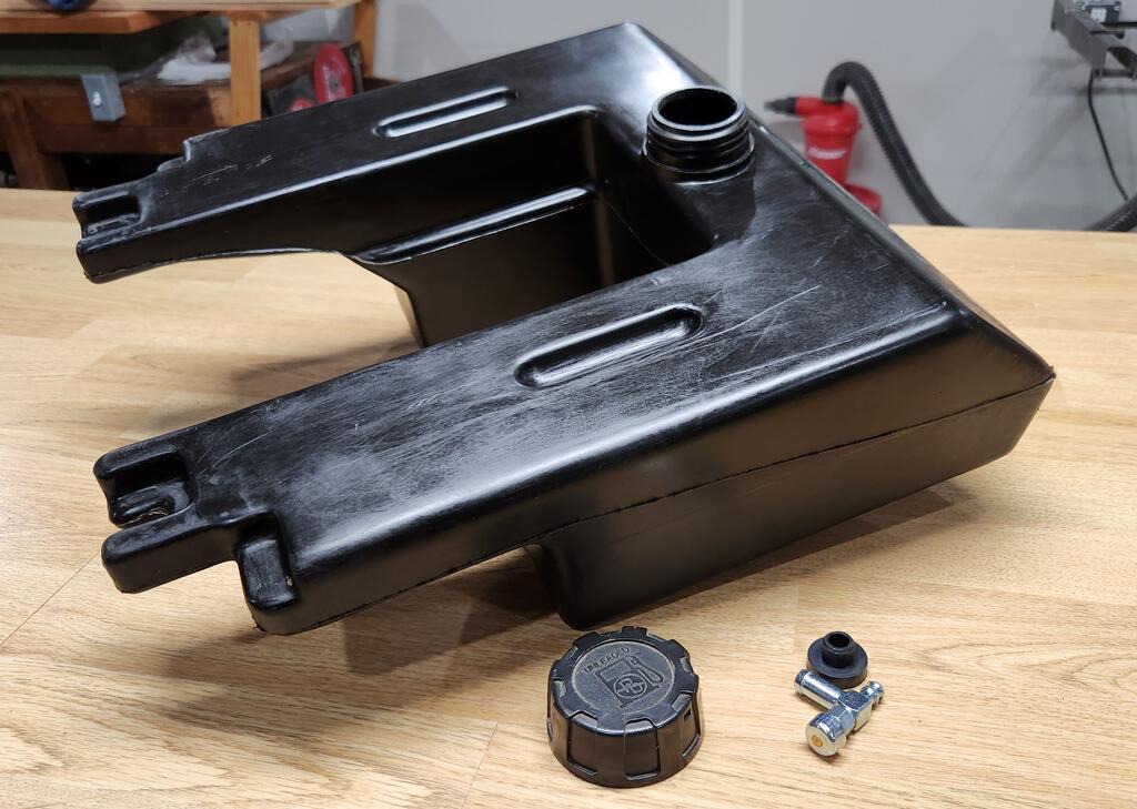

Racinbob 12,567 #1 Posted February 22, 2025 Just a mini update as the going is a bit slow. Today was the first day in over a week where I warmed up the garage. I touched up the white on the dash. I will black out the rivets. The gas tank needed some loving. It cleaned up inside and out really nice. I had a cap, valve and bung in my stash. I won't install it until I decide where I'm putting the electric pump. The 23-10.50 rears aren't on the correct offset wheels for a Wheel Horse but they just made it.......as long as I don't use chains. The oil drain was a bit of an issue. It wanted to hit the steering rod. I got it piped out now. I've had the unwobbled engine base done a while now but wasn't certain it would fit right. It fit perfect and the engine is officially reinstalled now. I want to get a 1/2" longer nipple for the oil drain so no oil in it until I do that. The fuel pump will be blanked off. The muffler and other stuff on the front of the engine won't be done until I get the steering tower back on and the control cables connected. That's gotta wait until I can spray outside. I wanted to get it this far today so I can push it aside and bring in the 314-H Buyers Remorse in from the barn. Parts will be coming in for it the next few days. 3 13 1 Share this post Link to post Share on other sites

ebinmaine 76,895 #3 Posted February 22, 2025 1 hour ago, Racinbob said: gas tank needed some loving. It cleaned up inside and out really nice Looks EXCELLENT. What did you do for that? What cleaners? Paint? Etc? 2 Share this post Link to post Share on other sites
Racinbob 12,567 #4 Posted February 22, 2025 25 minutes ago, ebinmaine said: Looks EXCELLENT. What did you do for that? What cleaners? Paint? Etc? I just submerged it in hot water and Dawn overnight. Then scrubbed and rinsed well. It really wasn't needed but I then lightly wiped it down with Mothers Back to Black. 1 2 1 Share this post Link to post Share on other sites

stevasaurus 23,546 #6 Posted February 22, 2025 That looks fantastic Bob!!! Nice touch with the gas tank. 3 Share this post Link to post Share on other sites
