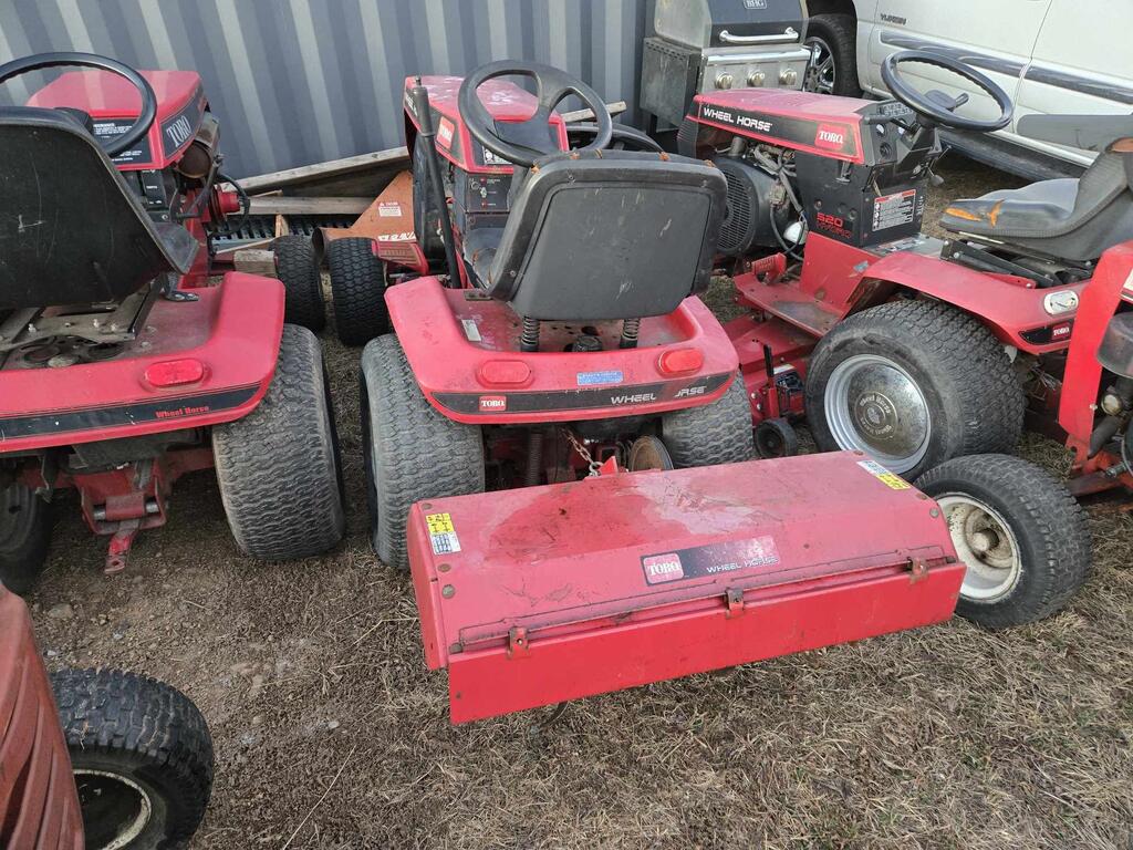

adsm08 4,881 #62 Posted February 21, 2025 11 minutes ago, Pete D said: Enclosed, and it'll fit 3 motorcycles. That's as big as I've got! If I stand 'em on end, I'll bet I can fit 9 - 12 tractors! 🤣 That's it? Those are rookie numbers man. You need to go to Michigan and study under Master @Pullstart in the ways of hauling the horse. 1 3 Share this post Link to post Share on other sites

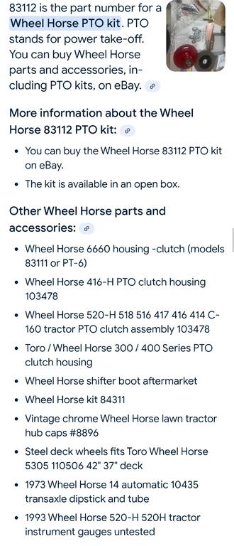

HyperPete 939 #65 Posted February 21, 2025 (edited) Interesting. I found 3 that fit the 1076. Of those, 2 of them are compatible with the 855, so should be with the 857. The 7-1211 is not listed, but the RT-366 & RT-367 are. From the implement cross-reference spreadsheet here. Oops, my screw up. I was looking at the 1075. The RT-366 fits the 1076, but "(Requires 83112)" Edited February 21, 2025 by Pete D Share this post Link to post Share on other sites

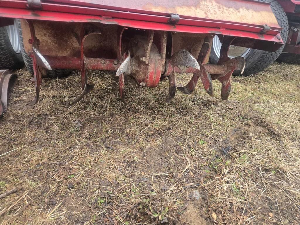

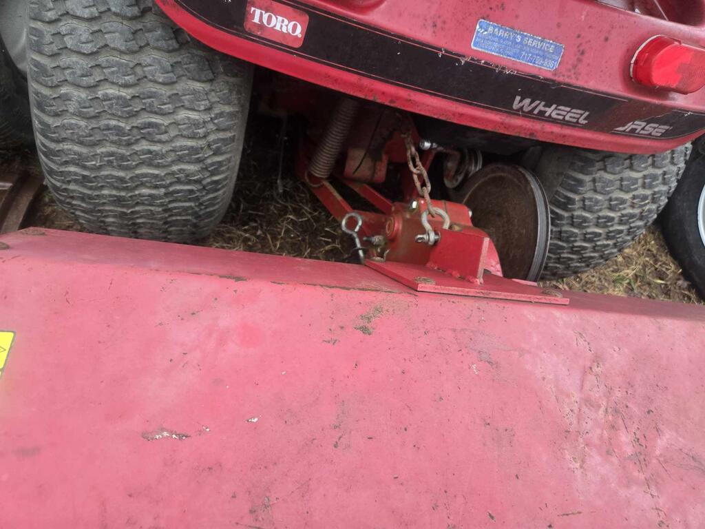

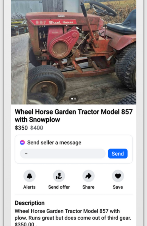

HyperPete 939 #67 Posted February 22, 2025 (edited) I'm going up to look at the 857. I found an 8 speed for it. The 857 seller has this rototiller. Will it fit an 857, with or without mods? He says "It clips in on later model mower deck attachment mounts", and "The idler pulley clips where mower deck originally mounts." Pics of tiller: Edited February 22, 2025 by Pete D Share this post Link to post Share on other sites
kpinnc 18,836 #68 Posted February 22, 2025 (edited) 41 minutes ago, Pete D said: The 857 seller has this rototiller. Will it fit an 857, with or without mods? The tines on that tiller are very worn down. Not terrible, but about as worn as I would go with. To answer the questions: Yes, it can be done with mods. If you convert to an 8-speed, it will work better. The low range allows the tiller to engage the ground better. It takes smaller bites on each revolution due to the slow speed. -You will need the rear axle hitch for the tiller. -You will need the rear lift cable that fits the 857. -Obviously you'll need the PTO kit. -You'll also need the pulley assembly from the belly hitch of the donor machine. -You will also have to get a belly hitch and add it to the 857. -And finally you will have to figure out for yourself the proper belt length for a short frame tractor. There may be other things, but it can definitely be done. Edited February 22, 2025 by kpinnc Share this post Link to post Share on other sites
pfrederi 20,982 #69 Posted February 22, 2025 Those tines are about done... Share this post Link to post Share on other sites
ebinmaine 80,045 #70 Posted February 22, 2025 8 minutes ago, pfrederi said: Those tines are about done... Good eye Paul. @Pete D Look at other pics of tiller tines. You'll see they should have a fair amount more length and angle. Replacing them is expensive. Share this post Link to post Share on other sites
Pullstart 70,974 #71 Posted February 22, 2025 On 2/20/2025 at 6:49 PM, Pete D said: Enclosed, and it'll fit 3 motorcycles. That's as big as I've got! If I stand 'em on end, I'll bet I can fit 9 - 12 tractors! 🤣 Look me up there, I’ll help you load 1 2 3 Share this post Link to post Share on other sites
adsm08 4,881 #72 Posted February 22, 2025 1 hour ago, Pullstart said: You need more air in that tire. Share this post Link to post Share on other sites
Pullstart 70,974 #73 Posted February 22, 2025 16 minutes ago, adsm08 said: You need more air in that tire. It had about 50 psi in it! It rolled a little flat on the bottom all 650 miles home… Share this post Link to post Share on other sites
