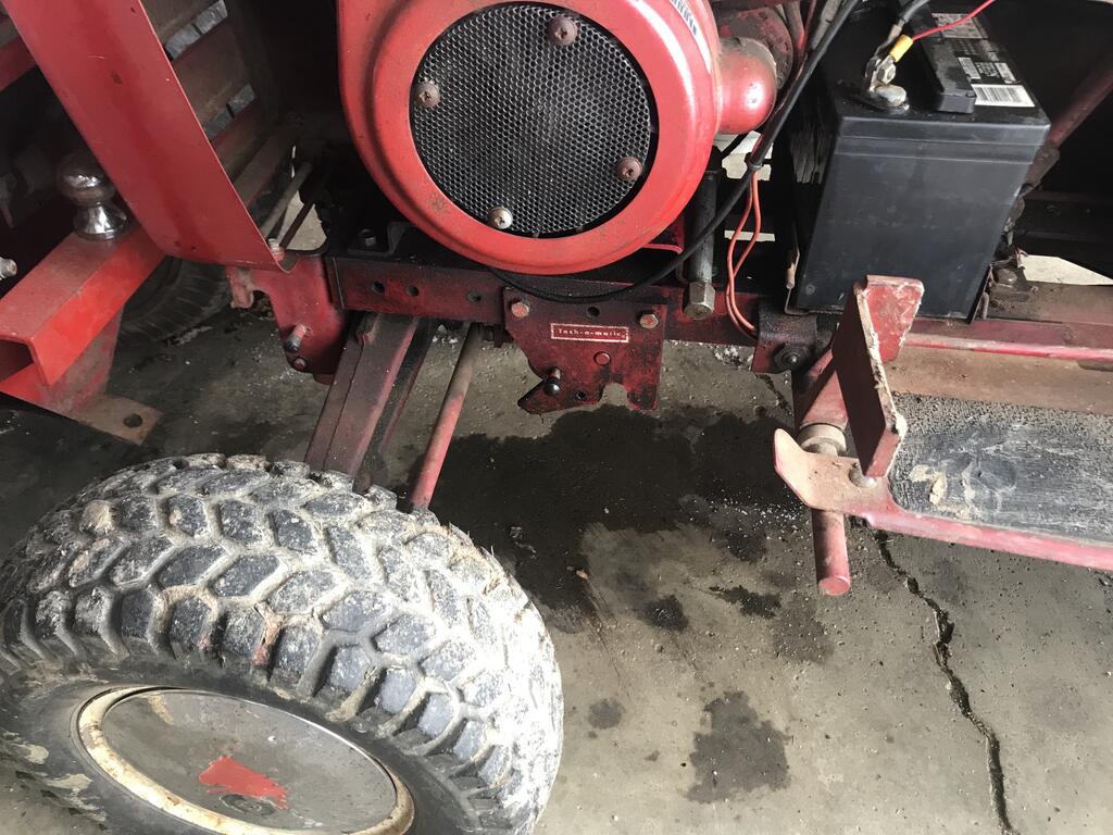

rustyedge1 203 #1 Posted February 16, 2025 I've used this B-80 for years without any issues but last year it started leaking a little in front ( the oil spot is from several different times being parked in area ) I haven't tried to tighten any bolts yet, waiting on warmer weather. I know there could be several issues which could cause this but thought I'd see what you folks thought and point me in the direction I need to go when warmer. Engine still running strong, no noise to mention, no smoke, just leaking oil... Any help appreciated in advance. Share this post Link to post Share on other sites
ri702bill 13,163 #2 Posted February 16, 2025 Are the 4 oil pan to block bolts evenly tightened?? Is the breather not clogged? Check to see if oil is leaking at the fuel pump. Pull the flywheel shroud to be able to see if the crank seal behind the flywheel is leaking...... Seems to be a good sized puddle on the floor..... 1 Share this post Link to post Share on other sites
squonk 48,207 #3 Posted February 16, 2025 (edited) Thinking Fuel pump , flywheel side crank seal , or the front flywheel bearing plate gasket. That tach o matic looks dry so I'm leaning towards the fuel pump Edited February 16, 2025 by squonk 2 Share this post Link to post Share on other sites
rustyedge1 203 #4 Posted February 16, 2025 When I first noticed it thought it was a gas leak around fuel pump but haven't really looked any further since. Share this post Link to post Share on other sites
rustyedge1 203 #5 Posted March 2, 2025 I looked it over a bit last week and the oil level isn’t changing but the gas is leaking out somewhere. Checked bolts which are all tight. Weather warms up believe I’ll check all gas lines.. Share this post Link to post Share on other sites
