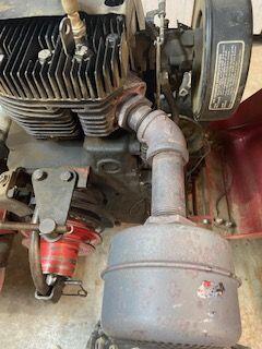

Racinbob 13,213 #126 Posted March 10, 2025 2 hours ago, oliver2-44 said: Great job. That horse just wanted some Love I'm gonna keep my fingers crossed until a true test. 17 minutes ago, Lagersolut said: Threaded a short nipple - 45 then straight out with a 6” nipple to the can . I had a pepper can on a K-341 for a while and had to change it. That or wear earmuffs. This really doesn't seem any louder than the stock muffler. If I do end up putting a good muffler on it the original fitting is a 45 but the outlet end is the oversize issue. I can screw a street 45 in the block but I would have to pull stuff off the front of the engine to do that. Not happening until I know the problem is fixed for sure. I feel that the issue was the coil and will be able to go back to the original muffler. 2 Share this post Link to post Share on other sites

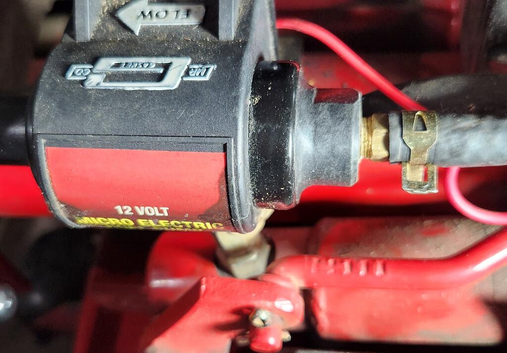

Racinbob 13,213 #131 Posted March 11, 2025 I had a slow leak from under the left side panel that I assumed was hydraulic. This morning, feeling pretty good about the initial test yesterday I decided to look for it. It didn't take long and I had to laugh at myself after all this tractor has put me through. The brass barb on the inlet side of the fuel pump wasn't even finger tight. It was hidden by the cover. I should fire the idiot that installed the pump. 3 Share this post Link to post Share on other sites

Lagersolut 806 #133 Posted March 13, 2025 On 3/10/2025 at 4:47 PM, RED-Z06 said: Bar none the only thing louder is a straight pipe. My piping job to the can on the 416 - forgot it needed a reducer at the block Share this post Link to post Share on other sites
