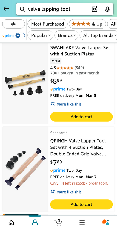

David Blanchard 14 #83 Posted March 2, 2025 While the head is off would not hurt to pop the valves out & lap them any way. Anyone you know may own the proper tools you could borrow? Those tools are not real expensive but understand not wanting to invest in something not likley to be used again. Still betting its a coil issue. Share this post Link to post Share on other sites
HyperPete 939 #84 Posted March 2, 2025 21 minutes ago, David Blanchard said: Those tools are not real expensive but understand not wanting to invest in something not likely to be used again. One (two?) drinks at a bar / restaurant buys them. Share this post Link to post Share on other sites
David Blanchard 14 #85 Posted March 2, 2025 Yes still needing some lapping compound & a spring compressor makes it much easier but amazon/ ebay makes the stuff easy to obtain. I still miss the local neighborhood parts stores with machine shops we grew up with Share this post Link to post Share on other sites
Racinbob 13,087 #86 Posted March 2, 2025 11 hours ago, Pete D said: California? USPS sometimes ships my packages from the East coast to CA before delivering it to me in Pennsylvania. No Pete. This isn't a routing issue. Apparently the Indy branch is making some changes causing packages to sit, sometimes for weeks. Guys, it's not a matter of buying the tools. I just don't like buying something to use once and sit in the drawer forever. Countless times I was tempted to tool up for rebuilding these engines but I just never did. I've check out the valves and I'm pretty certain they are fine. I'm sticking to doing my list as I posted in post #21. If it still has the problem then I'll take it further. On the other hand, if I had the tools I would think about attacking a K-341 that's sitting on the shelf. Rebuilt 57 hours ago but what I believe IS a valve issue occurred. I was just going to get it to someone who wanted to tinker with it but...................... That's another story. 1 Share this post Link to post Share on other sites

Lagersolut 802 #90 Posted March 2, 2025 7 hours ago, Racinbob said: No Pete. This isn't a routing issue. Apparently the Indy branch is making some changes causing packages to sit, sometimes for weeks. Guys, it's not a matter of buying the tools. I just don't like buying something to use once and sit in the drawer forever. Countless times I was tempted to tool up for rebuilding these engines but I just never did. I've check out the valves and I'm pretty certain they are fine. I'm sticking to doing my list as I posted in post #21. If it still has the problem then I'll take it further. On the other hand, if I had the tools I would think about attacking a K-341 that's sitting on the shelf. Rebuilt 57 hours ago but what I believe IS a valve issue occurred. I was just going to get it to someone who wanted to tinker with it but...................... That's another story. I'm sharing your frustration with this magneto held hostage - I want to know what this ghost is and the tractor fixed - check this thread every day hoping we all have our answer 1 Share this post Link to post Share on other sites

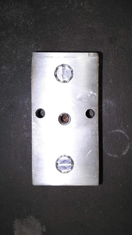

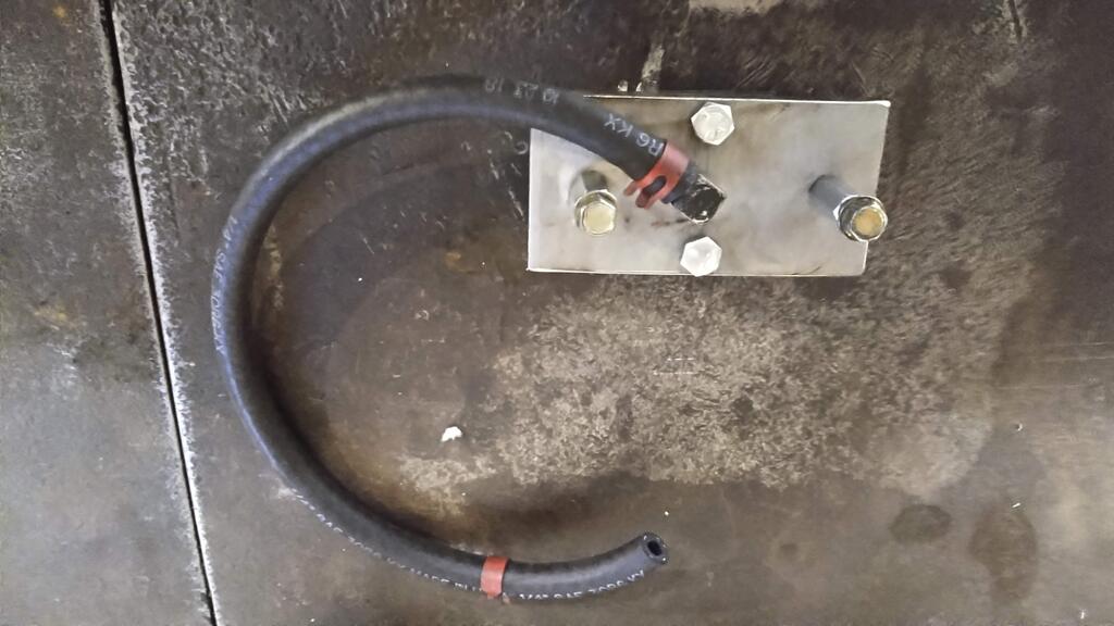

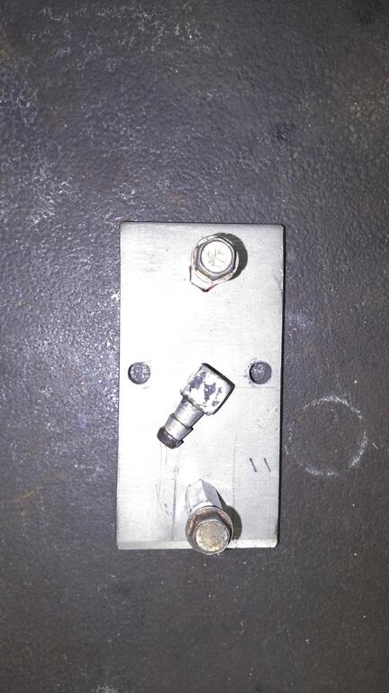

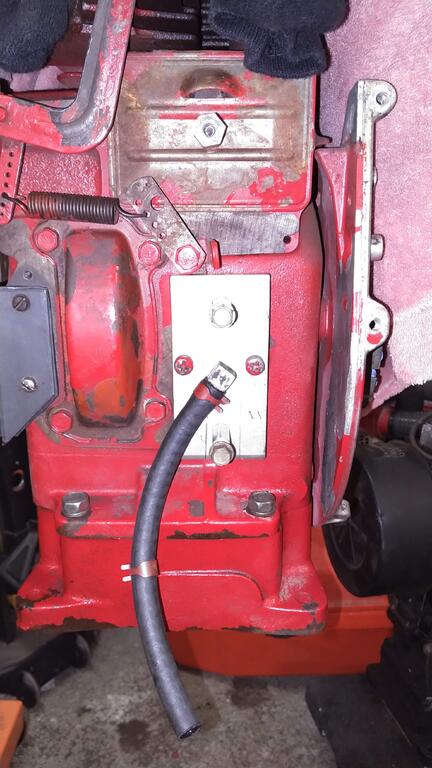

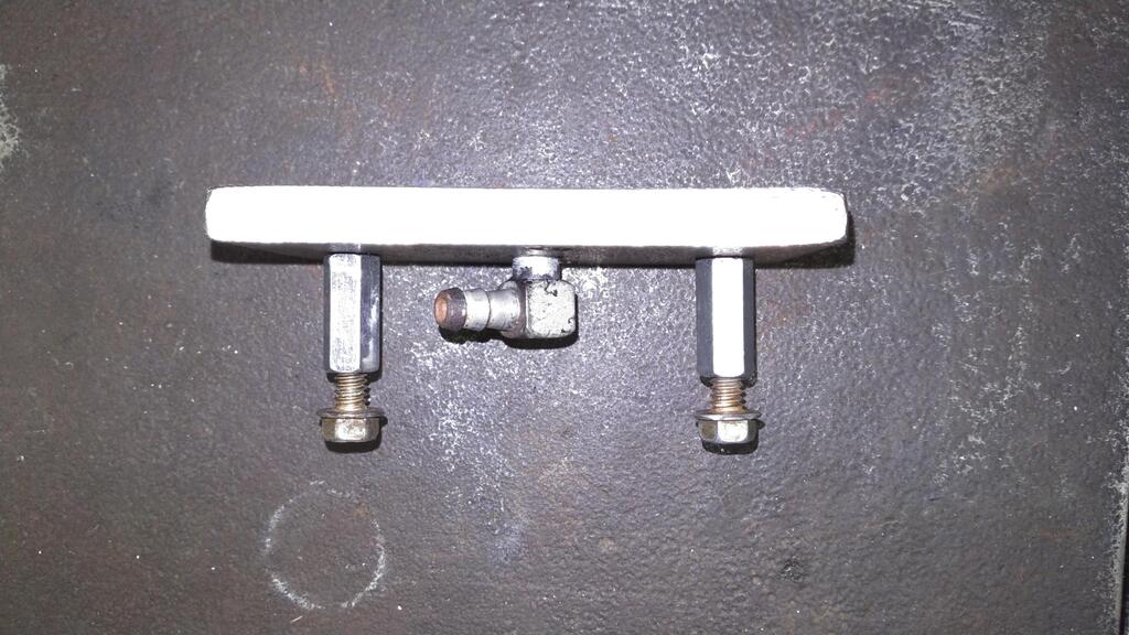

Racinbob 13,087 #96 Posted March 4, 2025 After saying he would send another coil he got back to me saying he's out of stock. I requested a refund and ordered another one elsewhere. I'm pretty much at a standstill on the 314-H so I was tinkering with the Dino C-121. I opened things up and checked the valve lash. Both were a bit tight I'm guessing due to normal wear. The valves look great. Since I'm going electric I removed the mechanical pump. I'll make a plate to close it up. It hit me that I have a couple of vacuum pumps in my stash. I pondered using one of those instead of electric. I could tap a 1/4" barb fitting in the cover plate to pick up the pulse. I wonder if it would solve the low fuel tank issue as well as an electric? I could mount the vacuum pump lower than the original. Opinions? Here's one of the pumps I have. Fuel direction isn't indicated so I guess it's safe to assume it doesn't matter? Share this post Link to post Share on other sites
cleat 9,093 #97 Posted March 4, 2025 (edited) 10 minutes ago, Racinbob said: After saying he would send another coil he got back to me saying he's out of stock. I requested a refund and ordered another one elsewhere. I'm pretty much at a standstill on the 314-H so I was tinkering with the Dino C-121. I opened things up and checked the valve lash. Both were a bit tight I'm guessing due to normal wear. The valves look great. Since I'm going electric I removed the mechanical pump. I'll make a plate to close it up. It hit me that I have a couple of vacuum pumps in my stash. I pondered using one of those instead of electric. I could tap a 1/4" barb fitting in the cover plate to pick up the pulse. I wonder if it would solve the low fuel tank issue as well as an electric? I could mount the vacuum pump lower than the original. Opinions? Here's one of the pumps I have. Fuel direction isn't indicated so I guess it's safe to assume it doesn't matter? Fuel inlet and outlet definitely matter as the check valves only work one way. You should be able to blow through in the direction of fuel flow but not the other way. Tractor (what I can see in the pic. looks great). Edited March 4, 2025 by cleat 3 Share this post Link to post Share on other sites
Ed Kennell 46,797 #98 Posted March 4, 2025 (edited) 1 hour ago, cleat said: I wonder if it would solve the low fuel tank issue as well as an electric? I could mount the vacuum pump lower than the original. Opinions? Lowering the fuel pump below the tank will certainly help to prevent the drain back and loss of prime in the pump. The advantage of the electric pump and a primer bulb, the engine does not have to be cranked to fill the carb bowl. Agree with Cleat, all diaphragm pumps only pump in one direction. They all have two same direction check valves with a diaphragm between. Edited March 4, 2025 by Ed Kennell 2 Share this post Link to post Share on other sites
Racinbob 13,087 #99 Posted March 4, 2025 That was yet another 'duh' moment. I've never used this style of pump. It does seem odd that they didn't identify them. I definitely prefer electrics for the very reason you mention Ed. I'm not sure how I'll go on this one. This tractor could likely become one of the main mowers when it's done. The verdict is still out on the 314. I guess I can always switch out to an electric if I don't care for the vacuum. Share this post Link to post Share on other sites
Bill D 3,063 #100 Posted March 4, 2025 (edited) 11 hours ago, Racinbob said: After saying he would send another coil he got back to me saying he's out of stock. I requested a refund and ordered another one elsewhere. I'm pretty much at a standstill on the 314-H so I was tinkering with the Dino C-121. I opened things up and checked the valve lash. Both were a bit tight I'm guessing due to normal wear. The valves look great. Since I'm going electric I removed the mechanical pump. I'll make a plate to close it up. It hit me that I have a couple of vacuum pumps in my stash. I pondered using one of those instead of electric. I could tap a 1/4" barb fitting in the cover plate to pick up the pulse. I wonder if it would solve the low fuel tank issue as well as an electric? I could mount the vacuum pump lower than the original. Opinions? Here's one of the pumps I have. Fuel direction isn't indicated so I guess it's safe to assume it doesn't matter? I make up mounting plates like this to mount the fuel pump. I use stainless steel for the plate so it won't need to be painted. I'd recommend using Kawasaki part number 49040-0803 for the pump instead of the pump you have. On that pump the outlet is on the upper left and the pulse line and inlet are on the lower right, perfect for this application. Kawasaki pumps are made by Mikuni in Japan and are much better quality than a Chinese knockoff, and less likely to fail resulting in gas in your oil. Edited March 5, 2025 by Bill D Wrong part number Share this post Link to post Share on other sites
