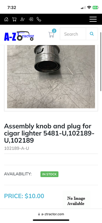

1968Commando 173 #1 Posted February 16, 2025 Hello all, I am restoring a commando 8 and from the factory it had a cigarette lighter that is now missing, now before you ask no I don’t smoke and I don’t plan on smoking I just want it back because it looks cool I think haha, anyways I found one on az tractor do yall think this is what I need or do I need more pieces Share this post Link to post Share on other sites
WHX?? 57,273 #2 Posted February 16, 2025 (edited) Any cigar lighter will work. Trick is to get the orginal style knob, Hen's teeth sometimes and can command a hefty price if you do get lucky. If A-Z has an original for that coin order it NOW!! Edited February 16, 2025 by WHX?? 3 Share this post Link to post Share on other sites
1968Commando 173 #3 Posted February 16, 2025 10 minutes ago, WHX?? said: And cigar lighter will work. Trick is to get the orginal style knob, Hen's teeth sometimes and can command a hefty price if you do get lucky. If A-Z has an original for that coin order it NOW!! So did that look like a complete plug and go set or no? Share this post Link to post Share on other sites
WHX?? 57,273 #4 Posted February 16, 2025 No the socket is missing but your pic isn't showing us squat. . 1 Share this post Link to post Share on other sites

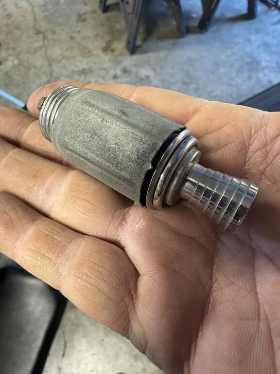

kpinnc 18,713 #6 Posted February 16, 2025 I um, never found originals. Decided to just make a funny... 6 1 Share this post Link to post Share on other sites

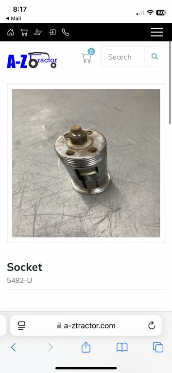

1968Commando 173 #7 Posted February 16, 2025 Here is a socket I found I will look at the part numbers and see if they match Share this post Link to post Share on other sites

WHX?? 57,273 #9 Posted February 16, 2025 (edited) Yes that is the entire correct assembly. Order it ... Linc at A-Z is a good guy to deal with. BTW I have seen those at the BS for upwards of 75 clams. Much more if in a original blister pack. Your a hamster KP ... Edited February 16, 2025 by WHX?? 2 1 Share this post Link to post Share on other sites

gwest_ca-(File Mod) 12,320 #14 Posted February 16, 2025 3 hours ago, 1968Commando said: Here is a socket I found I will look at the part numbers and see if they match That is 1/2 the socket. There is an outer shell that threads onto the large threads at the base to hold it in the dash. There were only two major lighter suppliers back in the day. Rochester and this one I believe is Casio - totally different. 1 Share this post Link to post Share on other sites

1968Commando 173 #20 Posted February 16, 2025 10 hours ago, gwest_ca said: That is 1/2 the socket. There is an outer shell that threads onto the large threads at the base to hold it in the dash. There were only two major lighter suppliers back in the day. Rochester and this one I believe is Casio - totally different. Ok soooo now I’m confused, do I have the right pieces or not, I want to make sure I have all the pieces for the cigarette lighter I need because currently I have a dc switch in the cigarette hole. Share this post Link to post Share on other sites

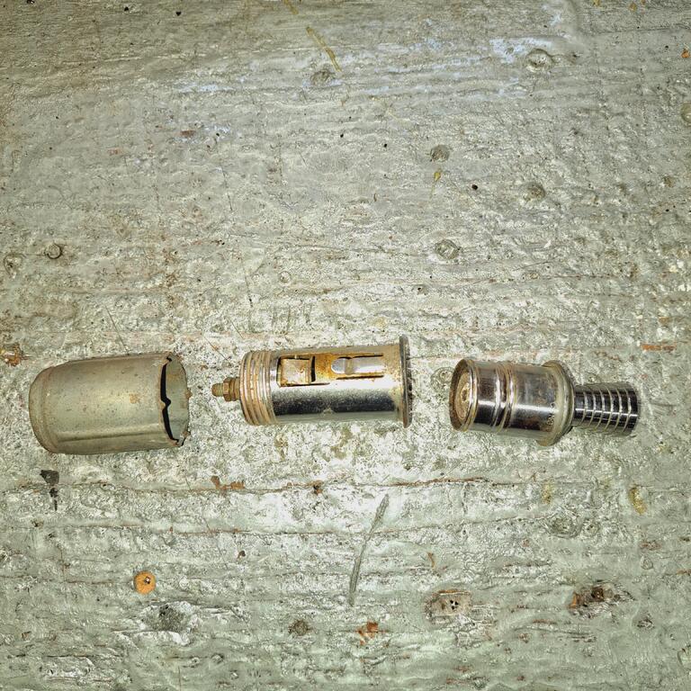

1968Commando 173 #22 Posted February 16, 2025 2 minutes ago, WHX?? said: Ok so I got the lighter and the socket now I just need too find the case to tie it all together. 1 Share this post Link to post Share on other sites
rjg854 13,154 #23 Posted February 16, 2025 If AZ has those 2 pieces, I would think he would most likely have the case too. Share this post Link to post Share on other sites
WHX?? 57,273 #24 Posted February 17, 2025 3 hours ago, rjg854 said: most likely have the case too One would think so and he would sell as one piece. Sometimes they are so rusted they shred getting them off. Share this post Link to post Share on other sites
