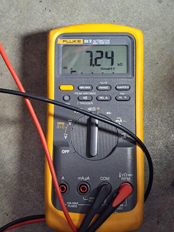

dmoore 1,042 #1 Posted February 15, 2025 So I've been troubleshooting the no spark issue on my RJ-58. I had a good blue spark then nothing. I've set the new OE Kohler points from 0.16 - 0.20 with no luck. New plug etc. I decided to remove flywheel and OHM the coil. It read 7.24 OHMS. Since I do not have a service manual (yet) for these older Kohler's I am not sure if this is a good reading. I dont think a bad condenser would prevent a no spark issue. I have also disconnected the single kill switch wire removing it as a possibility. What say you? Share this post Link to post Share on other sites
wallfish 20,744 #2 Posted February 15, 2025 1 hour ago, dmoore said: I've set the new OE Kohler points from 0.16 - 0.20 with no luck Did you clean off the contacts on those new set of points? They come shipped with a coating on them which prevents them from oxidizing in the package, but that coating also prevents a closed circuit from happening unless it's cleaned off 3 Share this post Link to post Share on other sites
squonk 48,427 #3 Posted February 15, 2025 Looks like 7.24 Kiliohms (K ohms) I think that is too high. Share this post Link to post Share on other sites

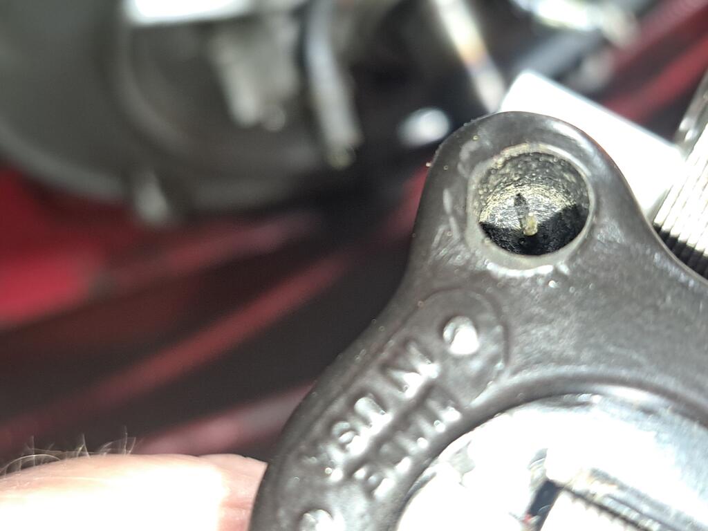

dmoore 1,042 #6 Posted February 15, 2025 So I removed the coil to get a better look since this is my first K91 and the plug lead came out of it rather easily. Looked inside and there is this sharp pin? Is the plug lead supposed to just push in on that pin?? Doesn't make sense. Share this post Link to post Share on other sites
dmoore 1,042 #7 Posted February 15, 2025 OHM reading on coil directly to that pin without going through plug lead was 7.29 ohms...slightly higher than going through plug lead. Share this post Link to post Share on other sites
Howie 900 #8 Posted February 16, 2025 That plug wire is supposed to screw on that pin down in there. Not supposed to just push in there. Share this post Link to post Share on other sites
wallfish 20,744 #9 Posted February 16, 2025 4 hours ago, dmoore said: Is the plug lead supposed to just push in on that pin?? Yes, it just pushes down on the pin for the wire connection and is typically held in place with a small amount of epoxy on the insulation to the wall. 2 Share this post Link to post Share on other sites

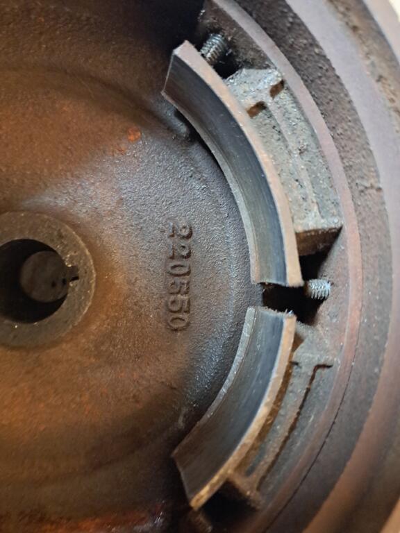

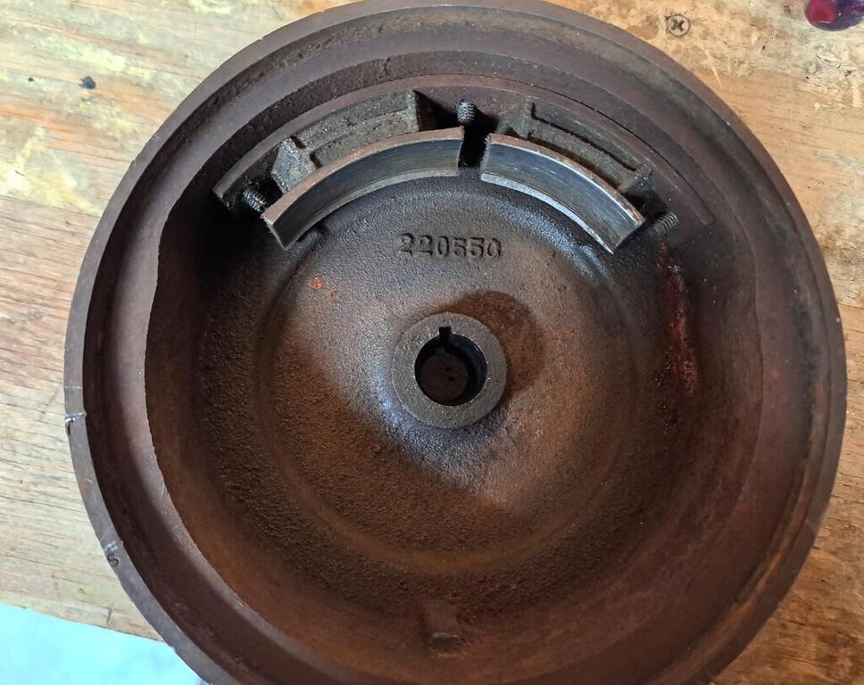

dmoore 1,042 #13 Posted February 24, 2025 At this point I am wondering if the flywheel magnets are still strong. I see they are removable. Share this post Link to post Share on other sites
dmoore 1,042 #14 Posted February 24, 2025 They have a ridge built up on outside perimeter like they are worn down but there's no contact so I'm not sure if they are supposed to look like this or? I can grab the plug lead and spin flywheel by hand and feel just a little tingle. Connect it to the plug and nothing. It's not building enough energy to jump the plug electrode. Share this post Link to post Share on other sites
